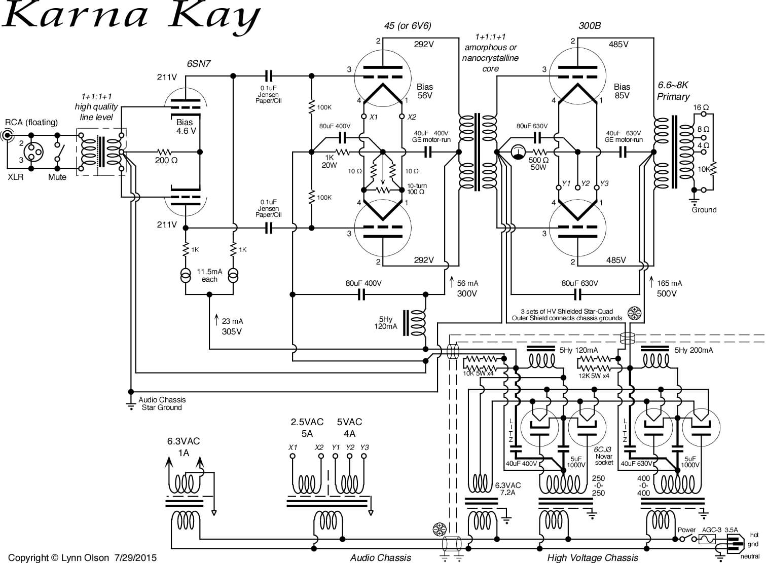

Here's a little bonus for all you triode fans ... the latest thoughts on the Karna Kay amplifier. Note resistor isolation between current-sources and 6SN7 plates and recommendation for amorphous or nanocrystalline IT transformer (Tribute, Monolith, etc.) which minimizes odd-order distortion in the zero-crossing region. The 6SN7, unlike the 5687/7119 family, has very low to unmeasurable odd-order distortion, so the IT also needs to have correspondingly low distortion.
Triode-connected 6V6's, or tubes in a similar family, bias up pretty similarly to 45's without the hassles with a filament supply. If the 6V6 version is chosen, the hum-balance circuit obviously moves to the 300B section. Operating points for the 6SN7 and 300B are borrowed from Thom's fabulous-sounding split-supply Reicherts.
It's not necessary to use damper-diodes for the 300V B+ section, a plain old 5U4 or 5AR4 would do just as well. The B+ for the paired 300B's needs all the current it can get, which is where the damper diodes come in, with 1 amp peak capability and very low switch-noise.
I think you will be pleased with the new input stage, Lynn. I just couldn't get lower distortion than with that topology.
