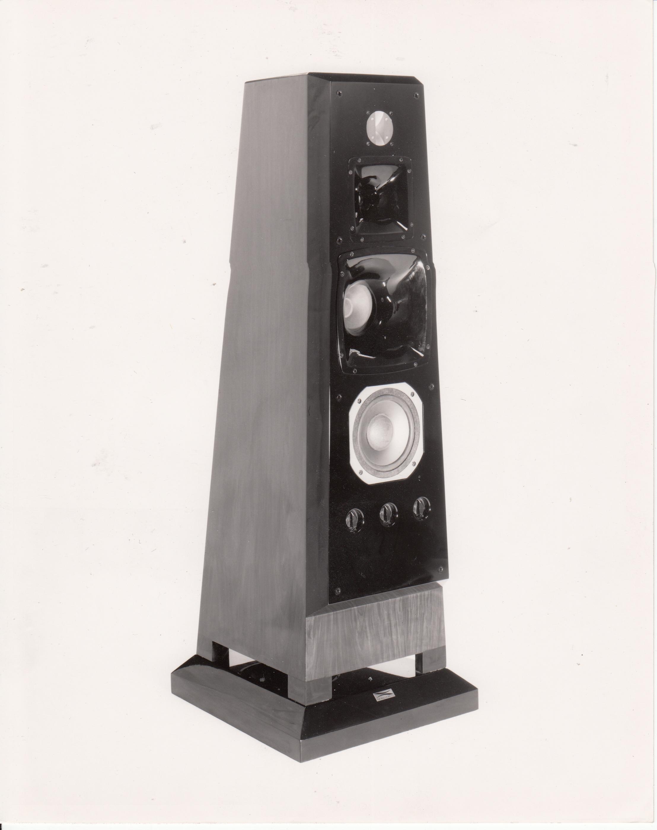

Marco,
I have had the advantage in the past that I was designing and making my own horns. While I did use multiple horns I made each with identical patterns, they were just larger in scale as I went down in frequency. The only horn that wasn't a match was the bass horns as they just get to big to do that. In my later designs as you see in my avatar I used the shortest horns I could with 1/4 wavelength mouth sizes that had very wide dispersion patterns. It was much easier to integrate each section and because I wasn't using a round mouth the distances from centers was less that way. The mouths never had any parallel surfaces, I think I was one of the first to make this happen and I used a round over at every junction so diffraction was minimized. If it wasn't for the strange enclosure shape and lack of marketing money I think you would have seen a lot of this done in the industry.
I just have a problem with trying to integrate round horns, it becomes impossible to have a limited spacing between centers and you have these crazy surfaces that each stacked horn has to reflect off of, you have to consider that the outside of these exposed horns are now the reflective surfaces that the next horn up in size is reflecting off of, not some smooth surface or controlled shape. It becomes a scattered mess of reflections.
Even the TAD ET-703 which has such incredible response bothered me in the sense that it was truly a diffraction lens, I considered at the time just removing that lens and making another horn that matched all the others I was using at the time but never took it that far. I was only using that little device from 10Khz up and I was using fast 4th order LR slopes where the integration wasn't as critical. It is always a choice of where any discontinuities were least audible.
I never use 2nd order filters myself, I just can never get past the impulse response you get when combining those devices, do you or don't you invert the phase, I could just never come to a satisfactory answer when trying to make that work.
The picture was of something of a more traditional shape, not as nice as my molded shapes but really something different. There were two bass driver, the one you see and another down firing. Each was in a separate enclosure build into the cabinet, totally isolated from each other with the larger device down firing. They both were ported enclosures with the lower unit tuned into the 25hz range. The top horn was the TAD ET 703 and the next horn down used a TAD 2001 driver. Below that was 6 1/2" cone driver on the horn, I just like the sound of a cone in the lower range over any compression driver. There was no time alignment so that would be the only thing I would change today, a dsp solution wasn't available at the time, passive time alignment was out and active time alignment was only used in PA at the time and was rather crude. The bottom driver shown was a custom made Radian 8" driver which was never made commercially for anyone else that I know of. It was a paper cone instead of the plastic cone they were selling at the time.
I'll be out the rest of the day. As you can see there are as many ways to do things as we can think up.
