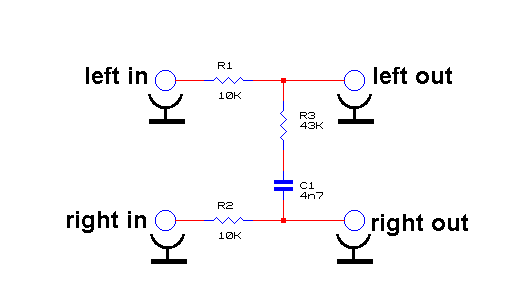

Perhaps not totally unproven. I've heard it said that a CD copied from an (analog) master tape sounds closer to the tape than a record recorded from the same tape.
The theory is that digital recording has too much channel separation. Too much of a good thing turns out not to be compatible with our hearing perception, it is argued. The analog tape, on the other hand, has channel crosstalk that is recorded in the CD version, as opposed to a digital recording chain to CD, which perserves separation.
Richard Brice promotes this theory in a Wireless World article way back in the 80s or 90s. Don't have that info, but he has a web site:
http://richardbrice.net/franci.htm
He used to market a product called Francinstien, of all things, but is no longer commercially available.
He gave me a schematic of a simple passive circuit to try out the effect, but I have not yet incorporated it in my preamp CD input. I have attached the schematic for anyone interested in trying it.
The commercial version added buffers, I believe.

I suspect the same - see
this post
I guess we all reinvent the wheel here, I for once wasn' t aware of Richard Brice.
BTW that kind of circuit is ubiquitous in the headphone department, headwize.com has a lot of crossfeed simulators and auralizers to that effect.

There used to be quite a few designs during that period. I have tried a few with relatively good success, and even built a few circuits for some friends at that time.
The channel separation of digital systems is 'unreal'. Think about it: Is it possible to hear something with your right ear while the level on the left ear is 96dB down? No , of course not.
I have one of these psycho-acoustic processing boxes, an SPL Tube Vitalizer The output stage is designed to reduce the channel separation to about 55dB while at the same time adding a tiny bit of stereo expansion. The net result is that the soundstage is wider, while at the same time the music is 'closer together' (sounds like a band and not a bunch of separate instruments).
I know that the usage of such a device is nothing short of heresy, but I'm with Joe Meek on this one: If it sounds right (for me) it is right (for me).
