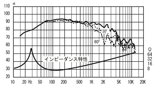

As for 15" drivers with well-behaved midrange, I have not seen any better than this:
(Fostex W400A-HR: http://www.fostex.jp/wp/wp-content/uploads/2014/08/w400ahr.pdf)
A tad expensive, yes, but it seems to be pretty much state-of-the-art in terms of design, doesn't it?

The main problem with using the 416 or other 15" driver near 1000hz is "beaming". The wavelength of 950hz is 14.21" wide. This is also the frequency where the ear is most sensitive. The change at that crossover point between the electrostat and a sealed 15' driver box will be a large compromise IMHO. You would need to have your electrostatic speaker go down to around 500hz or so to get a better sounding midrange. If your electrostatic speaker can't make it that low then I would use a pro 10" ( or pair) like Beyma, B&C, or other similar type to cover the critical midrange.
