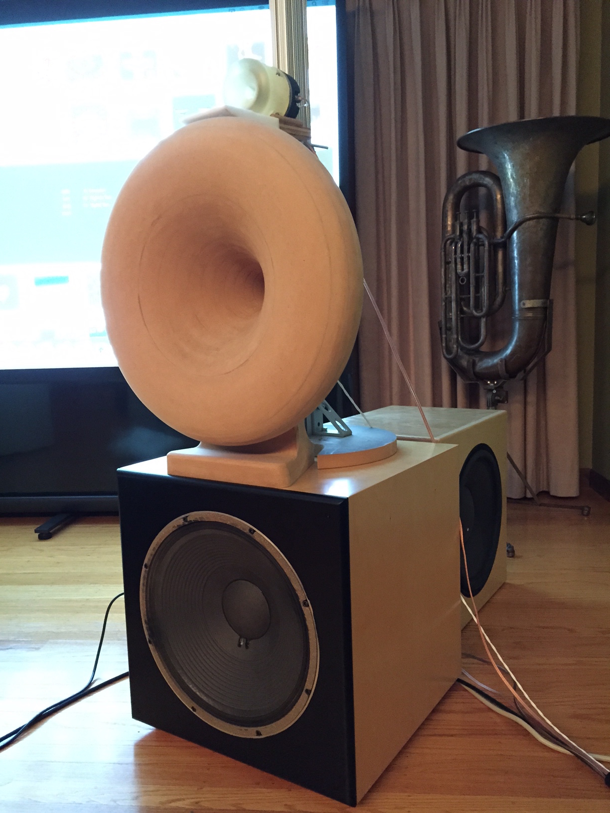

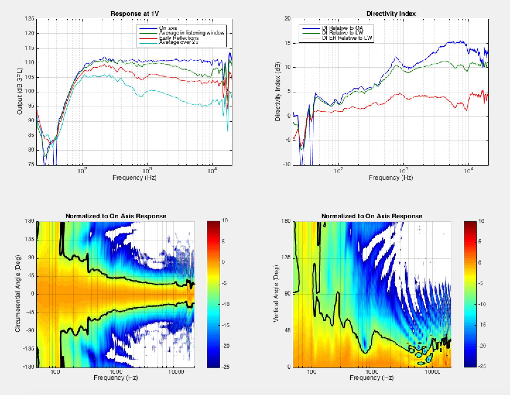

Since the system I'm building is somewhat similar to what's been talked about here, here's my latest incarnation. I added a super tweeter I designed based off a JBL 2402 to bring down the DI of the system above 10k (crossed at 9k). This worked pretty well despite the vertical polar response getting destroyed around crossover due to the large spacing and the tweeter's response not being too smooth above 10kHz. I don't really hear it going from sitting to standing though. Then I added a JBL 2225 in a sealed box between 80 and 800Hz, relegating my Sub1500 to 80Hz and down. This improved stored energy performance (measuring boinks ala Linkwitz) in the ~500hz - 800hz range where I was using the 2435 and LeCleac'h horn down towards the horn's flair frequency (380Hz). This was also pretty easy to hear - I had the same response and DI before and after this change and I was hearing a lot more detail in the low mids after the change. The response I posted is without the sub and before any room EQ was applied - I was just getting the system set up so it was easy to EQ. The max output of the system is actually 3dB higher than shown on the response plots - so about 114dB/1m for full scale output from my media server. It does this with essentially no power compression except in the sub at max output (like 1dB at max output).
There are still quite a few things to improve, but at the moment the single 15" sub is about 10dB low in output at 20Hz compared to the rest of the system even after including the 10dB of room gain I get below 40Hz. That's looking at distortion - if I look at power compression it's not quite as bad - I can probably about keep up with the highs before I see more than about 1dB of power compression. If I want to keep distortion limited output constant all the way down to 20hz, I could do 3 more sealed 15" subs or look at a corner horn. So far I haven't been noticing it holding things back too much.
I've also been thinking about adding a bigger LC horn for the low mids with a compression driver above the super tweeter. But at the moment I really like it - nice and punchy but well balanced, good detail, and not fatiguing unless I just have it cranked on something that's compressed. Now I need to finish the 2nd one so I can listen in stereo.

Nice work, John. I also noticed that other horn (tuba!) in the background. Is it playable?
Gary Dahl
Gary Dahl
Thanks.
Yep, the tuba still plays fine (other than probably needing some valve oil). I bought it to practice with in college but haven't had the time to keep up with it since.
