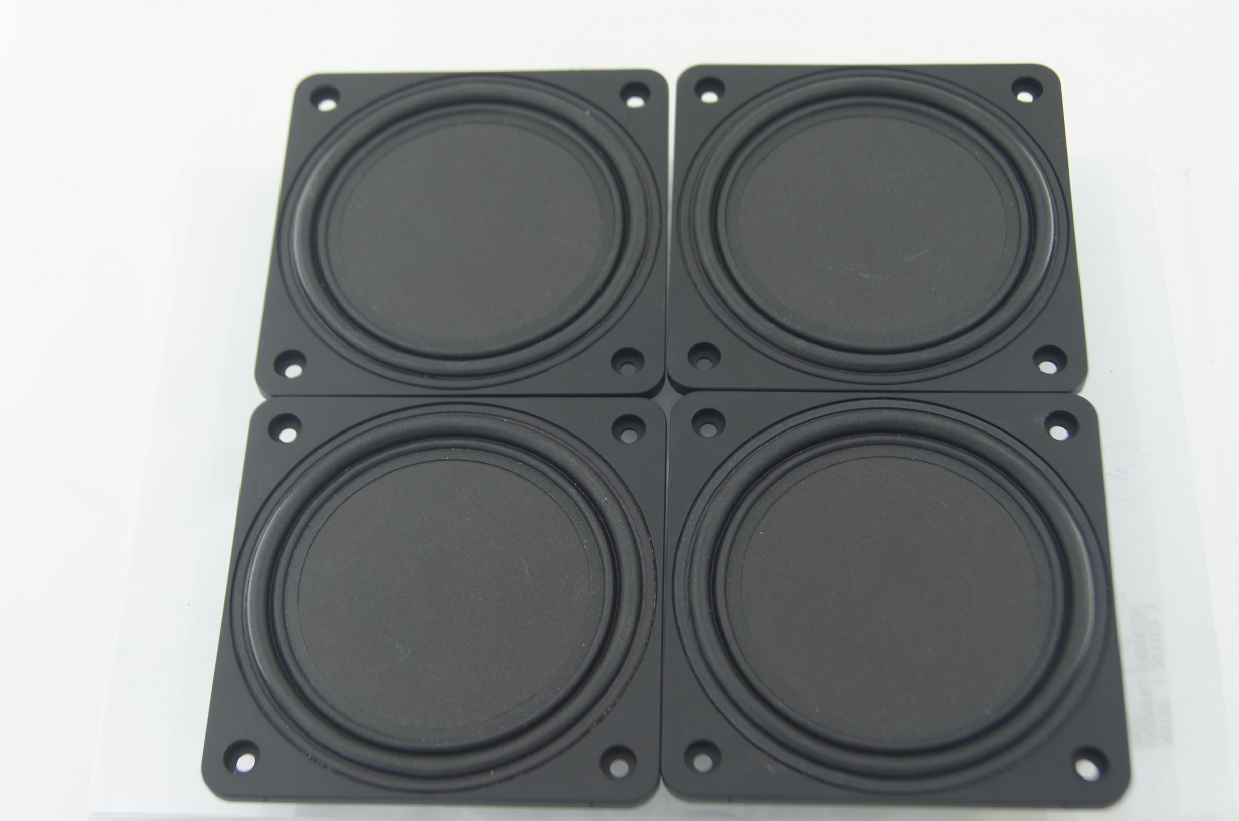

Do you have any unsmoothed polar plots to back up your claim of the BMR's "even" 150 degree dispersion?
I'd also like to see the polars of the 4x4 arrangement, that certainly would look "interesting"🙄.
Of course, even if the BMR does have even polar response, the wide dispersion claimed is the antithesis of Lynn's design using a HF horn that progressively narrows at high frequencies.

Lynn, please excuse what may appear as an OT ramble but there is some relevant info here too!
Art, with all due respect, you are way off bass...excuse the pun!
Your thoughts are similar to mine when I first looked at the BMR....
I could not understand how it could sound so good, if I judged it by its TS data and frequency response it was average to poor, that was over 4 years ago...
Now, after investigation into the patents and discussions with the original NXT designers, two years of R&D including a joint venture with a leading UK university, and the last year working directly with the Tymphany driver designers to implement my theories and licence my OEM design I believe I am on the right track.
A few key points are as follows:
(1) There is a gulf of difference between the controlled bending wave motion that is a design feature of a flat honeycomb BMR diaphragm operating within its power handling limits....Vs the uncontrolled bending (cone break up) of a cone or dome as it is pushed beyond its power handling....
(2) On axis frequency response graphs are almost irrelevant....Its how a driver fills a room that counts....A musical instrument does not "beam" or require wave guides or horns to reduce / limit its dispersion pattern....As you walk around a piano or Cello it does not sound different!
(3) Polar measurements are very good as they show the full off axis performance, but they still only show amplitude data....The most important aspect of a BMR (and push / pull drivers IMO) is how it performs in the time domain...Waterfall plots are the single most important measurement one can learn from, I believe they (and similar time domain measurements) hold the key of correlating subjective sound quality with objective measurements.
(4) Its far better to have a driver with a poor frequency response but correct time domain performance.
(5) Its perfectly acceptable (though not ideal) to have a poor on axis frequency response IF the off axis errors are similar ie an even power response. This allows loudspeaker designers the freedom to use DSP....Eq can only be used to fix the frequency response errors when they are even on and off axis!!
(Fab Filter etc are used in 90% of recording / mastering studios) it makes sense to utilise it at the loudspeaker design stage too.)
(6) On or In wall is the best place to locate loudspeakers...In one move this eliminates the most serious room / loudspeaker interface problems...Use the room boundaries / gain to your advantage instead of fighting the room reflections.
(7) Increase Sd and maximise sensitivity....Decrease driver diaphragm movement....Full height floor to ceiling line arrays are the best way to achieve this, 70% of floor to ceiling height is almost as good.
I believe that the above offers a lot of advantages over traditional designs. Also there may well be a way to combine an open baffle bass low midrange (similar to Lynn's design) with either a line array or panel of BMR's....Not sure as I am focusing on my own designs but it's food for thought?
I am waiting on my first production run of drivers, ETA November / December...As soon as I can get them built into the cabinets I will be commissioning a full suite of independent measurements carried out by a top professional. My aim is to have objective data that is beyond question ie accurate and not "cosmetically enhanced" as some manufacturers publish.
By the way, the photo of the 4 BMR's is just to show what they look like...They were sitting on a table not installed in a baffle!!
Hope the above is of interest.
All the best
Derek.
1) The BMR specs don't indicate any Xmax figure (only Xlim), so impossible to determine their linear operating range. Conventional drivers exhibit controlled (and uncontrolled) bending far below Xmax or Pmax.
2) Convenient to say when you have decided to use a driver with ragged frequency response 😉.
3) Correct, they show if the off axis response corresponds to the on axis response, if it does not, EQ can't correct the problem.
4) That's a subjective observation which I partially agree with, though I prefer both flat frequency response and good time domain performance.
5) "Perfectly acceptable" if correctable with EQ, which requires unit to unit consistency, presently not demonstrable with the BMRs.
6) Another subjective opinion I happen to agree with.
7) A full height line array has a destructive interference pattern in the near field, which extends far beyond the typical listening position in the high frequency range. You may prefer that sound (an interference pattern does not have correct time domain performance), others (like me) prefer the approach Lynn has taken with drivers and horns more closely approximating a point source.
Art
Bending mode ridge travel and Eq.
Hi Art,
Sorry but you are still not correct!
I don't want to ramble on ( applause from the crowd!) re the technical differences of the BMR as its completely OT, but suffice to say you are mistaken...If you imagine holding a flat paper cone and moving it a few mm in out in a push / pull or pistonic motion there is your cone / dome driver.
Now imagine holding the same flat paper cone and simply bending it in and out along its horizontal ( or vertical or any axis...) and note the difference....
In the first case the Vd ( volume displaced) by the push pull motion is X ( Sd times travel). Now in the second case only the "ridge" or axial line travels the peak " in / out" distance, the rest of the flat diaphragm covers less distance the closer it is relative to the surround (where your fingers are holding the cone in our imaginary example.
As you can imagine this throws out any conventional TS data re Xmax and Vd,
one reason modelling BMR's is so tricky... If you want to discuss any more on this PM me or Google around for the facts rather than assumptions based on TS data.
Back on topic as Eq is of relevance to all.
For the avoidance of doubt (your point 5 reply is ambiguous) and repeating my point 5, Eq can only correct frequency response errors when the driver has very good off axis performance ie almost perfect power response. In all other cases Eq does more harm than good. Its fine in the bass and low mids where its easy to achieve very broad off axis coverage, but it gets tougher as frequency rises. The BMR is very strong in this respect.

Derek,I don't want to ramble on ( applause from the crowd!) re the technical differences of the BMR as its completely OT, but suffice to say you are mistaken...If you imagine holding a flat paper cone and moving it a few mm in out in a push / pull or pistonic motion there is your cone / dome driver.
1)As you can imagine this throws out any conventional TS data re Xmax and Vd,
2)Eq can only correct frequency response errors when the driver has very good off axis performance ie almost perfect power response. In all other cases Eq does more harm than good.
Since Lynn likes the discussion, I'll continue it 🙂.
1) I appreciate your difficulties in modeling a BMR, but you could easily measure distortion to determine at what excursion vs. frequency the BMR goes beyond it's linear range of operation, giving an equivalent to the standard Xmax rating. Without that basic information, no way to estimate how many BMR it would take to be equivalent to a 15" driver.
2) I agree that one can only correct frequency response deviations when the off-axis response is the same, or quite similar to the on axis response. That said, there is no data I can find, or you have provided, that supports that a BMR's off axis response matches the on axis response.
EQ can be useful to correct frequency response variations (and also generally concurrently corrects phase deviation), but individual units must be identical in their frequency response deviations (both on and off axis) for the correction to work. You have not shown (demonstrated) any BMR response showing on and off axis response, though you have confirmed that their on axis response is ragged, as can be seen in the published response of various BMR drivers.
My experience in drivers showing ragged peaks and dips in response is that the raggedness is seldom the same unit to unit. If you can show (demonstrate with un-smoothed frequency response curves at say, 5 degree increments) that multiple BMR units have the same ragged response on and off axis, I would accept that the ragged response can be equalized, given EQ with enough filters.
It appears the CSS BMR85DD N4Y would require at least 8 filters, but without any off axis data, who knows how much collateral damage those filters would cause
