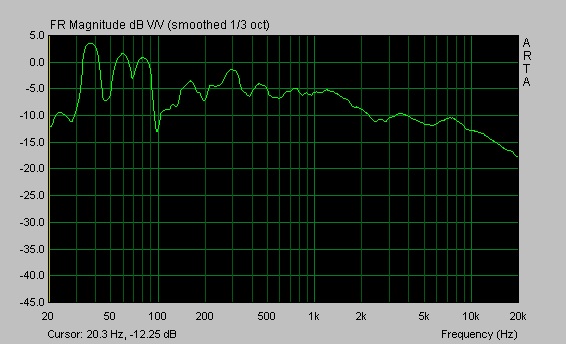

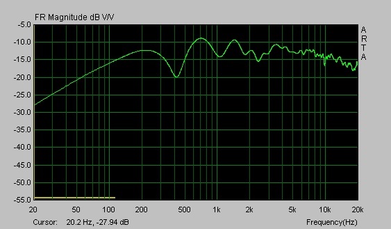

Well, let's have a look at of my current speaker system having a 10 in woofer crossing over to a 300 Hz Guigue Iwata horn at 600 Hz. The measurements were made in 2007 after the last minor update at the listening position. (I only measure afterwards).
The direct response on the listening axis (15°), first 2.5 ms of the impulse response: fairly flat to 12 kHz and showing a single (floor) reflection.
The first 48 ms: important for perceived coloration.

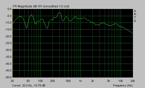

The total room spectra (1.4 sec):
Although the crossover frequency between the direct radiating woofer and the horn is at 600 Hz, the direct response and the total response are reasonaby flat up to 1.2 kHz. However the total response drops at 2.5 dB/oct instead of the required 1.5 dB/oct.
The speakers sound neutral when the direct response can be heard, but this is not the case when I am in my kitchen and the speakers are out of sight. In that case I hear that the total response drops too fast towards high frequencies.
Can this be changed?
Yes:less toe-in angle: listening axis at 25°, so a small slope is needed towards the high frequencies (e.g. Baxandall tone control) to keep a flat direct response and less slope in the total response. Lynn, this is certainly worth trying after you have finished your speakers, but you should not worry now. A change in toe-in should be accompanied by a change in tone control slope. My experience - also confirmed by my Japanese acquaintances - is that with less toe-in, the speakers need to be at a smaller angle viewed from the listening position. So this also means moving the speakers closer together when experimenting with toe-in. This also changes the distance to the side and front wall and thus the mid frequencies, which gave less good results in my room.
