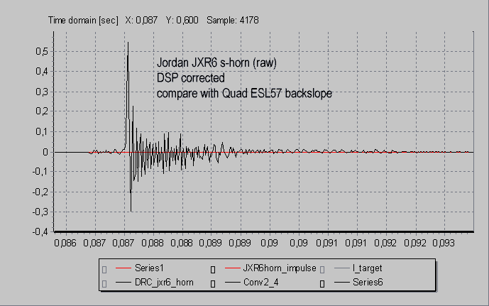

I remember the PowerPoint presentation where Dr. Geddes is presenting HOMs attenuation visible on impulse response tail. The effect is delicate.

If I understand right, we're dealing with a 3-dimensional multipath problem with a level-sensitive detector. Not that dissimilar to distortions experienced in long-distance transmission paths with NTSC and stereo-FM systems, where the subcarriers are badly degraded by multipath. We don't have the option of developing PAL and SECAM 😉 - we're stuck with the perceptual systems we were born with.
The distinction between the minimum-phase behaviour of reflections and non-minimum phase behaviour of diffraction is extremely significant, especially regarding the different ways they are perceived.
I should bring to the attention of the reader that distortions of this nature may be impossible to correct with DSP, since moving only a few inches at the listening position may have a completely different set of time dispersion distortions. This is not a minor point - a mis-aligned DSP "corrector" could greatly aggravate the existing time dispersion of a horn system.
Combine the severe HOM's of standard theater CD horns with almost univerally-used DSP, and it could be a real mess - in the time domain. The freq resp is more-or-less flat, but the time response in the first 2 mSec ain't gonna be pretty.
What's not shown is how the time response changes with microphone position. Any changes in time signature with spatial angle renders DSP correction counterproductive.
Why? When the DSP is misaligned, you get entirely new classes of time dispersion that don't exist in the original uncorrected speaker system. A misaligned DSP is a worst-of-all-worlds scenario - and if the DSP correction is only good for a extremely small listening area, it is worse than useless, it'll actually degrade the sound.
If HOM's are highly directional, it makes all but the most minimal high-frequency DSP correction undesirable. What's appalling is that CD-horn arrays + automatic DSP is the way pretty much all prosound is done these days, movie theaters included. No wonder I preferred the sound of old-school multicells with only the mildest of FR correction.
In his own quiet way, I think Earl has just pulled the rug out from the prosound world.
Lynn
Quite perceptive and quite correct. I have been trying to make this point over and over again, how DSPactually makes things worse in a real sound field NOT better, but no one, until now, seems to have gotten it.
There simply is no way to correct these aberations with anything but a diffraction free design. And when you hear such a design you will know what has been missing.
I don't usually make subjective claims and so I'll hedge this one with some real data, albeit NOT psychoacoustic.
My partner took my class in loudspeakers and he was struck by my knowledge of psychoacoustics NOT loudspeakers - he knew that I knew that stuff. He lives in Thailand (a NY'er) and flew here one week to talk to me about loudspeakers and to hear my system. Kenny is an ex-NY-recording-engineer and producer (he did Jaco Pastorius stuff), and he was a recording engineer and producer in Thailand for a number of years (anyone who has ever been to Bangkok knows why he stayed there. I wish I had known about Bangkok when I was young and single!!) He now designs and builds recording studios, nightclubs and concert halls in Asia. He has built some of the best recording studios on that side of the world. Kenny knows good sound.
After he heard my system he offered me a partnership in a new company in which he has dumped multiple 100,000's into. He has bet this kind of money on what he heard at my home. Say what you will he obviously thought that the sound was "pretty good". We are exstartic about the stuff that we are building as it is exceding all expectations.
You see, we use NO electronic processing at all, we do virtually everything acoustically. We designed out all diffraction and built several sub designs since the ESP (Enhanced Sound Perception)line with multiple staggered subs (another innovation) has everyone who hears it simply blown away.
It may be some time before we can import into the US (because its so expensive - like $1,000,000 just to get the first shipment in the door.) But all are welcome to Bangkok to hear the systems at our factory.
