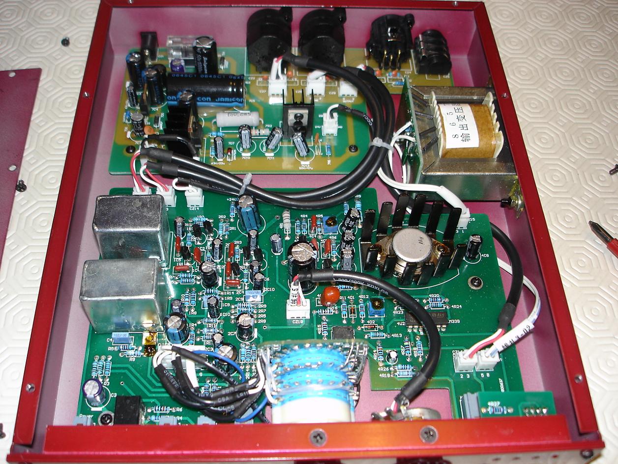

I listen to Spotify a lot, which I should try to avoid except they have so much new music that it is kind of addictive. I have owned a lot of different microphone amps and preamps, and the ones mostly based on opamps have been the least exciting to listen to. If that has had to do with design or the opamps is difficult to guess. I modified a microphone amp (Studio Projects VTB-1) once with better opamps and the sound became remarkably better. Now I use a red Golden Age Pre-73 microphone preamp, which is not based on opamps, and it sounds a lot better. A popular mod for the Pre-73 is instead to upgrade the transformer, to make it more similar to the original made by Rupert Neve that so many studios have used.
