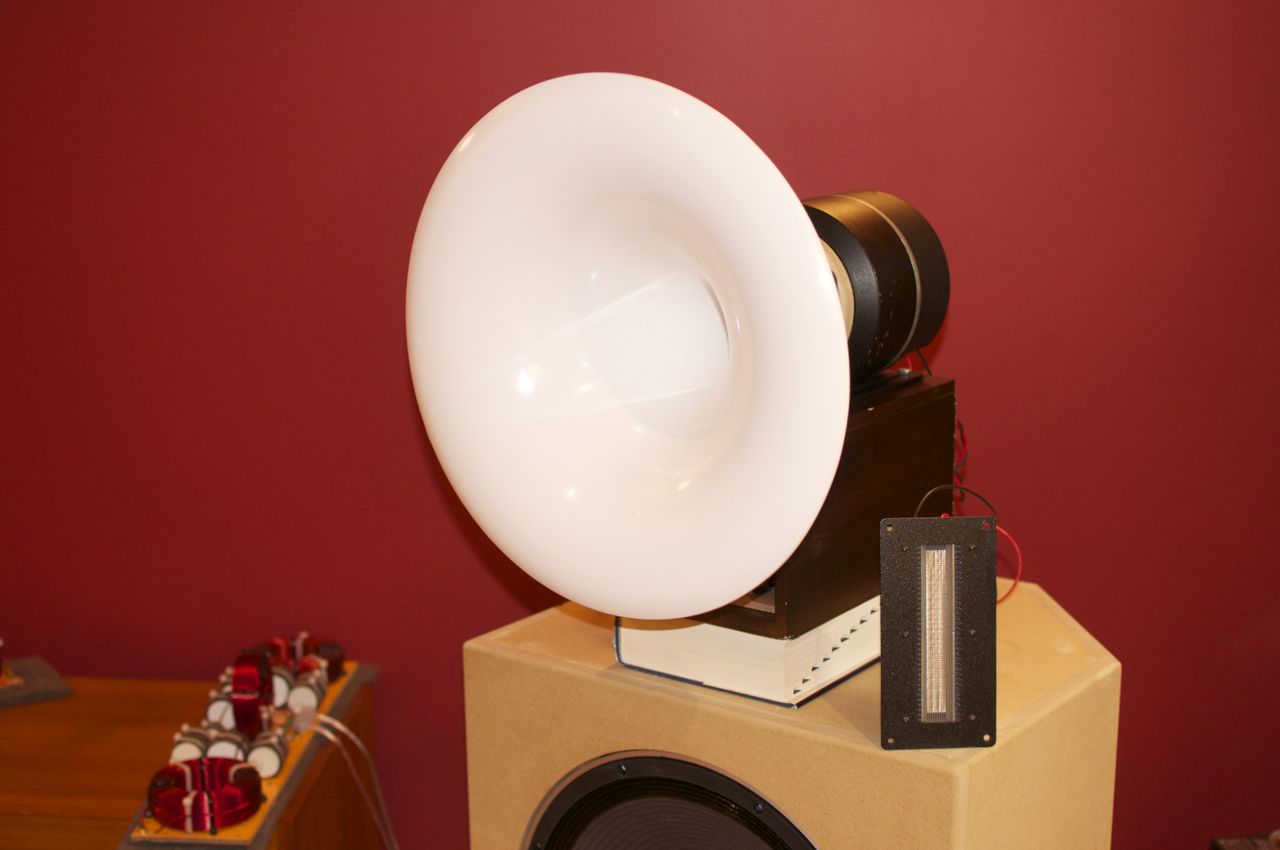

The speaker system is unchanged since post #10964, and is configured as follows:
1. RAAL Lazy ribbon, 2nd order high pass at ~8 kHz, 10-ohm tap of tweeter connected to -9.5 dB tap on Slagle autoformer.
2. Radian 745NEO/Be (16 ohm) driver, Azurahorn AH425, 3rd order high pass at ~700 Hz, connected to -17.5 dB tap on Slagle autoformer with 35-ohm swamping resistor.
3. GPA 416-8B Classic Series (alnico), 3 cu ft sealed enclosure, 3rd order low pass at ~700 Hz, Zobel circuit, -3 dB at 61 Hz, attenuation-band notch filter at about 1,500 Hz.
4. AE TD15H-4 plus two AE PR15-700 passive radiators (1 on each side of cabinet), separately powered by plate amp.

Hello,
I have one question regarding the crossover between 2. (horn mid) and 3. (woofer). You seem to use symmetrical 3rd order/3rd order slopes. So how do you deal with time alignment, if at all?
By looking at the picture you posted in a previous thread it looks as if in your speakers, like in virtually all Woofer + horn systems in fact, the acoustic centre of the woofer sits quite a bit closer to the listener than that of the compression driver.
It is my understanding that the common way to deal with this using passive crossovers is to increase the slope on the speaker unit (the woofer in this case) that sits closer. TAD and Rey Audio, for instance, use a 6th order low-pass on the Woofer coupled with a 2nd order on the Horn (the acoustic transfer function of the high-passed horn then transitions to a 6th order-plus below the horn's Fc, but that is another matter...).
Marco

Martin - Thank you for sharing.Yes, definitely worth the effort. Mine are finished too - actually my son's.
It really came together well at the end - I had a lot of doubts it ever would - but the jmlc cross over and autoformer brought it home for me. OK it's all subjective and I cant say I have measured it yet, but it was a good experience doing it over time with my son and really listening together. A good introduction to audio. On SE 300B amps it sounds magnificent. Thanks Lynn.
If you feel like experimenting… Try lifting your horns a few inches above the bass cabinet so that there is clearance below them. Listen and share.
The difference I hear when doing this is not subtle!
