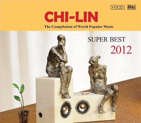

One material I would use if I wanted to keep box panel vibration to minimum would be mixture of stone power into epoxy. The Romance series done in collaboration with a local artist provided the cleanest sound of all the other enclosure material used with the same driver.
They make countertops out of that here IIRC 95% stone powder to 5% epoxy, it still seems quite resonant.
30 or so years ago someone in the lab decided that the perfect base for a high magnification microscope would be a 4" thick slab of granite on air bearings. It rang like a bell and ended up useless.
But wouldn't it ring at high frequencies and be easier to damp; especially with regard to its stiffness as skins in a CLD arrangement?
