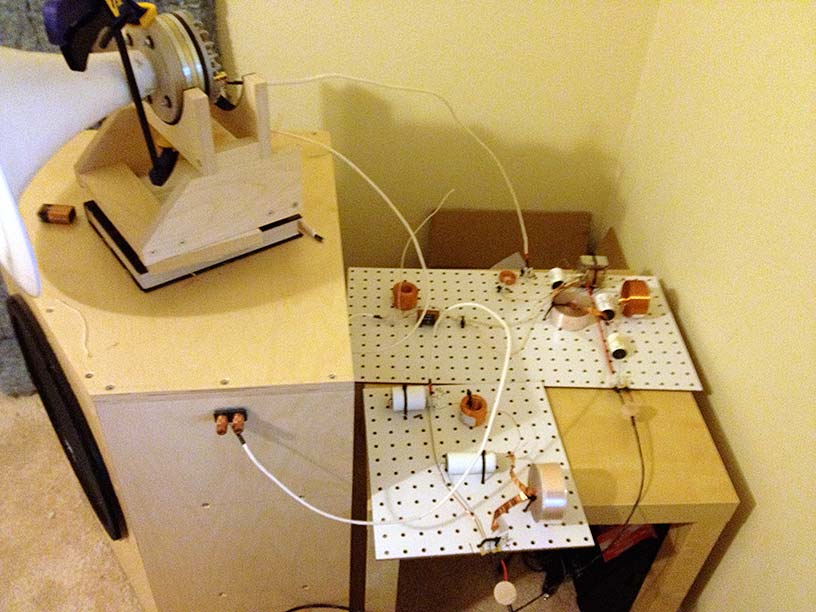

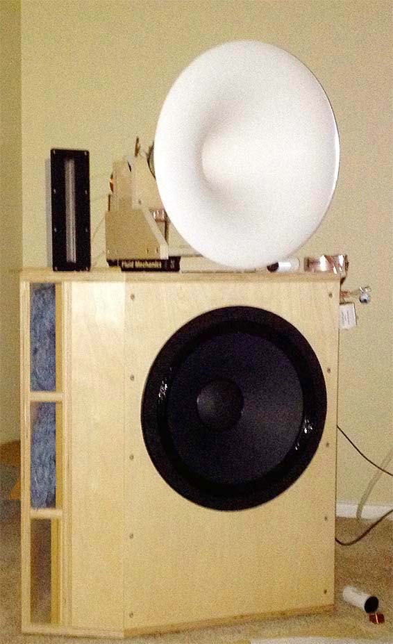

Here's a couple of photos of the first prototypes ... sorry about the quality, iPhone 4S with flash.
The next versions will have the resistive vent on the floor, but the slant-front will be retained. I'm considering a dual-woofer version where one woofer is closed-box, and the other is resistive-vent.
The crossover pix shows the MF/HF crossover at the top, and the LF crossover at the bottom. You can see the small metal-framed autoformer attenuator at the upper right, and some of the additional parts for the RAAL ribbon supertweeter at the upper left.

Thanks for the photos, Lynn, No need to apologize, a little grainy but well lit and clear.Here's a couple of photos of the first prototypes ... sorry about the quality, iPhone 4S with flash.

The first prototypes are at a friend's house in another city, about 800 miles from here. The measurements were made with unfamiliar test gear I wasn't sure about, but they gave an overall impression of impulse response and frequency response. The flatness goal is met, and impulse decay is less than 0.5 mSec, both comparable to the Ariel, and maybe a little better.
The subjective balance is very close to the Ariel, with greater dynamic capability. Imaging is a little different, somewhat deeper (subjective depth 50 feet), and also coming further into the room (to the listener's knees on some recordings). The slot vent, which is located on the sides of the prototype cabinets, will be re-located to the floor when I build my cabinets.
Next step: my cabinets. I am leaning towards a dual-woofer configuration, using a pair of GPA 416 Alnico's. Not decided on the merits of a vertical or horizontal array of drivers; the floor image has to be part of the overall response and polar characteristic. There's a possibility of a short bass horn cutting off at 200 Hz combined with a direct-radiator woofer below that (with active crossover and separate amplification).
The rough measurements made of the first prototypes indicated the Qts of the 416 is much lower (perhaps as low as 0.21) than the official GPA specs, and efficiency is higher, in the 98 to 99 dB/meter range. There is a set of measurements here that show a lot of variation for the Altec 416 over the years, when you look at Qts, moving mass, and efficiency. GPA is currently specifying the moving mass of both the 416 and 515 as 71 grams, which is similar to the majority of the drivers measured here. I am looking forward to what Gary Dahl measures on his pair of new-production 416 Alnico's.
