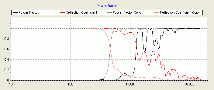

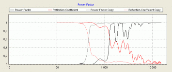

The simulation below, created by Bjorn Kolbrek, shows a comparison of power factor for the AH425 versus a smoothed conical. The thin black trace is power radiated out the horn, and the thin red trace is power reflected back to the diaphragm. The heavier black and red traces show the power factors for a same-size conical horn with a smoothly radiused throat transition region. The need for in-band equalization is apparent.
Soongsc, this is why I recommended in a previous post to not combine two different types of horn; they do different things, and are optimized for different sets of parameters. If you combine them, the LeCleac'h will lose the PF optimization, and the OSWG will lose the desired directivity pattern. I now suspect it's not possible to have both qualities at the same time. If you want little or no EQ, that points in the LeCleac'h direction. If in-band EQ is not a problem for you, then OSWG is an option. Dr. Geddes' suggestion to measure over a wide array of points when designing the OSWG equalization is exactly what you should do if you choose an OSWG.
The physical AH425 is pretty close to Bjorn's simulations, and meets the goal of uniform diaphragm loading versus frequency (an acoustic transformer with flat on-axis response). The rest is up to the compression driver.
