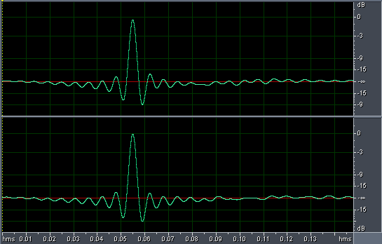

Here is response of sealed woofer before equalization:
Here is response of dipole woofer, woofer mounted in 'U' frame before equalization:
Here is response of sealed woofer stacked on top of 'U' frame woofer before equalization:
The stacked system forms Cardioid pattern.
Here is sealed woofer response after equalization:
Here is 'U' frame woofer response after equalization:
Here is response of stacked Cardioid response after equalization:
This is impulse response of monopole (top track) and 'U' frame before equalization:
And these are impulse responses after equalization:
Sweeps employed in measurements were 26V rms.
Better impulse response behavior of drivers doing what they are suppose to be doing is poor criteria for comparison. Likewise, efficiency is poor criteria of comparison.
