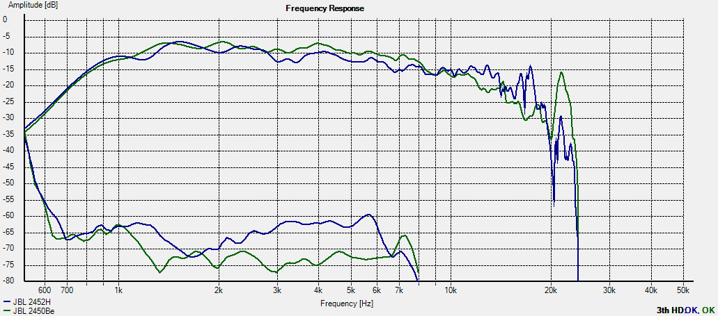

I already posted this, but here is a comparison between the Be and JBL ribbed Ti :
325791d1358907980-truextent-beryllium-replacement-diaphragms-3195202452hvs2450bedisto.png
That is a net 3dB sensitivity gain in midband, and a very smooth extension in the top end, without using spurious resonances from the surrounds.
3rd distortion is also a lot lower, but I cannot guaranty it does not come from the driver itself (the frequency response *is*identical between the two drivers when the same diaphragm is used though).
Now to the ear, the gain is notable even in the <10kHz range (made the test with a low pass).
