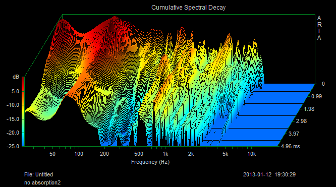

I realize there are several other things going on, but does this measurement not indicate at least some of the effect? It is a 1cm nearfield of a woofer (measured out on the cone, not in the center) in a large cabinet, with absorptive material being added.
Its a rough indication, but there are several things going on. And the issue isn't "is there?" of course there is, the issue is "how much?" and is it a significant audible effect.
