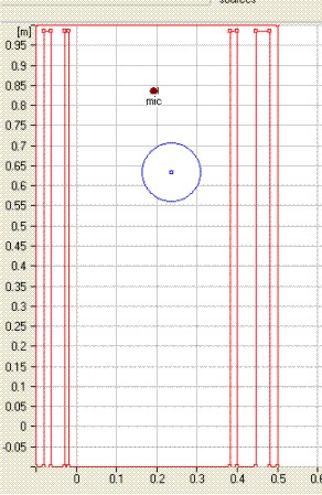

Going back to the issue of baffle shape. I'm not of the "I don't care how ugly it looks, just listen" persuasion. If it goes in my living room it has to be aestheticaly acceptable, I'm thinking SF Stradivari is a good thing here. It would be a challenge to do that with the aircraft rudders IMHO, I won't be going down that route. I'm sorry Lynn!
Your idea of acoustically softening the edge seems to me an excellent thing to aim for. I've spent a little time with Edge trying to defeat those aberations in the response inevitably caused by the finite size of the baffle.
It seems to me that hard edges equals significant lumps somewhere no matter what you do. Earlier on in the thread you mentioned acoustically "softening" the edge with hole patterns to reduce ripple,
Are my DIY skills up to drilling six hundred 1/4" holes around the edges? with no mistakes?....moving swiftly on.
It ocurred to me that ignoring what happens in the less critical vertical plane, using vertcal slots might actually be practical. Unfortunately it looks like Edge won't go round corners so I can't simulate it, any thoughts?

BudP said:Simon,
Come over to my thread on EnABL and Mamboni and learn how to minimize those edge reflections and diffractions to the point that you can not hear them, at all.
I will take you up on your invitation Bud, but I dont think EnABL is going to tackle the step caused by the back wave interfering with the front wave- this is fundamental to the operating range of an open baffle.
My thinking was to acoustically fudge the edge of the baffle so the front/back interfence is spread over a wider range and thus has a less strong acoustic signature.
Simon
Simon
