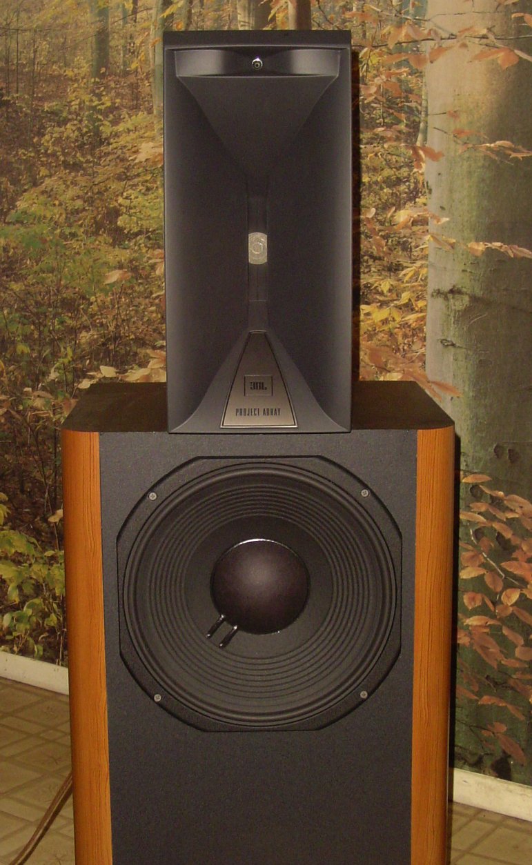

I think modern JBL horns actually narrow the throat near the compression driver to intentionally load it more. I am referring to the Everest versions(home use), but doing so only using here-say, as I do not own one.
They are modernized Bi Radials and have a narrower throat at the transition. You can see the difraction slot as in the original 2343/2344. The photo is of an Array Horn just turn it on it's side.

Hello Buzzforb
Rob🙂
There it is. Couple fellas on audio heritage did pretty good job o cloingthat baby. Asked for plans multiple times, but no response. Also beautiful dd6600 Everest there as well. I don't thin Gedlee is speaking anything but the truth about his products and research. Beautiful and hard earned information. They probably sound wonderfully. I am just not in the camp that says this horn or that waveguide is superior because of X. It simply leaves out the most important pat of the equation. The listener. Which is an individual with individual taste.
