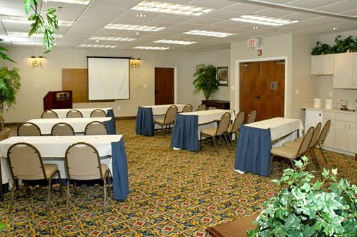

It was the SH-50. Typical medium size hotel meeting room. Horns were at one end, spread wide nearer the side walls than the center. One about 3 feet off the ground, the other about 4 feet. Pointed in maybe 30-40 degrees. In the photo posted below you see the table just to the right of the screen down front. One horn was at its far right corner, the other in the same position on the left side of the room. The CBTs were set up just inside (toward center) of that.
Room is 25 feet wide, 38 feet long (about 7.6x11.5 m) . I was about 25 feet back, centered. See below. If I can get photos of the setup, I'll post.
