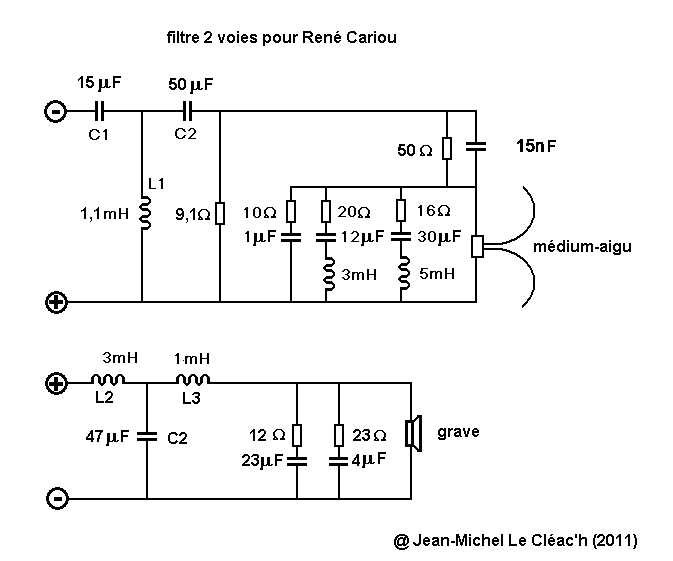

I recently re-coned some old PM2A Lowthers of mine with the new style cones, mounted them on 200Hz Le Cleac'h horns with no cross over, and was surprised at how relaxed and enjoyable things became. I have been listening and trying stuff with 420Hz horns and compression drivers (JA661B) these last four years, and enjoyed the music, but suspect probably I never got it right regards the cross over. Positioning is easy - fully agree on the apex should be just in front of the listening position. You get to know the right angle just by looking at the horns. I have had Vitavox 15" K15/40 bass drivers mounted in 1.5m 50Hz horns during all this period. It is not too hard to get a reasonable flat response to about 70 or 80Hz. The image and precision is all there, not holographic, but special. But as I type, the Lowthers are making music, rich and seamless. (playing Patsy Cline). I know it is a case of making everything sound good regardless, with somewhat overblown lower mids, (I just let the bass horn go on up to 400hz or so with a 12dB LP). But it plays vinyl just oh so well. http://www.lencoheaven.net/forum/index.php?topic=9746.0
I guess it was all under better control with a digital cross over (dbx driverack) and multi amps but but I just like the raw sound of CL 12dB cross overs and a single amp better. So hoping for some help here on how to make a nice passive cross over with all the incomprehensible stuff taken care of in good cook book tradition. Somehow I know this is not going to happen 🙂. I am married to my bass horns but designing cross overs to suit them rgds phase I suppose is asking a lot. The upper end response roll off is a confusing thing.
I took care of level matching for the compression drivers by winding speaker level transformers on Nickel cores, and that goes a long way. Things got better. I hope to keep cap sizes down by doing it upstream of the above.
I also have project coming along for 160hz horns on LM555W drivers, with the idea to get the rich Lowther low cross over sound combined with compression driver precision.

Hello Martin,
If you could send me both :
in pir format :
- impulse response obtained using Arta of the bass horn
- impulse response obtained using Arta of horn loading the Lowther
in lim format:
- impedance curve file of the bass-horn loaded loudspeaker
- impedance curve file for the horn loading the Lowther
Better to have the microphone in fixed common position when measuring the IR of the bass loudspeaker and the lowther.
Then using my own Matlab code I'll be able to calculate and simulate for you a crossover with equalization of impedance of the loudspeaker.
As an example here a crossover I designed for a friend :
Best regards from Paris, France
Jean-Michel Le Cléac'h
Hi Jean-Michel, That is very kind of you, thank you. Was not expecting such a positive response, and so fast. I have just begun my 3 month Long Service leave (no nice of the government here in Australia) so if my wife permits, I will work on this and come back with the required data.
very best regards from Perth, with Spring just beginning and flowers coming out,
martin
