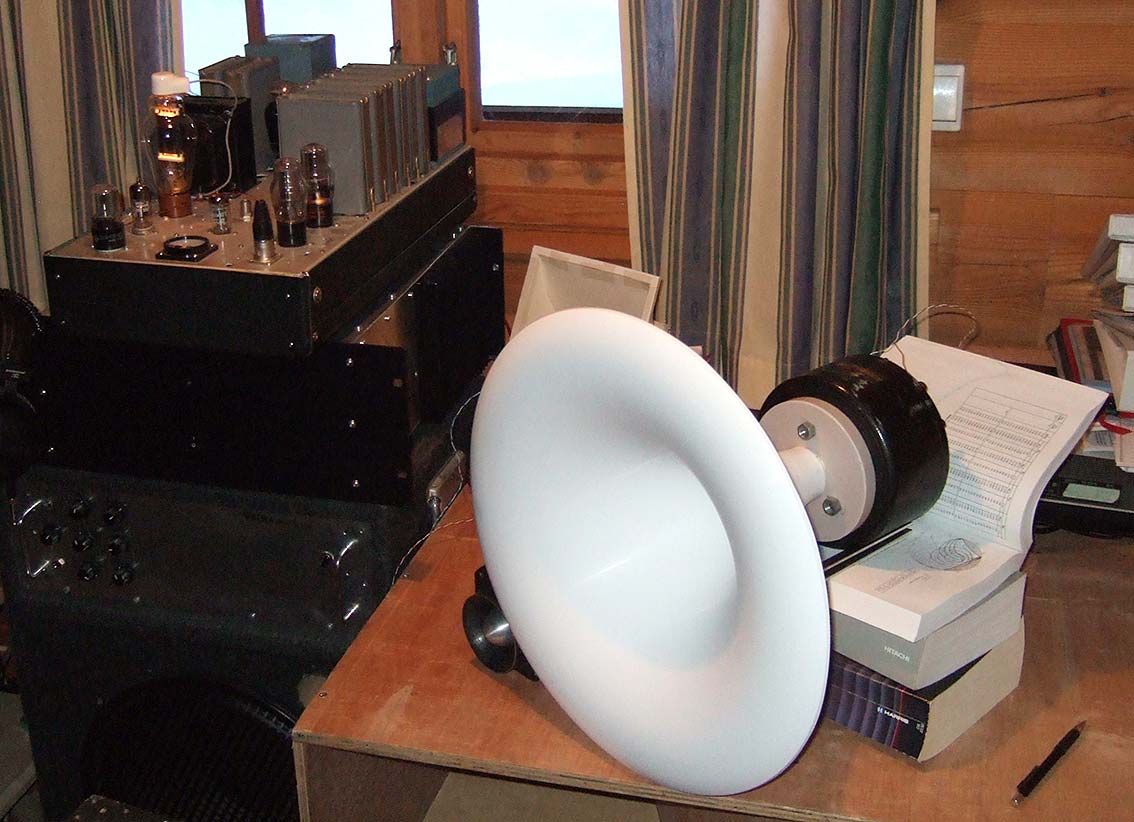

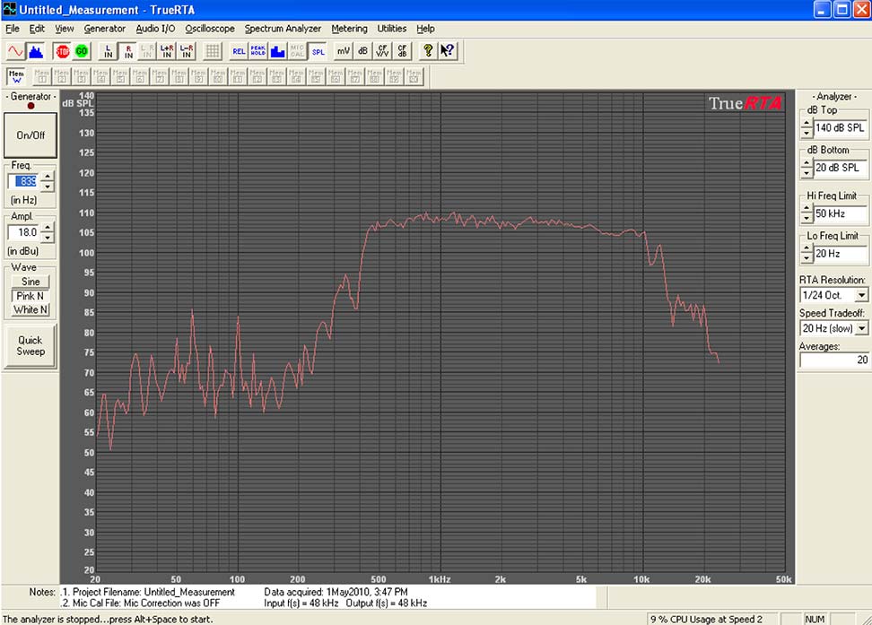

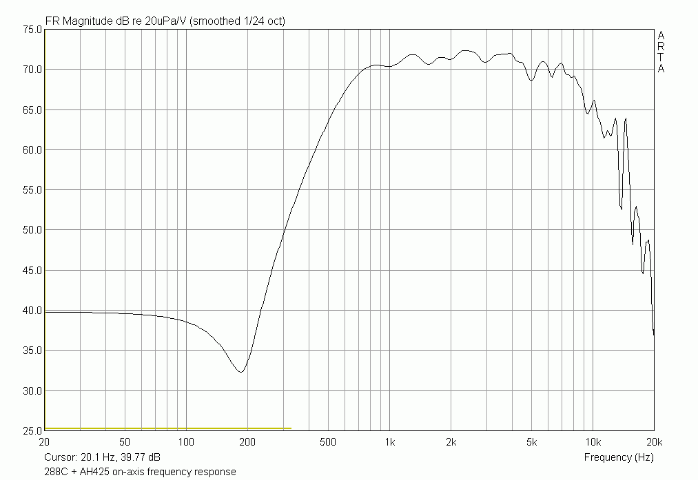

Here are the first measurements of the AH425 and vintage Altec 288C, made by Bjorn Kolbrek the day he received them from Australia (note snow outside the window - Bjorn lives in Norway). Some of the small ripples are the result of where the horn is sitting; once the AH425 is mounted in free air - even 2 or 3 inches of separation from the bass cabinet gives a measurable and audible improvement.
The third picture is Martin Seddon's measurement of a Yamaha JA6681B compression driver on the AH425 at 1 meter. The Yamaha may have a slight mismatch of exit angle for the AH425, which is optimized for the 8-degree exit angle of the Altec/GPA 288.
The measurements of the Radian 745Neo are even flatter - more like a straight line up to about 12 kHz. The exit angle of the Radian 745Neo is 4 degrees, while the AH425 is 8 degrees, but a mismatch that small appears to be benign.
As far as I can tell, it doesn't look like in-band EQ is necessary, or desirable. They certainly sound flat, even on pink-noise. Listening to a large-format compression driver on a horn this flat is an unusual experience; you have the horn dynamics, but none of the FR in-your-face quality. For lack of a better description, it sounds like a big electrostat.
Since the peaks and dips of the two measurements don't fall in the same places, I'm guessing they are the result of the compression driver itself and/or small measurement artifacts.

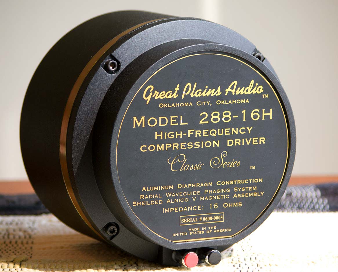

The Great Plains Audio 288-16H Classic Series combines the radial phase plug with an Alnico magnet, a combination that was originally available from Altec for about a year before they switched to a ceramic magnet (while retaining the radial phase plug). Bjorn's 288C's (with Alnico magnets) use the traditional machined-aluminum circumferential phase plug, so I'd expect some differences in the frequency response between the two.
I have not measured the GPA 288-16H, but I expect it will also be very, very good, thanks to the Alnico magnet and the radial phase plug.
