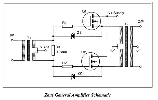

Good website. Interesting that Susan was working on the Zeus at the same time I was working on the Amity amplifier, and had access to the same test gear (my Tektronix pals have superb HP and Tek instrumentation). Back when I was using the Amity amplifier, the transformer-coupled solid-state Rowland linestage was one of the very few preamps that could pass a direct-bypass test; most of the solid-state preamps added a layer of grit-n-grain and a metallic-spunding brightness, and the many (but not all) of the tube preamps were mushy and dull-sounding.
Complementary AB Mosfet common source
Thanks Lynn. Well, Nelson's Class A MOSFET amps take the output from the drains. Per Susan, drains are a bad place from which to take output because 1) gain is involved and transistor gain colors sound, and 2) the drain capacitance is large (amplified by Miller) and non-linear if the voltage swings are large (which adds a kind of "jitter" so to speak).
As part of my studies in the eighties I was looking at MOSFET complementary common source amplifiers - in class AB - to improve the efficiency of the amplifiers by dropping the rail voltage by the 12V of gate voltage.
Suffice to say that it was a very pointed lesson in the limitations of feedback, small signal linear models and even the Spice models we had then (30 years ago). The non-linear capacitances around turn off made a mess of any attempt at stability.

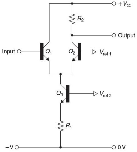

Now never mind discussion of harmonic distortion artefacts and Class A or A/B, what leaps out at me is the evidently superb common-mode rejection from those expensive centre-tapped transformers. That along with whatever output impedance it has must define it. For those who are unfamiliar, Common-mode is noise picked up from the earth rail. Earth is in fact a vague concept, it is better to think of it as a reference voltage. You must then ask yourself what reference the output signal is relative to. Sometimes it is the power rail, sometimes it is the conventional earth.

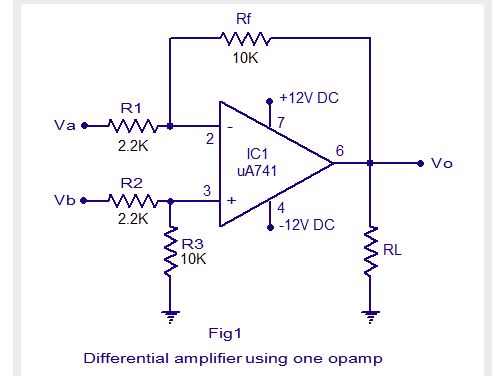

Common-mode rejection is a huge topic, made worse by the need for volume controls and circuit input/output protection. For interest I include a Balanced Differential amplifier circuit which is happy as long as both arms are symmetrical reactively and driven by zero source impedance.

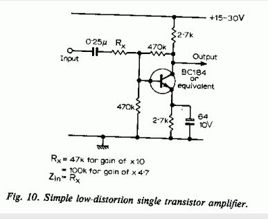

You also ask yourself whether an op-amp circuit driven by a long tailed pair is going to be better or worse than one of John Linsley-Hood's simple little one transistor Class A line amps. I know which I'd soonest have. JLH. :D

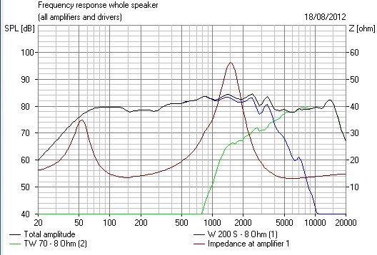

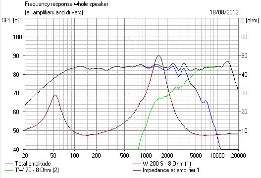

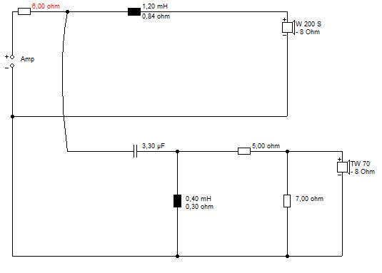

On a rare foray into the Solid State section here, we had a look at Mark Houston's DIY Class-A 2SK1058 MOSFET Amplifier.
Quite a valve-like 8 ohm output impedance and Class A current drive via Mosfet with a mere 5W available. Nelson Pass would look for something more special in output devices, but it's the efficient loudspeaker and tonal response that needs some thought with this sort of amplifier. As thoglette remarks, some speakers like the low inductance Fostex full range can lose it a bit with complex music.
Enter the WLM La Scala again. I find this speaker fascinating. 2.2mH inductance Visaton W200S 8" bass and of all things, a Visaton TW-70 CONE tweeter. Almost a relic of the valve driven sixties.
The only filter I could get working properly was a simple one, quite Robin Marshall in fact. I used the old trick of adding a 6 ohm resistor to estimate the difference when driven by a valve amp. The bass loading that was best and least affected with either type of amp (Solid State or Valve respectively in the diagrams) was stuffed port aka aperiodic, here with 30 litres box. I suppose it is possible to use Zobels and small bass coils to get the impedance flatter so it is tonally similar with all amps, but I hope you can see how it works anyway. :)

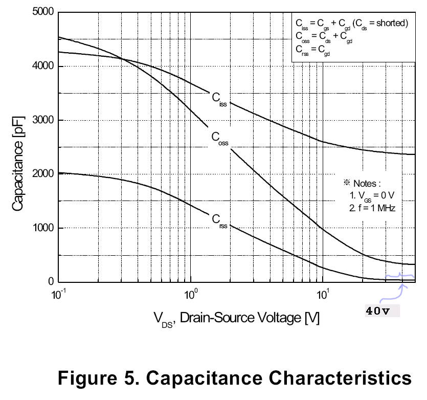

For anyone interested in a PP source follower power stage, including Lynn's suggested hybrid, here are some interesting graphs.

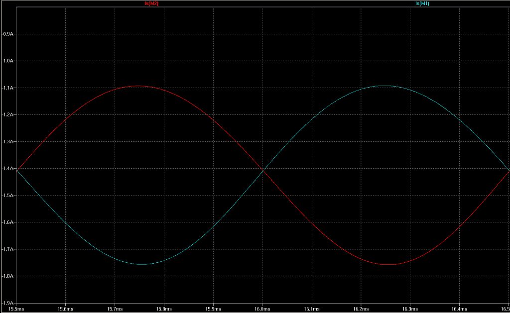

First the Current through the Mosfets in my hot-rodded version of Susan's amp. Shown are the push and pull Mosfet currents with the output transformer configured 4:1 delivering 5.5v peak into 4 ohms. This is close to 3.8 Watts which is much louder than needed for the Beyond Ariel speaker, I think.
The currents swing from around 1.1 to 1.75 amps.
Next is the capacitance curve for the Fairchild FQA34N20 Mosfet. To address the non-linearity of MOSFET capacitance, it is desireable to pick a part that has nearly non-changing capacitance in the operating region. Note the bottom right of the graph where I have annotated the 40v bias point for the amplifier. The controlling capacitance for this follower topology is CRSS (reverse transfer capacitance). CRSS is found in the lowest line in the graph and is specified as 55pf typical, which is where I operate it. Notice how this capacitance is effectively flat over the entire range, which range is +/- 11volts about the 40v operating point. The +/- 11 volts are need to provide the 5.5 volts at the output side of the OPT in this example, the condition for the current waveforms of the first graph.
This Fairchild part if effectively flat for a range that is double that, +/- 22v (11v peaks at output). Even +/- 30volts isn't bad (15v peaks output).
How loud are a pair of Beyond Ariel speakers at two meters with +/- 15volt peaks at the terminals?
The area to avoid on the second graph is below 10v. Note the Y-axis is linear.
