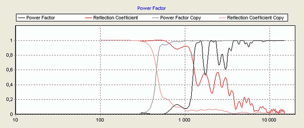

Here's a simulation that Bjorn Kolbrek did that compares the AH425 versus a conical. It shows the resistive versus reflected energy as seen from the compression driver diaphragm. Like a radio antenna, an ideal horn sends all its power out the device and into the environment, reflecting nothing back to the source. Any power reflected back to the source is wasted, and worse, creates a reflection off the rigid diaphragm, creating ripples in the time and frequency domains.
The thin black trace is the resistive part of the AH425, and the thin red trace is the reflected energy (as a percentage). The transition is around 500 Hz, as you would expect. The curves are telling us that the horn ceases to work below the cutoff frequency. Above 700 Hz, more than 90% of the energy goes into the horn, and less than 10% is reflected. That was one of the key design goals of the AH425 project, and that goal is reflected in the real-world measurements of the AH425.
The heavy black trace is the resistive part of a conical horn, and heavy red trace is the reflected energy. Note the uneven diaphragm loading versus frequency. As a result of diffraction in the throat, the horn doesn't present a resistive load to the diaphragm until you get to frequencies above 3~4 kHz.

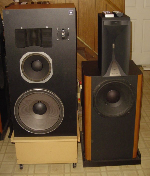

Speaker showed is early Kevin Brooks creation. I think around 12-15 Cu. ft , originaly with Tad 1602 wofers and 260hz tractrix horn in the middle with Tad TD4001. Now, I have Tad 4001 for a few years already and know that 4001 + relatively small tractrix horn =headache .It just doesn't work. The cab built in Tannoy tradition with Tannoy grill cloth begs for 15" Tannoy but those are fetching obscene amount of money. I figured out that small Tannoy 10" in 2cuft closed horn compartment with biamped HE woofers would get pretty close if not better than single 15" gold. If not , a single 416 or 515B would do nicely in that big cab (although it would probably be a waste to cross 515B at 70-100Hz. I have lots of ideas about that cabs , also with horn arrays fitted . Sorry for OT post just the remark about big MTM not sounding natural caught my attention.

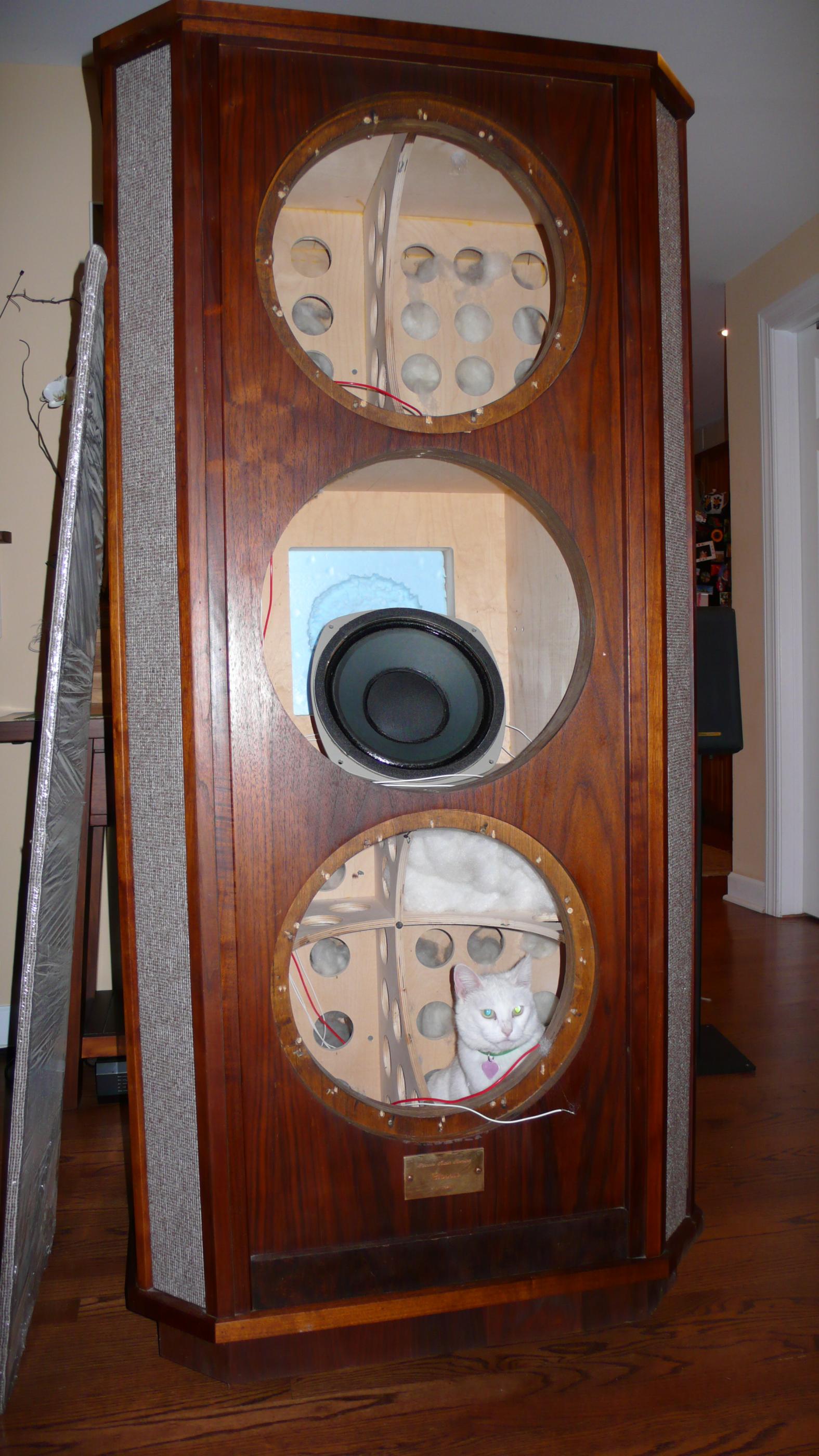

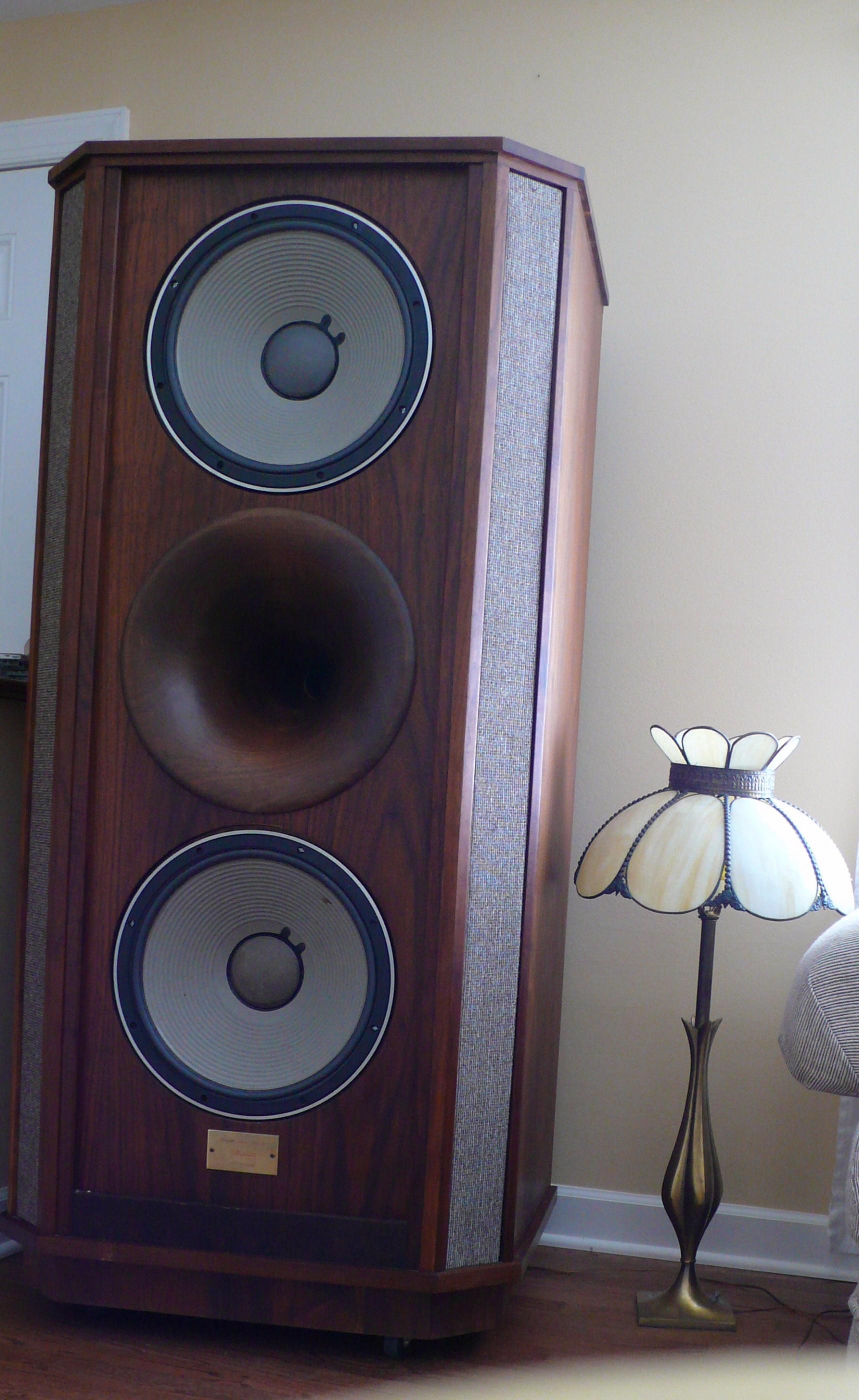

The Tannoy concept seem good at first sight. but if you consider the outer cone moving in relation to the horn lip, it is not difficult to figure out there is going to be something sounding funny.I tried for many years to get Tannoy drivers on an OEM basis and the answer was always no. It's not easy getting them for replacement purposes; you have to prove to the factory you already have a dead Tannoy before they will cut loose a replacement driver. They are dead set against an OEM market developing as far as I could tell. Which is unfortunate, because the Tannoy really is a unique coaxial driver with a very good integral horn assembly.
