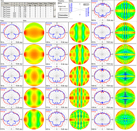

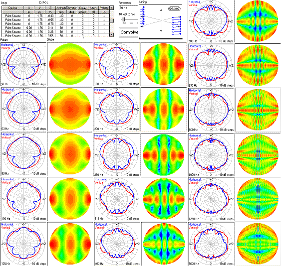

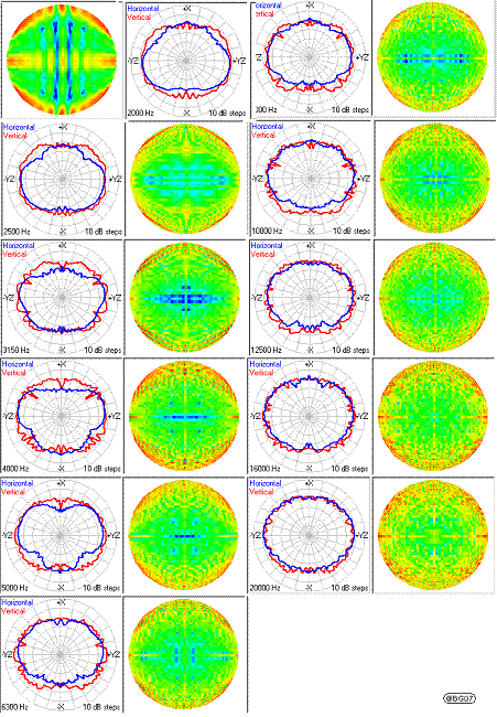

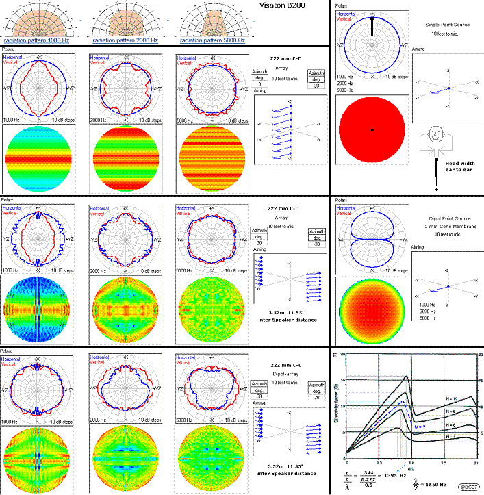

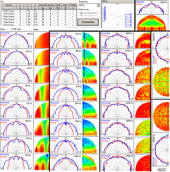

Salas:
I agree most arrays I heard are of bad design and have built in low performance dispersion characteristics from the beginning but there are also examples of array deigns that mediates a stunning impression almost where ever they are placed….
Below in my opinion, is an example link to a bad idea, using the Visaton B200 in an 8-driver bipole array trying to cover the whole spectra...
My opinion is that this array should only be used at max to 700 Hz covering the upper bass - middle midrange and if 12 dB LP filters are used or when the upper midrange (< 1.3 kHz) must be included, at least 24 dB LP filters are necessary.
Se my polar plots that show the B200 behaviour below 1250 Hz is rather accurately described with point sources within about + - 15 degrees azimuth ignoring the real effects from the baffle width/depth/step/diffraction that have to be estimated separately.

Hi
bjorno, nice simulation. Can you do some additional explanations what we can see there?
Greetings
Michael
Greetings
Michael
mige0 said:bjorno, nice simulation. Can you do some additional explanations what we can see there?
Even just pictures large enuff to read the captions would be helpful... there is so much data it is hard to interpret when you don't know what you are looking at.
dave
Greetings
Michael
I agree, nice simulation - what software is this? What's a little confusing is I can't clearly see what the loudspeaker array pattern that's being simulated. Obviously, it is simulating different types of arrays - I just can't quite make out what it is.
Shifting over to the time domain, the arrivals at the listening position will be non-coincident, unless a sophisticated Quad-like delay scheme is used. This will cause ripples in time, frequency, and polar domains. If a dipole is used, we also get all the same information, but with an additional set of delays diffracting around from the rear. Many many reflections.
Not to let complex multiway systems off the hook - they get complicated at the crossover frequencies as well.
