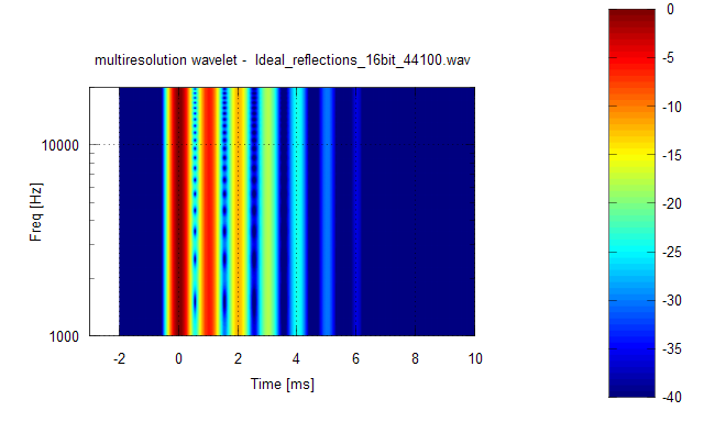

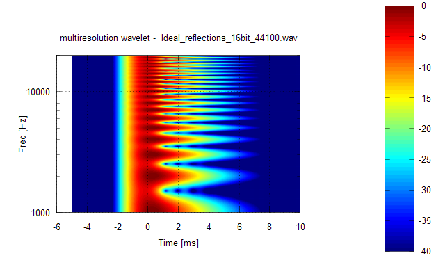

Actually I remembered I've dealed with thie earlier in another thread. My ideal row of impulses is a "CMP" system.
That time I pondered what is the "correct" "frequency response" to present.
First picture showing wavelet transform of impulse row using very short wavelet. At time 0 the "frequency response" is flat.
Second picture showing same system but now with a longer wavelet. At time 0 the "frequency response" has comb filtering effects.
