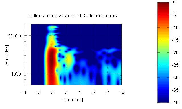

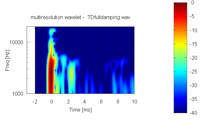

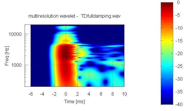

Here's some more wavelets on TD15 impulse response posted earlier. This is the "full damping" case. There are three transforms of different wavelet lengths of 1ms, 2ms and 5ms. These are non-normalised so amplitude information is true. Also notice that the frequency axes have different scales.
From 1ms wavelet one can see energy is packed at 2.5ms. But there are things happening before 2ms also.
In 5ms wavelet the direct sound and the energy at 2.5ms are overlapping and comb filtering occurs. These is mostly visible at 2ms and between 2-4kHz.
It seems clear to me that the energy at 2.5ms is cabinet reflections/diffractions. Maybe that was obvious already 😀

One measurement I would like to see is to place the two enclosures back to back and feed the signal only to the front one as before. This would propably remove the diffraction at 2.5ms and place it further in time domain. Just to validate (by direct comparision) that the 2.5ms really is from the cabinet.

Elias my tests of the AE drivers were on an open baffle, so there was no rear wall reflection.
From John J's comments I take it that this is a suspension or cone issue. It is not as noticeable with the fabric surrounds, although it is still there. It is also most noticeable on the 15" drivers. My guess is it is cone/surround interface issue. Similar to the dip you see around 800-1000hz, on smaller drivers, especially 8" woofers for whatever reason. Or cone flex issue that is mitigated by fabric surrounds but not helped by foam surrounds.
Anyway I haven't seen any big woofers with better IR than the AE drivers so not sure what the fuss is about.
Same here. I tested without the cabinet, and the 2.5 ms wrinkle was still there.
