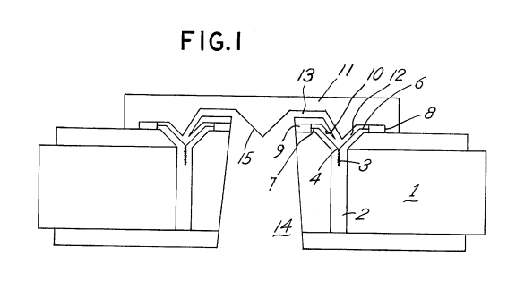

I cannot reveal which driver is being used. But it's a concaved dome tweeter, the same driver is used in all the waveguide measurements I have posted. So the lobe issue is really related with the waveguide design because it will vary based on the design.
As I understand it, there are several variations on the theme but the pic shows the basic concept of the BMS drivers. Point 4 is where the voice coil joins the V-shaped membrane.
Link to the patent:
http://patft.uspto.gov/netacgi/nph-...5,878,148.PN.&OS=PN/5,878,148&RS=PN/5,878,148
Link to the patent:

augerpro said:Michael do you have the device profile in text form or something where I can use it? I have a dipole project forming and it will be using the "new" ESS AMT matched to a B&C 8NDL51 and I'd like to try to make these devices.
No, I have no better data than the referenced pix posted by soongsc.
Zoom to your desire, print it out and smooth the contour by selecting the "right" blade for your jig saw (if you have some skills in this regard too - this works pretty well, as anyone confirmed 😉 )
