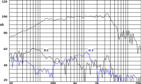

12" Beyma... Liberty 8
I was looking for a 12" guitar speaker with smooth response yesterday and stubled upon this speaker.
I'm wondering if it is a candidate for your project? It has smoother (published) response than a great deal of hifi and pro product. It also doesn't have any of the ragged topend or peaky breakup.
Just a thought,
C
Just a thought,
C
