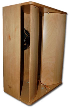

Anyone has any idea what those back wings on Solovox do?

Difuse the back wave. Magnetar talked about doing this on his open baffles.

I would guess interfere with/ re-direct the rear wave, thereby modifying what would otherwise be a reflected interference peak from walls behind the baffle.
Might well tame the peak which can often arise between 60 and 120Hz due to wall/ corner reflection of rear wave from plain baffles, and allow 'adjustment' for individual corner responses which might otherwise distract through being difficult to tame.

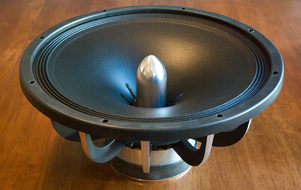

Whoa! The Altec Biflex and 416A are really good drivers. I'd hand on to the Altecs a while longer, and see for yourself how the Lambdas compare. The Altecs are low-Q, of course, and not an effective choice for the low end of a dipole speaker. You might try a pair or quartet of the Dipole15 (LO), use them as bass augmenters (low-pass filtered just below the baffle peak), and see how they complement the Altecs you have now.
Since the cones and suspension are similar, and the Dipole15 (LO) have underhung voice coils (same as Altec), they should have a similar sonic character and work well together. Part of the reason for specifying the combination of Dipole15 and TD15M traits is to optimize the new driver to complement Altec-style 12 and 15-inch drivers - there are a lot of them out there, and the Dipole15 (LO) is intended to make them suitable for OB use. I was thinking of a much broader market than just my own little project.
