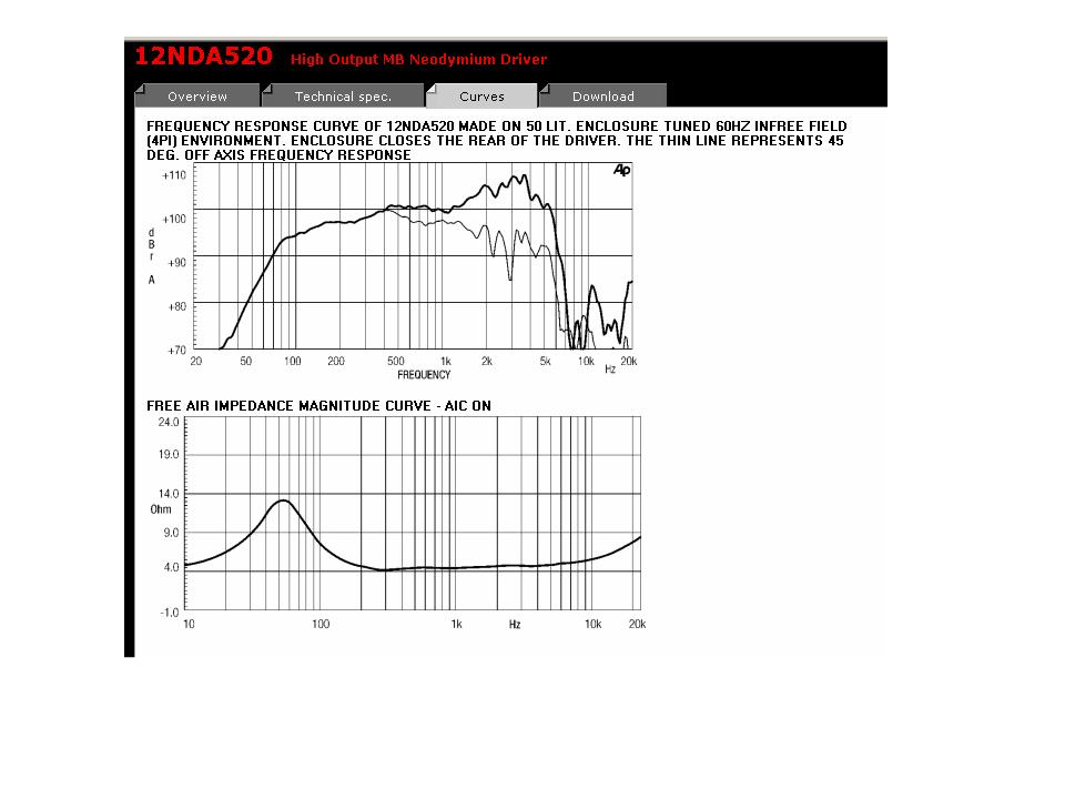

Talking about the rising response, I found almost all of the 18sound's midranges, midbass, woofers are like this -- severely drop off from 500Hz and down. According to such FR graghs, their sound should be very lean and bass shy.
How do they sound in reality? I doubt the 100~200Hz range with 'only' about 90db/w is adequate for pro sound.

12NDA520 on the Audiogon baffle would perform like this without any crossovers applied: (courtesy MJK)
18sound take very special response curves in their presentation evidently promoting special, rather small, enclosure sizes.
The issue is more about 12NDA520's cone breakup performance.

CLS said:Talking about the rising response, I found almost all of the 18sound's midranges, midbass, woofers are like this -- severely drop off from 500Hz and down. According to such FR graghs, their sound should be very lean and bass shy.
18 Sound's measurements are done on practical enclosures in a free field (4pi) environment, so the 6dB drop-off below ~ 500Hz is the result of the so-called "baffle step". Other drivers would show a similar drop-off under the same conditions. Some manufacturers provide measurements for "half free field" conditions (2pi), therefore the "baffle step" does not show.
