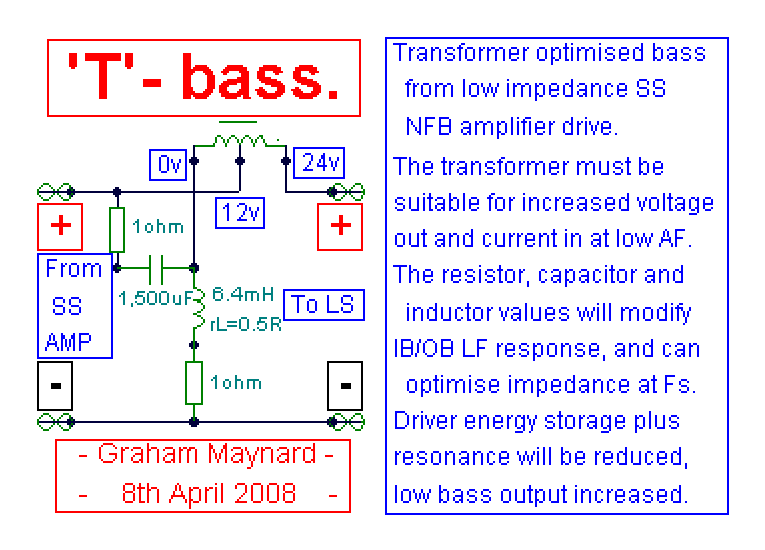

I don`t remember anyone ever mention the importance of low mechanical resistance (Rms) while choosing the bass drivers, only magnets, voice coils and cone types. Aluminum VC formers seem to slow down bass transients considerably, as well as lack of venting the magnet/coil structure.
From my experience, low mechanical resistance plays a very important role for the "subjective" speed of woofers. The higher the Qms or lower the Rms, the better or livelier is the reproduction of bass transients. That of course among other factors, but I`ve never encountered any woofers with low Rms to sound detailed in the bass.
Only Tony Gee from Netherlands seems to pay attention to it:
http://www.diyaudio.com/forums/showthread.php?postid=806812#post806812
example of extremely low Rms 15" :
http://oem.ciare.com/it/296/346/prodotti.php
I am presently using two of these vertically mounted on an 18" wide board.
http://profesional.beyma.com/ingles/pdf/SM115N.pdf
The 2008 version of this LS has more normal close folds in the cloth surround, so it looks different to the manufacturer's photo in their PDF.
I have the tightest/cleanest bass yet when driven using this circuit with a 500VA 2x 40V toroidal trafo, 1000uF capacitor and another choke circa 2.2mH in series with the driver. No resistor in series with the 6.4mH choke; one ohm in series with the capacitor.
My amplifier is 1 ohm capable so I have no worries there.
Other drivers likely to sound good with this circuit, especially larger ones.
Cheers.......... Graham.
