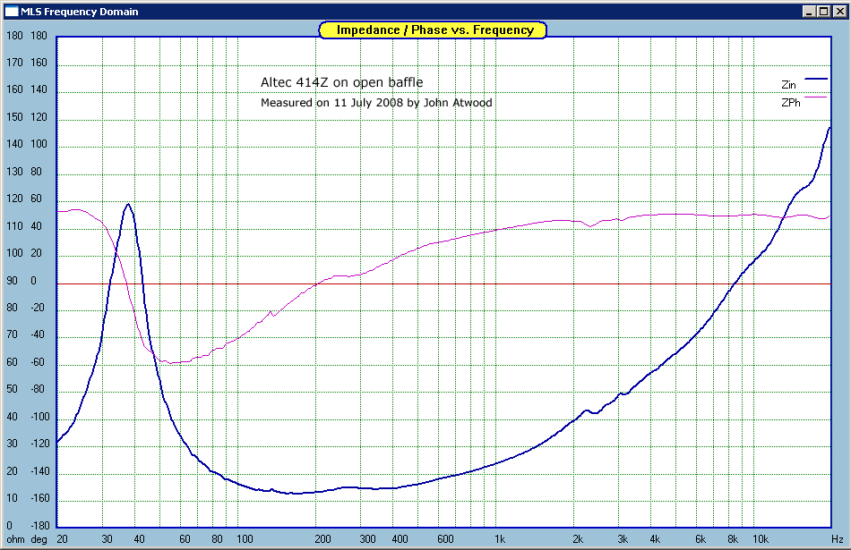

John Atwood has an open-baffle Altec 414Z (similar to my new GPA's) combined with an Altec 288-L and an Edgarhorn Tractrix "Salad Bowl" horn, and he's been getting acquainted with SoundEasy. Here's the impedance measurement of the 414Z mounted in an open baffle - the ripple is at 2275 Hz, well above the anticipated crossover in the 700~850 Hz region. Still, a sharp notch filter might be a good idea - depends on what the acoustic measurements show.

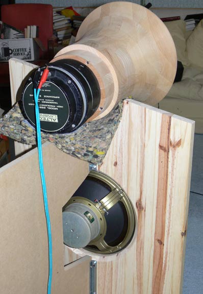

Here's my Heath AS-21s with double 414s, a little Altec porn for the boys. 😉

Here's more Altec porn - John's 414Z, 288-L, and Edgarhorn setup. If they sound half as good as they look, we're all set.
