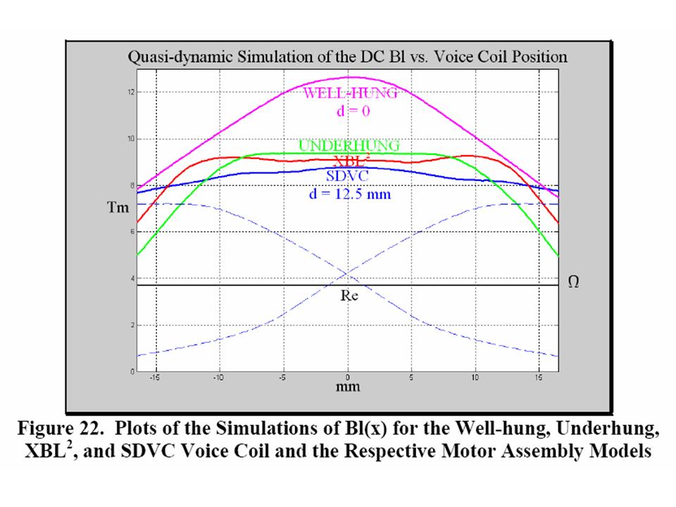

John and Nick,
The pro audio speaker companies have different design goals than diyAudio goal of ultimate home audio, and high efficiency is not a top design goal of Seas, Dayton. etc... New designs are necessary for high efficiency ultimate home audio.
The graph illustrates how a typical underhung motor can have a more linear BL vs. displacement than a typical overhung motor.
For a high efficiency midrange, low Mms is also very important.
Lambda TD10M = 44grams Mms
18 Sound 10NDA520 = 30 grams Mms
An underhung prototype using NdFeB and 30 gram Mms still looks like a candidate for the ultimate high efficiency midrange.
Paper comparing underhung and overhung motors...worth a read. Very loose summary.....
http://www.s-m-audio.com/underhung.pdf
For Bl <18 the claim that an underhung motor structure requires less magnet flux than an equivalent overhung structure was verified only under a qualified condition. The condition was that the total flux of the underhung motor must be at or below an operating point where the core and fringe energy losses are approximately the same as the gap magnetic energy. For flux levels below this operating point, the underhung magnet requirements are less than the overhung’s requirements. If the flux is higher, then the underhung motor requires more magnet than the overhung motor because it’s core losses are higher.
For high Bl ~22, the underhung motor requires 3x the magnetic flux and 2x the core metal volume compared to an overhung motor. However, because of the typically shorter coil on underhung motor designs, lower moving mass is possible on underhung than overhung motors. So, for the same SPL, underhung motors need about 2x the magnetic flux and 1.5x the core metal volume compared to an overhung motor. NdFeB and TC Sounds type thick-to-thin tapered pole steel can do this.

First thing - don't use a Bl only spec for anything as it means zero without including the Re of the voice coil.
Bl means 2X to me, without knowing what the X is you don't know anything about the real number it is specifying.
The problem with NdFeB and that TC tapered pole you are describing is that the TC pole is designed for a magnet on the outside of the pole. Not only is that a massive diameter of NeFeB, I can only imagine the magnet charger needed to zap it to life.
I only looked slightly at the paper but the first problem I saw was that he used a T pole and thin top plate (relative to coil length) to come to his conclusions. If he would have used an extended pole combined with a top plate where the voice coil overhang was less than the thickness of the top plate then his results would have been very different. Both that TC Sounds design and mine use the better ratio and pole height for overhung.
