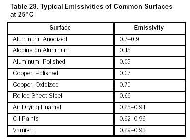

Re: Black is alwawy in fashion...
moray james said:
I forget the percentage (but 10% sticks in my mind) you can increase your thermal disipation by a good factor just by making your parts black. Obviously thermally concuctive colour like oxide is better than paint but even a black paint job will increase your thermal disipation. So this is almost as easy and free as it gets and it all adds up. Some heat sink expert can supply the fine details.
From the OnSemi "Rectifier Applications Handbook", Chapter "Cooling Principles", a table about heat radiation emissivity (vs. the Black Body):
Interesstingly the color of anodization and paints isn't specified...
- Klaus

Re: Re: Black is alwawy in fashion...
Interestingly the color of anodization and paints isn't specified...
I would assume for paint that they used black. But the interesting thing is that it doesn't matter for anodization. Any color has pretty much the same emissivity at the IR wavelengths of interest.
