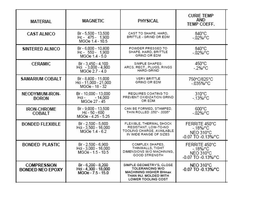

The benefit to the alnico is mentioned by a few others. It is less prone to the flux modulating as the coil moves through the gap. As Nick mentioned, the full copper sleeve on the pole achieves a similar effect. This shorts any eddy currents created by the coil's movement through the gap and as a result fixes the flux so it can't move. Whether it does it as well as alnico or not, we'll have to find out.

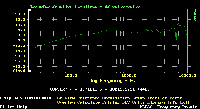

I am afraid I must respectfully disagree. You are making an implicit assumption that all loudspeaker systems are minimum-phase.
Most multiway systems are not - the crossovers act as allpass filters. An allpass (phase-rotating) filter has a completely flat frequency response, and will measure as such on a display that discards time information - which the standard FR graph does. Traditional techniques such as swept-sinewave, or filter-bank Real Time Analyzers, do not collect time or phase information, and will also be incapable of distinguishing an allpass characteristic from a straight wire.
In addition to allpass crossovers, very few multiway systems have time-coincident driver alignments. It is more convenient and esthetically attractive to mount all of the driver flanges on a common front panel, and let the time arrivals fall where they may. Here is an especially dramatic example from a 3-way horn system, showing the frequency response:

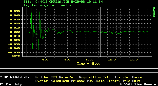

And here is the impulse response (which was used to calculate the frequency response shown in the previous post).
This loudspeaker is grossly non-minimum phase, with the tweeter several wavelengths ahead of the mid-horn. The front flanges of the horns are all nice and pretty on the front panel, but the diaphragms are several inches apart - and the crossover is at 6.2 kHz.
The frequency response shows a deep notch, but how can the impulse be calculated from a display with no time or phase information, and both the crossover and driver alignments are non-minimum phase?
There are many different locations in space that would produce the notch shown in the previous post. With time or phase information preserved (and collected in the first place by the appropriate measurement technique), the impulse response, deviation from minimum-phase, and CSD can all be shown. If the time and phase information were never collected in the first place, they cannot be re-created.
Loudspeakers are not amplifiers. They are more akin to an RF transmission path with severe multipath problems, and the associated degradation of time-dependent signals such as stereo FM, NTSC and PAL color television, and PCM. What makes the problem more challenging than the RF equivalent is the extreme bandwidth required - two to three decades, an astounding bandwidth in the RF world - and the complex radiation pattern of the emission source, which shows an additional non-minimum phase characteristic that changes with emission angle.

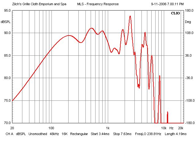

Zilch over at the Lansing Heritage Forum has made a set of measurements of JBL 123A, as used in the L100 "Century". Scroll down to Post #52 to see Zilch's graph of the midrange, reproduced below.
I think "heavy equalization" is the right word here. If this driver were to be used in a high-fidelity application, it's going to have to be aggressively lowpassed with a 24 dB/octave filter, massive notch-filtering, or both.
Since the JBL L100 "crossover" did not use any lowpass filter at all for the 123A, you can see what kind of midrange this speaker had - designed to mimic the peaks of the Altec 604 Duplex. Yes, the peaking was intentional, and just the kind of boom-and-sizzle the target market wanted. JBL sold a zillion of these things - that Maxell ad with the flying cocktail glass put the L100 on the map for all time. I have to admit the L100 has always looked great, with that beautiful white cone and the cool 3D-effect grill foam in electric blue or that true 70's color, funkadelic burnt-orange.
