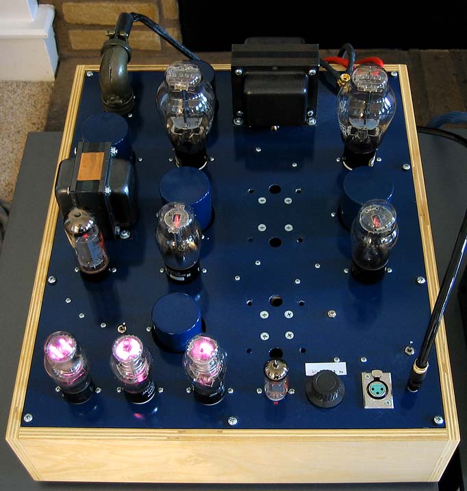

The comment about keeping costs down brought a smile - see pix below. That's one channel of a 16-watt Class A amplifier. I didn't design it because I'm into the SET craze - although I'm partial to some of them - but as a research project to see how low I could get distortion in the forward path, with no assistance from feedback or feedforward techniques, as well as investigating a topology that as little variance in dynamic output impedance as possible (as voltage swings up and down, many amplifiers have instantaneous changes in output Z as devices switch on and off).
It might be possible to do the same things with MOSFETs, but they'd require some fairly exotic analog-computer pre-distortion techniques to get the forward-path distortion as low as DHTs are naturally - besides, aside from the charms of a 520 volt B+ supply and the pleasing glow at night, I was curious about the sound of the devices themselves, not the devices + complex pre-distortion circuits. So I'm willing to go out on a limb with these little projects, and if it's out of fashion in audiophile and engineering circles, so much the better.
I like investigating these obscure corners of audio - techniques that fell out of favor decades ago, or were outright forgotten, such as the Western Electric alternative to negative feedback, the Harmonic Balancer, which was partially revived in this amplifier. It was last used in the Western Electric 92A, circa 1935, and was forgotten when the Williamson swept aside all other topologies in 1947.
For some reason, and it really seems little more than historical accident, Hollywood (Altec and JBL) did not follow up on the time-domain research of D.E.L. Shorter of the BBC and Richard Heyser - even though Pasadena, home of Caltech, is only a few miles away from the headquarters of both firms. Probably one of those all-too-typical Not Invented Here things (I worked at Tektronix for nine years, and John Atwood has told me plenty of stories about what it was like to work for Intel, Sequent, and Apple).
Anyway, with computer techniques, we can look at things that should have been investigated many decades ago - and time-domain performance of high-efficiency speakers is right at the top of the list. Will the compression driver & horn (or waveguide) outperform the stacked array of direct-radiator midranges (I already have a quartet of 18Sound 6ND410's)? We'll see.
Lynn isn't even showing you the power supply which is another chassis (total of 4 chassis for one 16 watt/channel amp).
Nor is he mentioning the transformer count...yikes what a lot of iron!!!
Or the incredible performance levels. Just marvelous sounding devices, and no audible hum either.
