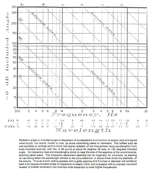

I need to post some measurements of the little Emilar EK175 driver in a 80 degree conical horn. These measure and sound great. The throat is real short with the EK175, the flare is high and these are the three slit phase plug model (There is another EK175 with 2 slit that is really inferior) - they are quite a bit better then the B&C DE10 if you ignore the response above 15K. Very nice little treble driver horn combination. Maybe this weekend I'll post measurements if I get the time, I am installing two BIG horn subs at friend's to mate with his Rock Monitors- it might get hairy - What's nice about these treble system is above 3K no eq is really needed and they maintain 106 db sensitivity to 'keep up' with a compression mid and match well at the 3K crossover in dispersion- all the mid needs is a hair of eq above 700 (shelf filter) to make it usable to 500 cycles at the same sensitivity as the EK175. This allows for nice integration with a single amp 500 cycles up.
The throat size does NOT tell the whole story of radiation! You will hear/ measure this when you get them setup. The larger horn (I thought it was a lower flare rate then it is because I ignored the extra size needed for the mouth exit, these are a lot bigger than a tractrix for a given flare because of that) may not beam too bad, it actually should be similar to my 350 Hz tractrix horns (half the diameter!) in both low frequency loading and high frequency beaming. It should be fine in the 700 to 1000 crossover region and OK in beaming to 2-3K - The smaller horn may not load well down there though and would be better on top. A catch 22 - I look forward to see how you get this aligned with the ribbon.

>Beaming sounds unnatural to me<
I am aware of beaming, I have a 15" wideband driver that is run fullrange. I know, scary. Now what exactly sounds unnatural to you with regards to beaming?
Thanks for the response. I'll show you some measurements and maybe we can work from there?
I abhor the head-in-a-vise affect of beaming. Move your head a fraction of an inch while listening and the FR changes. No thanks. But then again I am a type #2 & type #3 type.
Thanks Josh
Tell me, how can one measure beaming? Would it be safe for me to say, I should put the meter on axis and just measure one driver, the one that would present beaming?
Anglo said:Thanks Josh
The easiest way is to put on some music and move your head around. If the sound changes a lot then the speaker is beaming. Panel speakers and big non-CD horns are the worst for this in my experiance. It really screws up the 'power response' too, very unnatural and fatiguing to me. Seems some people live with it though. Big headphones unless you move

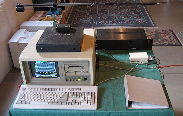

Thanks all, much appreciated real-world experience and info. Anglo, the only measurements I can get much use from are FFT's with at least a 5 mSec window, floor reflection removed through acoustical means, and NO SMOOTHING for the computed frequency response. I appreciate seeing the time data with the selected time window (5 to 8 mSec is useful), and the associated FR data that is calculated from the time data. (This is how I present the Ariel data, for example, so the derivation is always clear, along with the choice of window size.)
If the floor reflection is left in the time data, then the CSD is useless, and the FR data is cluttered with comb-filtering that makes fine resolution impossible to read. 1/3 or 1/6 octave smoothing removes the comb-filtering artifacts but also removes evidence of diffraction and narrowband resonances as well. This kind of smoothing dates back the early-Fifties "pen-damping" days at Altec and JBL, and had the very convenient benefit of concealing defects in the horn and compression driver. Now that we no longer use B&K swept-sinewave techniques with a mechanical chart recorder, there's no longer any reason to conceal fine frequency data. (Pixel damping?)
See my measurement article at Nutshell High Fidelity for the kind of data I find useful - pay particular attention to the artifacts generated by comb-filtering from the floor reflections. With spare bits of household items (coats, pillows, blankets, etc.) you can do pretty good job (20 dB) of attenuating the floor bounce, and get much better data as a result.
