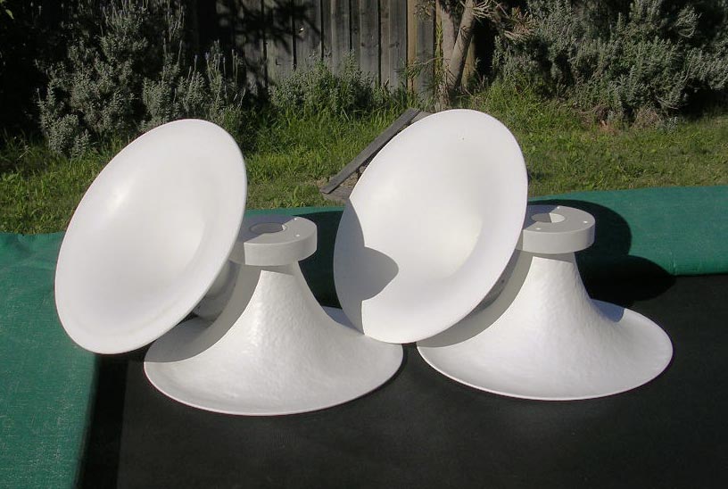

Lynn Olson said:Two rather simple reasons I favor the Le Cleac'h profile over others.
1) I can buy them right now, from Azurahorn in Australia, Music Concrete in France, and Experience Music in Memphis, Tennessee. These aren't the only people building them, but they're the ones I've been in communication with. All of the products look well-built, measure exceptionally well, and have a good track record from buyers and listeners.
Looking at pics of a le'cleach horn, it seems to have a lot in common with an OS waveguide.
Perhaps I am oversimplifying things, but as I see it, there are three big features in an OS waveguide:
1: The majority of the waveguide is a plain ol' conical horn
2: There is a LOT of attention paid to matching the mouth with the exit angle of the compression driver. As someone noted previously, Geddes critiqued someone's spreadsheet which ignored the exit angle of the compression driver. This is a very big factor in the OS waveguide. For instance, if you have a sixty degree conical horn and you mate it to a compression driver with a six degree exit, there is a massive discontinuity where the two meet. The OS waveguide is designed to minimize this discontinuity.
3: Geddes uses a massive roundover at the waveguide exit to mate the waveguide to the baffle. The roundover in the Summa is 2" IIRC.
To make a long story short, when I look at the pics of the Le'Cleach waveguide, I see a lot of the same features. The body of the horn is conical, but there's a lot of attention paid to minimizing diffraction at the throat and mouth.
Basically most horn guys are going about it all wrong. They get wrapped up in arguments about the profile of the horn, when they should be worrying about improving the mouth and throat termination of their horns. Changing the profile of a horn may improve the quantity of sound, but I'm worried about improving the quality of sound. The surest way to improve the quality of sound in a horn is to improve the mouth and throat termination.
