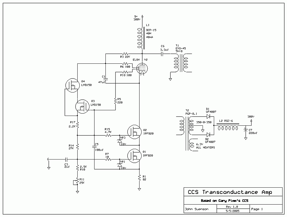

John Swenson transconductance amp post
I generally think that JS is one of the smarter guys around, so I frequently save schematics and such that he posts. I believe he has significatly revisited the PS for the amp, but to the best of my knowledge the Signal section is unchanged.

Re: Re: John Swenson transconductance amp
John
Thank you. looks awfully complicated for 3W, but I have all the parts on hand, except for LND150's; no source for them.
LND150 substitutes
Nah not really that complicated. The LND150 just creates the bias voltage for the MosFETs - you can use batteries here instead (9V). You can throw away the tube as well - in this circuit it's just an "intelligent resistor" with no part to play in the amplification process. If you throw away the tube you just gotta heatsink the top MosFET and keep it below max dissipation, easy to do. In fact, it would end up just like the circuit on this page:
Gary Pimm battery bias CCS
A conventional transformer actually works "better" than the parallel feed version shown - better PSRR. I use parafeed, but with the OPT coupled across the choke to get the same PSRR as series feed. I trim the output impedance with a resistor across the choke, in my case 10K 2W.
It's a GREAT wee amp and I totally agree with John Swenson's assessment - it comfortably beat everything else I've built and is easily scalable for higher outputs. I've also built John's DAC output stage (based on the same approach) with similar results.
In fact, a push-pull version (think cascode Moskido) using low impedance Plitron output transformers (340R:5R) would be almost unbeatable, IMHO.
Mike

"A conventional transformer actually works "better" than the parallel feed version shown - better PSRR."
As I understand it, there are three primary reasons why parafeed is usually better than conventional feed:
The absence of the DC across the transformer allows for better core material, such as permalloy, which allows for better coupling, thus better sound in areas such as dynamics.
The parafeed dc blocking capacitors are lower in value which usually means that they are better in quality which results in less impact on the AC signal compared to capacitors usually used in the power supply (in conventional feed, the AC signal traverses through the power supply).
The paralles feed topology allows for the transformer to be wired as a autoformer which allows for a more transparent sound.
As far as PSRR is concerned, just design the power supply more robustly.
Retsel
Hi Retsel, firstly I'll apologise to Lynn for getting off topic, any further discussion could be shifted to the Magnequest forum.
Yes I'm aware of the advantages of parafeed which is why I have Magnequest TFA2004NiJr and nickel EXO-050 transformers at my disposal.
When building the transconductance amp, the first transformers I used were TFA204 (Series feed) which sounded OK and quiet.
Then I went to BCP-15/TFA2004NiJr parafeed as per John Swenson, which sounded great but more PSU noise. Final iteration is parafeed but with the transformer coupled across the choke, still parafeed but collecting the signal in the same way as the series feed.
Remember that the textbook cascode connection "has almost zero PSRR", according to most references. This statement is correct, but missing the other part of the sentence, "with respect to ground".
Guess what - this means that it has almost 100% PSRR with respect to B+! A series feed transformer collects the signal between the cascode connection and B+, resulting in almost 100% PSRR.
Remember that the influence of the final PSU cap on sound is related to the PSRR. In a single-ended tube amp, the impedance of the tube is usually much lower than the impedance of the load, which is why parafeed works better referenced to ground. With a cascode topology, the opposite applies.
What's more: I've tried it and it sounds better!
Best regards,
Mike
