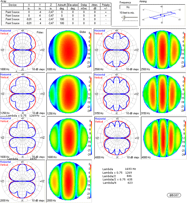

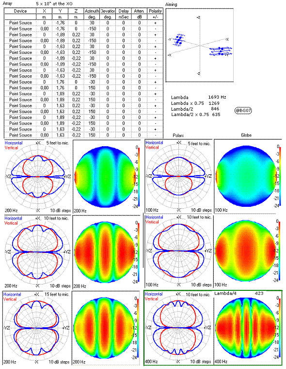

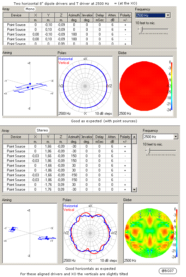

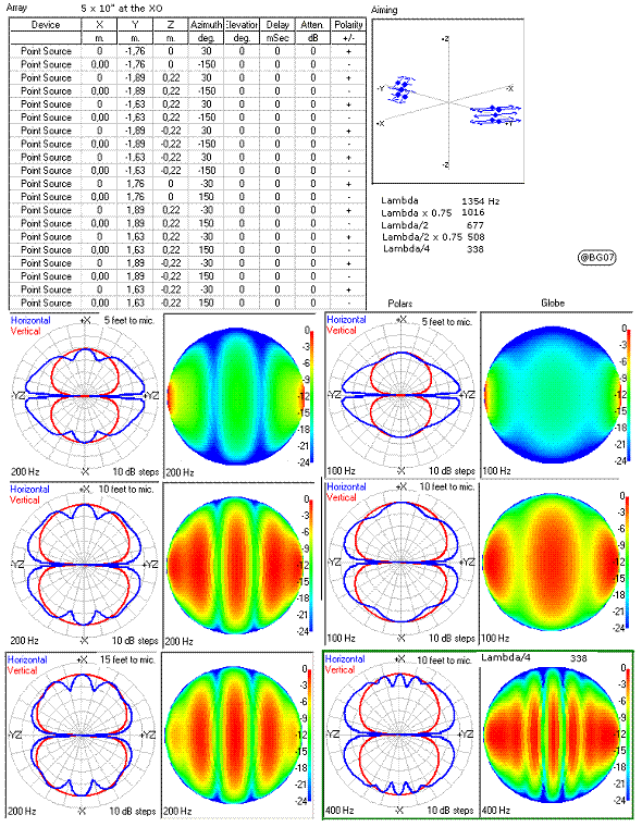

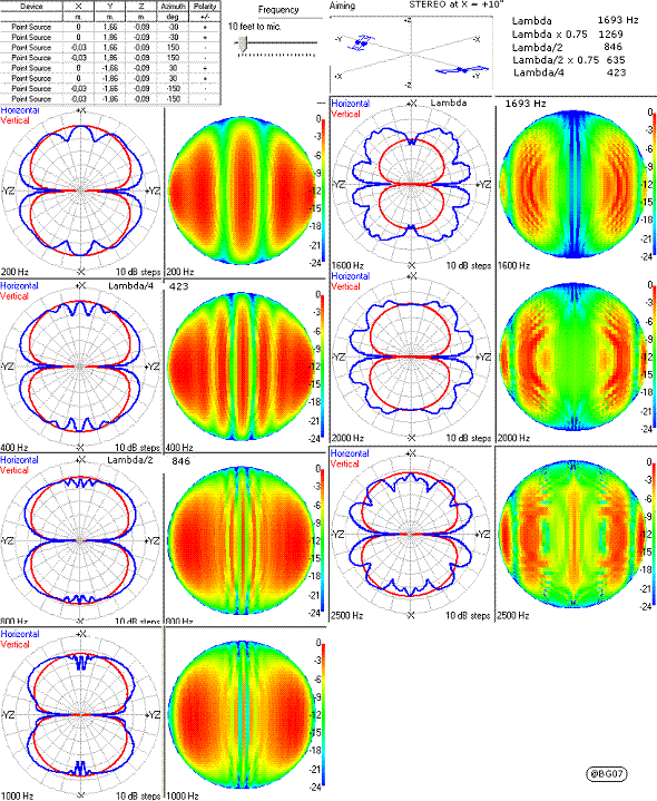

I made a couple of simple dipole point source simulations which of course isn’t the whole true but reveals a lot, at least within +- 15 degree azimuth.
Serious horizontal dispersion problems (+ summed localisation smear = wide central phantom at 10’, atan (8”/10’) = 3.8 degree horizontally) can be seen when using the horizontal placed 8” drivers + crossing over high at 2500 Hz if stereo, picture5 (5), but looks good at lambda x 0.75 or lower and if placed centrally, picture 4(5) as a mono speaker, even better.
The 5 x bass speakers works ok below lambda/4 and the stereo combing (observe at t=0 and no baffle or wall reflexes) at XO looks as expected (normal 200Hz combing with this speaker separation) and should perform well.

…what do you think about the horizontal placement of the midrange drivers in magnetar's sistem…

Interesting, now put a 6db (90 degrees out of phase) high pass at 1K on the inside midrange.

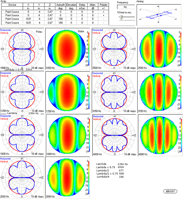

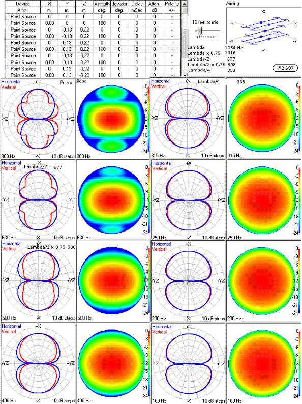

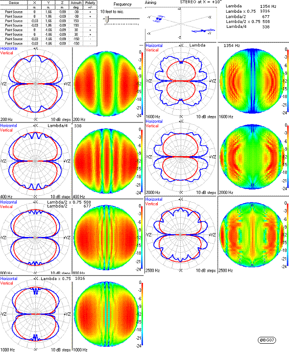

…Interesting, now put a 6db (90 degrees out of phase) high pass at 1K on the inside midrange…
I don’t think a high pass a capacitor in series with the inside midrange would help the dispersion and blur problem but the opposite would:
A low pass filter, a series inductance at 1 kHz on the outer drivers solves both the horizontal blur + dispersion issues.
