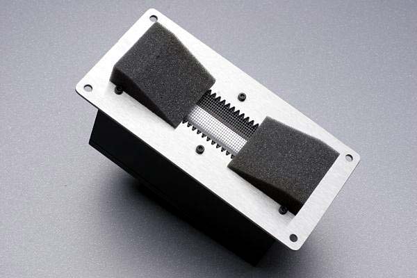

at Lynn's party, but I'm trying to organize a group buy for the RAAL 140-15D (the big one), and have had a very inactive thread in the group buy section.
I have finally had some action in the last week but will go ahead and post the details here.
http://www.diyaudio.com/forums/showthread.php?s=&threadid=108035
I am interested in buying a pair of these tweeters. The retail is a little hard to swallow, but the price drops to $169 EURO each if you buy 10 or more...this means if five people want two tweeters we would have a group buy. There are further price breaks at 20 and 50, but they are not as significant.
I am putting the feelers out to see what kind of interest there is.

Have you purchased your set of RAAL tweeters? Can I assume that the RAAL is >80% certain to be used in your speakers? Are you still planning on using back tweeters and should we add the RAAL mini to this group buy?
The reason that I ask is that USD is weak and is getting weaker; so I like to pay for European goods (payable in Euros) sooner rather than later.

Just curious about vertical beaming - while advertised as having good vertical dispersion, this RAAL model if you look closely at the SPL curves, is about 10 dB down at 20 degrees vertical. I still find this quite a lot of vertical beaming.
I don't know about mix and match.
I will see Alex at Burning Amp and ask him about it then.
C
C
Re: I don't know about mix and match.
Please do. If Alex allows it, some of us will be buying 4 tweeters instead of just 2.
