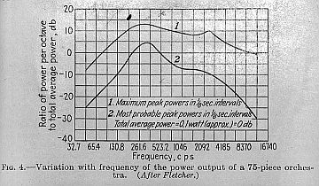

hello Lynn
i heard the MBL big system at CES this year. I did not have the impression that it sounded stressed. Actually, intereseting, that it was very dynamic, almost like a hornspeaker. However, what disturbed me most, was too much sound radiating backwards. At a concert, most sound radiates to the public, and only a small part is reflected thrue the walls etc. Would it not be better, if only 70% would be direct sound, and 30% reflected ? If this is adressed with horns, it would be perfect. interesting what Avantgarde writes in this regard in their white papers. might you comment it.
Just think of a full orchestra recorded via just two microfones. If you play such a recording with a loudspeaker system, the recorded sound reproduction will include the original imaging of the room situation. If you add to this acoustical information of your own room you will automatically receive a vague, diffused picture. The greater impact you own room has on the acoustics the more original performance will be blurred. This effect is very tipical for loudspeaker systems with a wide dispertion characteristic. A listener with less experienced ears will immediately have the impression to heaer real room staging. The sound seems to come from everywhere, demonstrating depth, width and height. But these artificial reflections have nothing in common with the original sound.
there is also a very informative site from Jean Michel LeCleac'h adressing this matter :
http://freerider.dyndns.org/anlage/LeCleach.htm
download theory of operation
Angelo

Not sure I totally agree with the Boyk model (or parts therof) wherein ultrasonics out well beyond human audibility have an impact on what we actually hear in the 20 - 20Khz alledged human range (or ~25 - 14K for myself😉 ), notwithstanding generation of beat frequencies between ultrasonic components in a live performance influencing the timbre of instruments when heard. If those in-band frequencies are there, they will be captured w/o the need to reproduce the ultrasonic signals per se.
Not all of us "audiofools" are gullible enough to buy into the Julian Hirsch model of review, wherein all speakers are, to paraphrase Garrison Keilor's Lake Wobegon Days' "all the drivers are strong, all the cabinets are good looking, and all the technologies are above average"... often followed on the opposing page with a large ad for the device being reviewed.
Having played several instruments (reed) in orchestral works, listened to many more in person, and owned or listened to hundreds of systems over several decades, I personally have never been under the illusion that what I hear from a system is close to what I experience at a live event. Two different beasts altogether.. always will be. I have managed to build systems that reproduce some of the "you are there" attributes, (see pic previous post) sometimes even sounding subjectively better than a live performance ever will.
