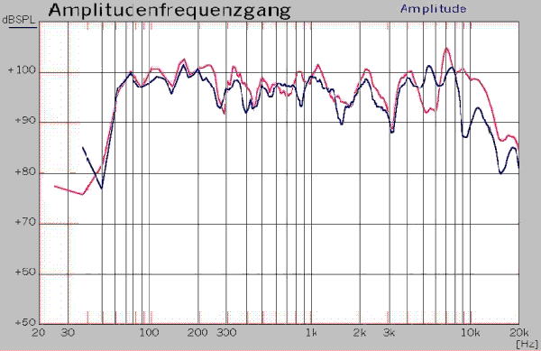

... some new measurements this weekend, an the result was very interesting.
I noticed that the treble reproduction of my "Viecher" improved over the last weeks and wanted to see, if this could also be confirmed by measurement.
This is the measurement I did when the "Viecher" were new. It was made at the begin of January, 2 months ago.
This measurement I did yesterday:
Noc changes on the Viech have been done, and also the measurement parameters were the same. All changes in the frequency plot are due to break-in of the drivers. This improvement in the high frequency area is also acoustically noticeable.
This shows that the break-in of fullrange drivers seems to be more than a myth. 😀
Nice greetings, Berndt

Dear Berndt,
Excellent results! Very nice and well thought and documented project, my congratulations. What I would like to ask concerning the measurements, what kind of equipment and setup did you used for taking these measurements? Meaning height and distanse of microphone, room location when measuring and also what equipment and software. I am in the search of measuring my horn speakers and am not yet sure how to accomplish this task.

Hi Panos,
I use a measurement system called DLSA, which comes from Germany. The fine thing is that it comes with micro (calibration file included), feature box and Software. All you need is to plug the box via parallel port in the computer and install the software. No hassle with soundcards, microphone calibration and other issues. Also the no-nonsense user-interface is nice to work with. The only disadvantage is the lack of harmonic distortion measurement ability.
http://www.dlsa.de/
The setup up the measurement was the following:
- Distance micro-driver was 1 meter.
- The speaker was taken away from the wall.
- The micro was aimed 0°/0° directly at the dustcap.
- Input was 1 Watt.
- Reference signal was taken after the Amp to exclude influence of the Amp.

Burn in, or not?
Se on moro!
I took the effort of putting the images on top each others for better readability, and what do you see actually? Not only the 10kHz region but the whole freq response contains variations of several dBs.
Important would be to know if these changes are really due to driver 'burn in' during the time, or has the measurement conditions changed. The variations could come from slightly different room locations of the speaker and the microphone, or simple numerical noise of the FFT of the measurement software.

😀 ELIAS, I would say it is ' burn -in' [ the result of the surround and spider softening up> with continued use ] as you say in your post at least the nasty peak at 7 k has smoothed off somewhat as has the rest of the response overall much nicer than original😉 cheers TC
