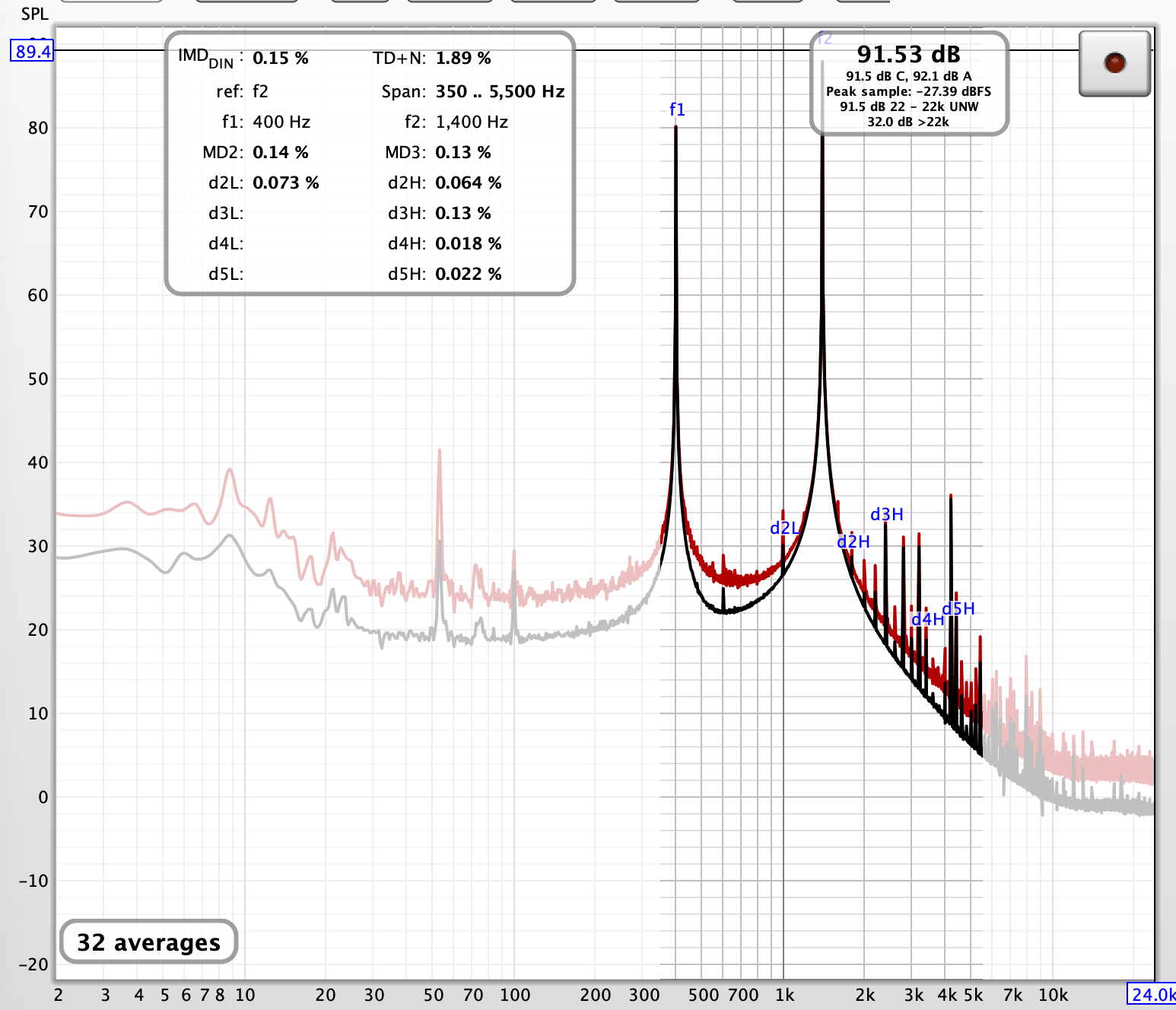

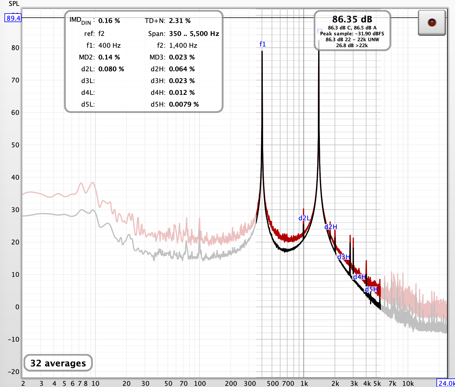

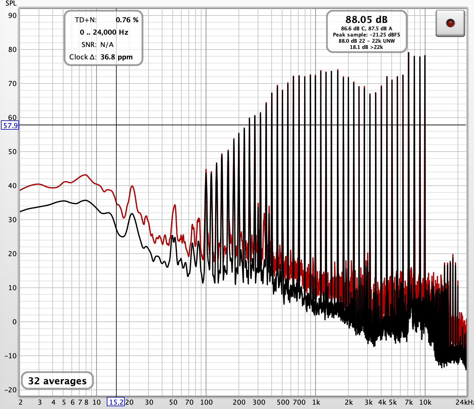

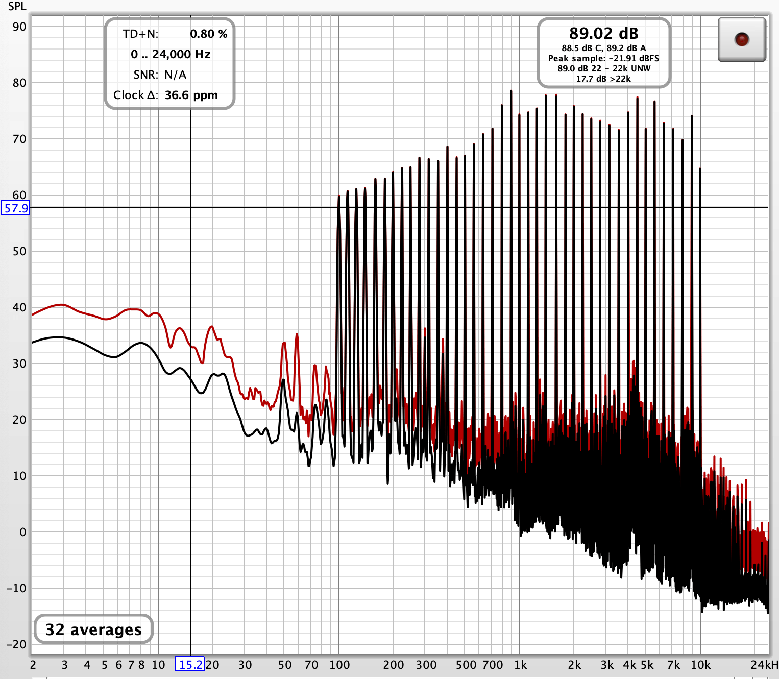

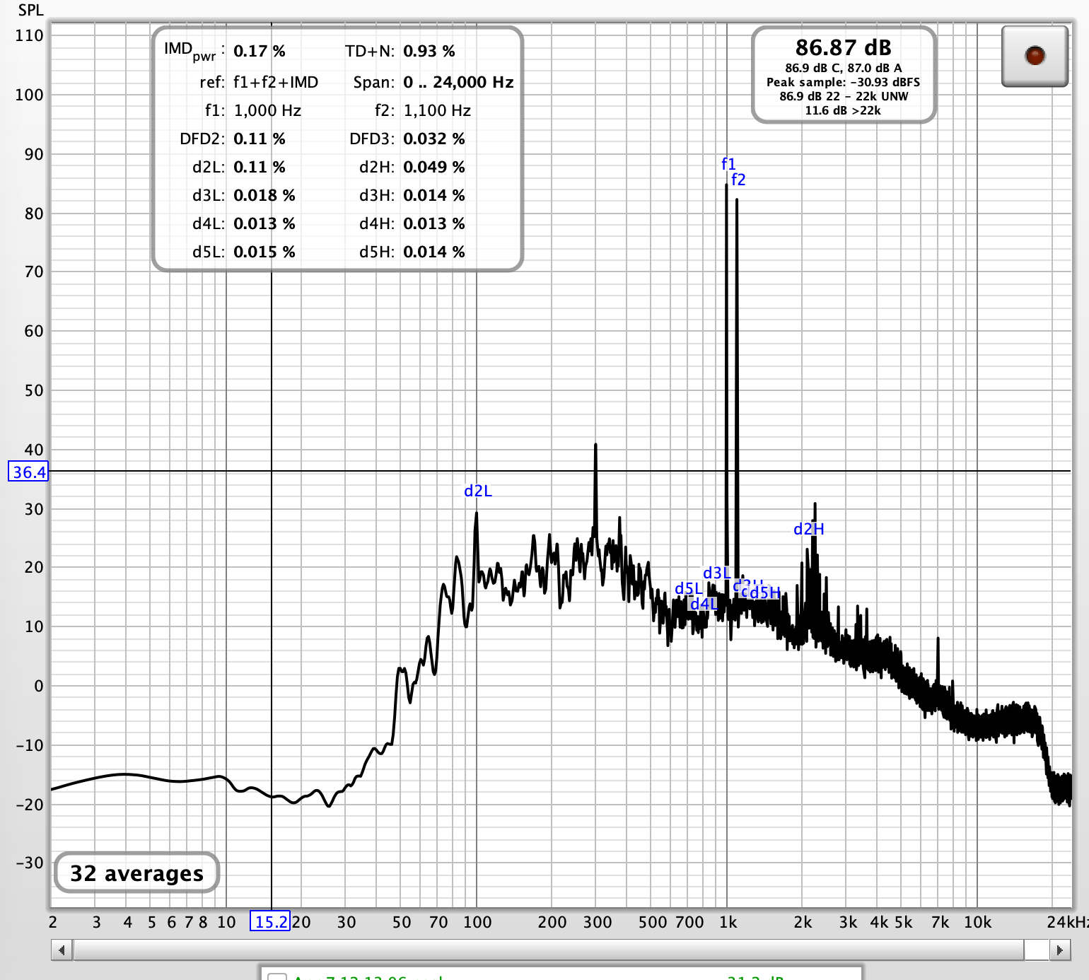

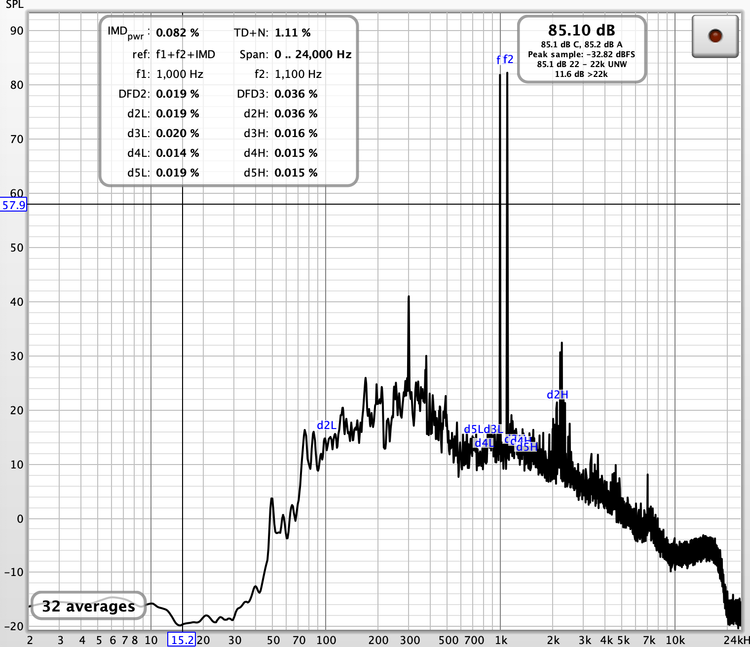

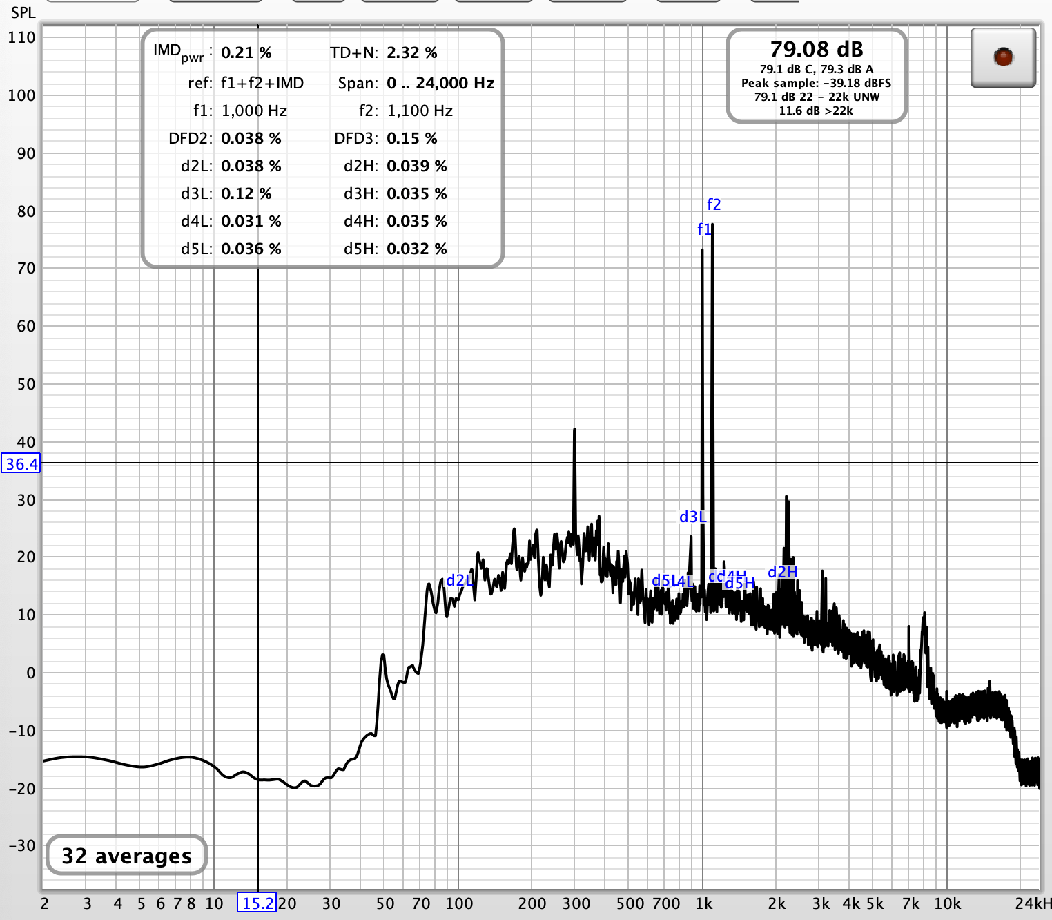

I was surprised when I saw these measurements: they did not seem to correlate with my listening impressions. The beyma and the 18 sound that seem most pleasing to me are on opposite poles when at IMD. The SP6 which is the cheapest (about 1/8th the cost of the beyma!) and the worst in terms of sound characteristics excels in these measurements... Maybe I should have used a crossover filter and not measured midrange at full range? I measured residuals from the breakup that in real use would be filtered out by the crossover? Are the differences in distortion so small that they have no effect on listening characteristics? I do not have a clear idea of what IMD values are typical for a good midrange. I must admit that I have no experience with IMD measurements. Any suggestions are greatly appreciated.

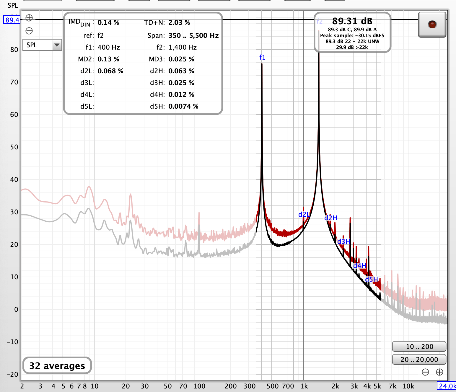

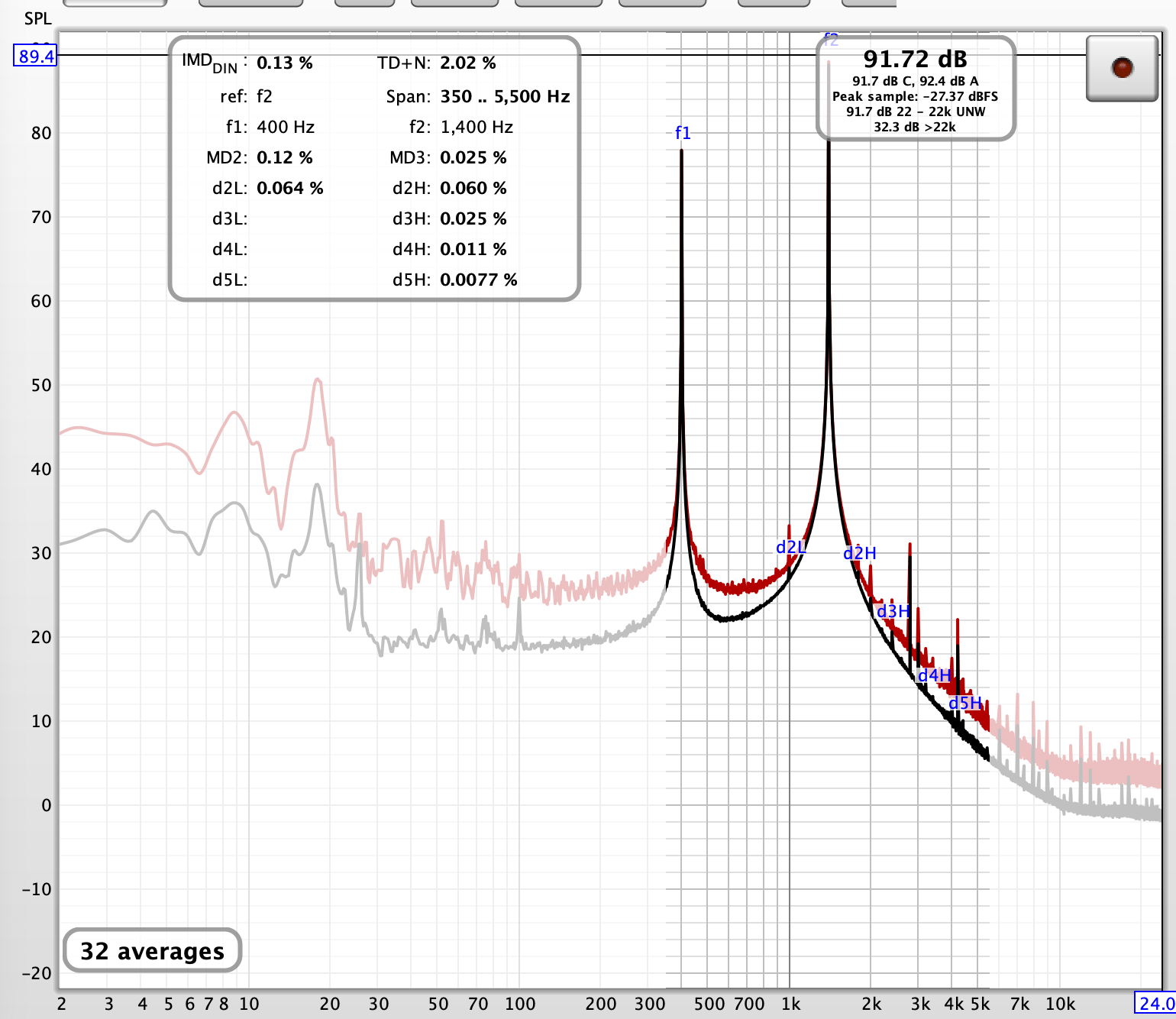

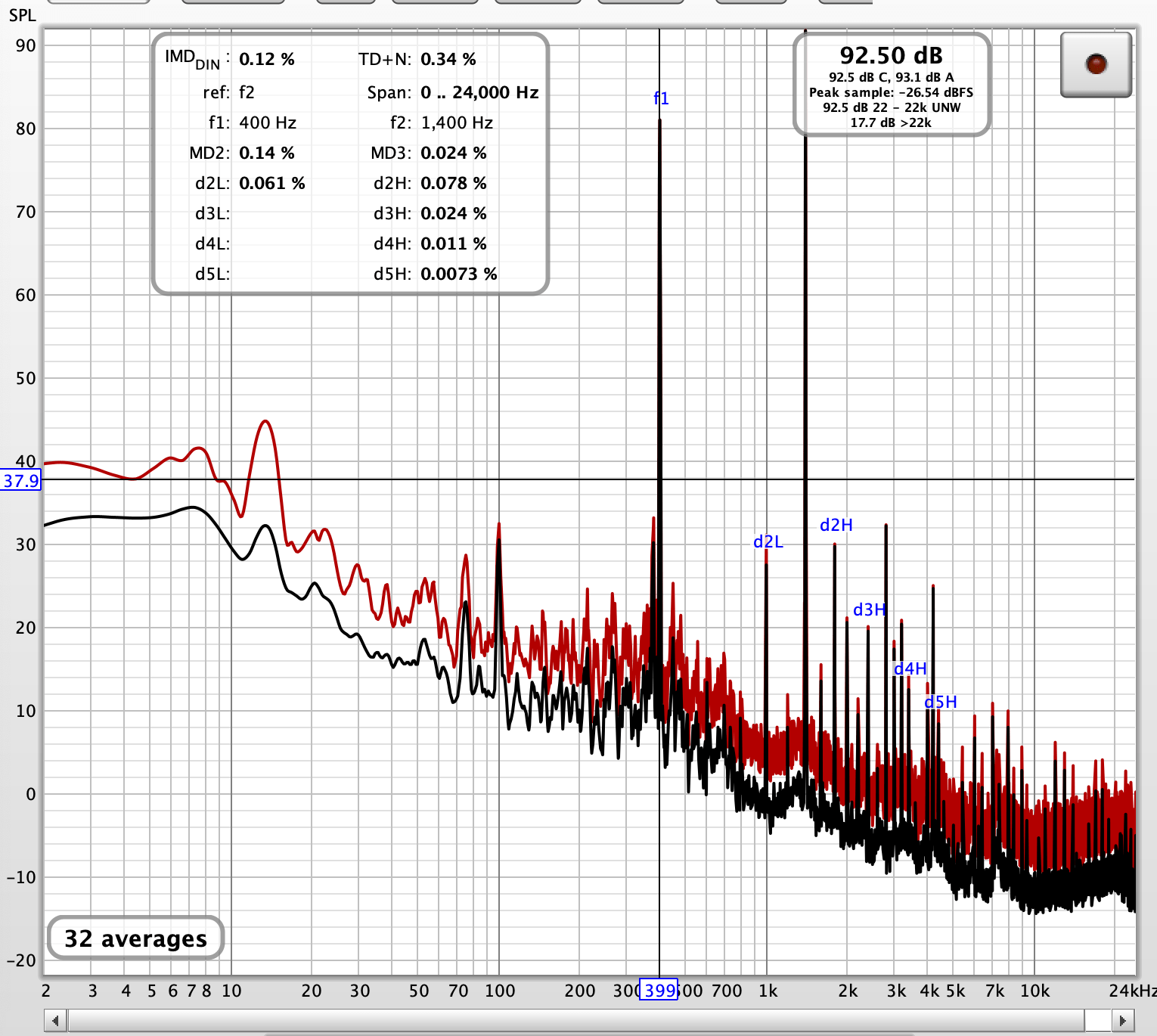

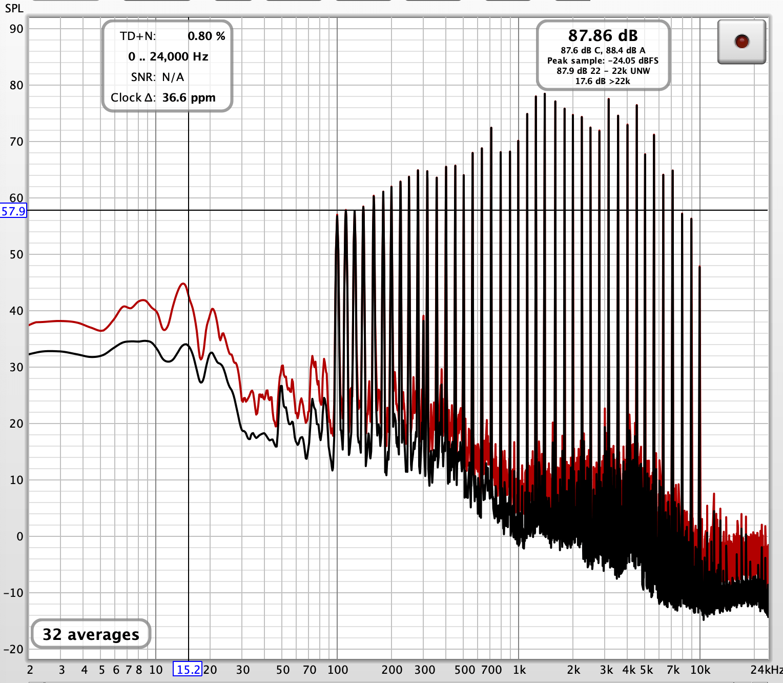

I tried to redo the measurements, same parameters as before but I considered the typical potential use range of midranges: I imposed a crossover filter LR48db 300-6000Hz. Band analyzed by REW for the purpose of IMD calculation 350-5500Hz. I am definitely still sampling some of the residuals of the membrane braekups but less than in the full-band measurements. As you can see the results seem more reasonable. There doesn't seem to be much difference in IMD emerging between speakers. It seems to me, after viewing some measurements of other loudspeakers, (please confirm if what I am saying makes sense) that all these midranges have very low IMD values, both measured fullrange and with crossover filtering.

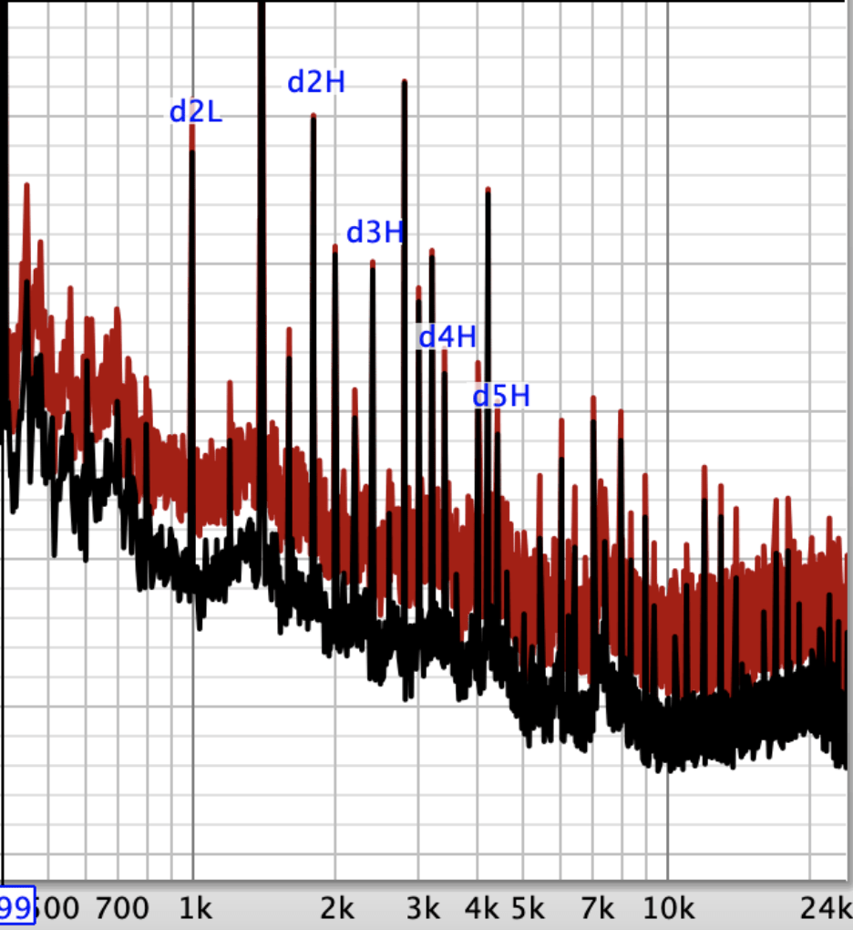

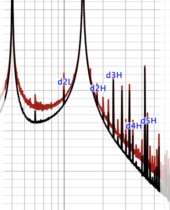

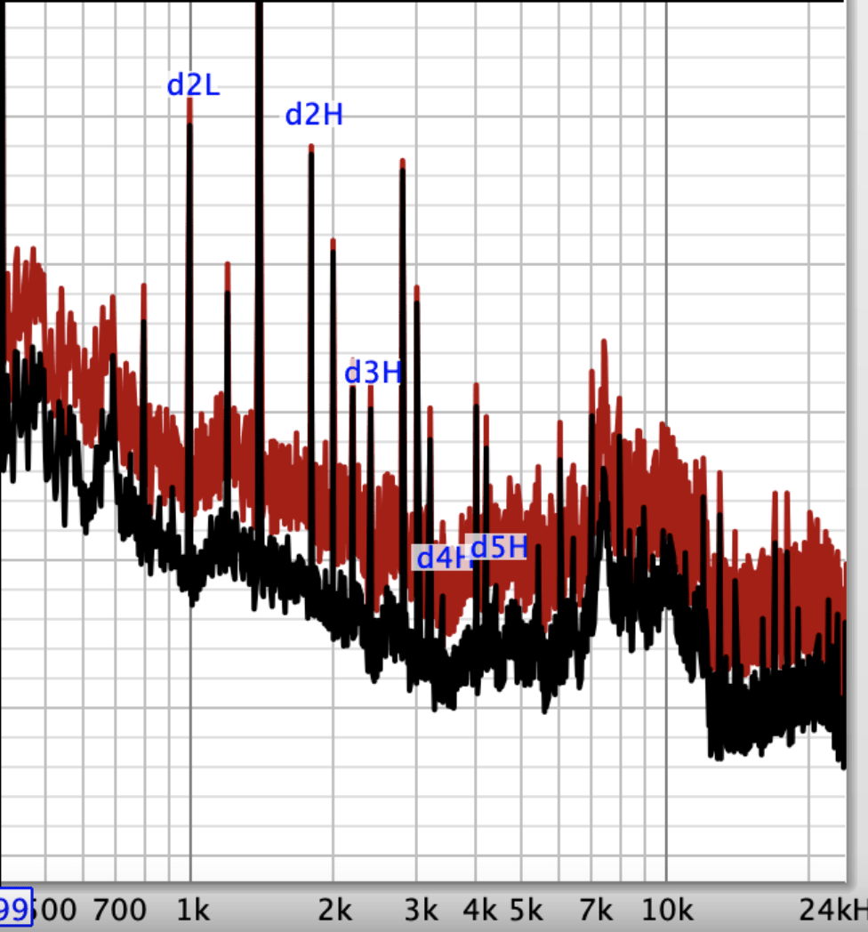

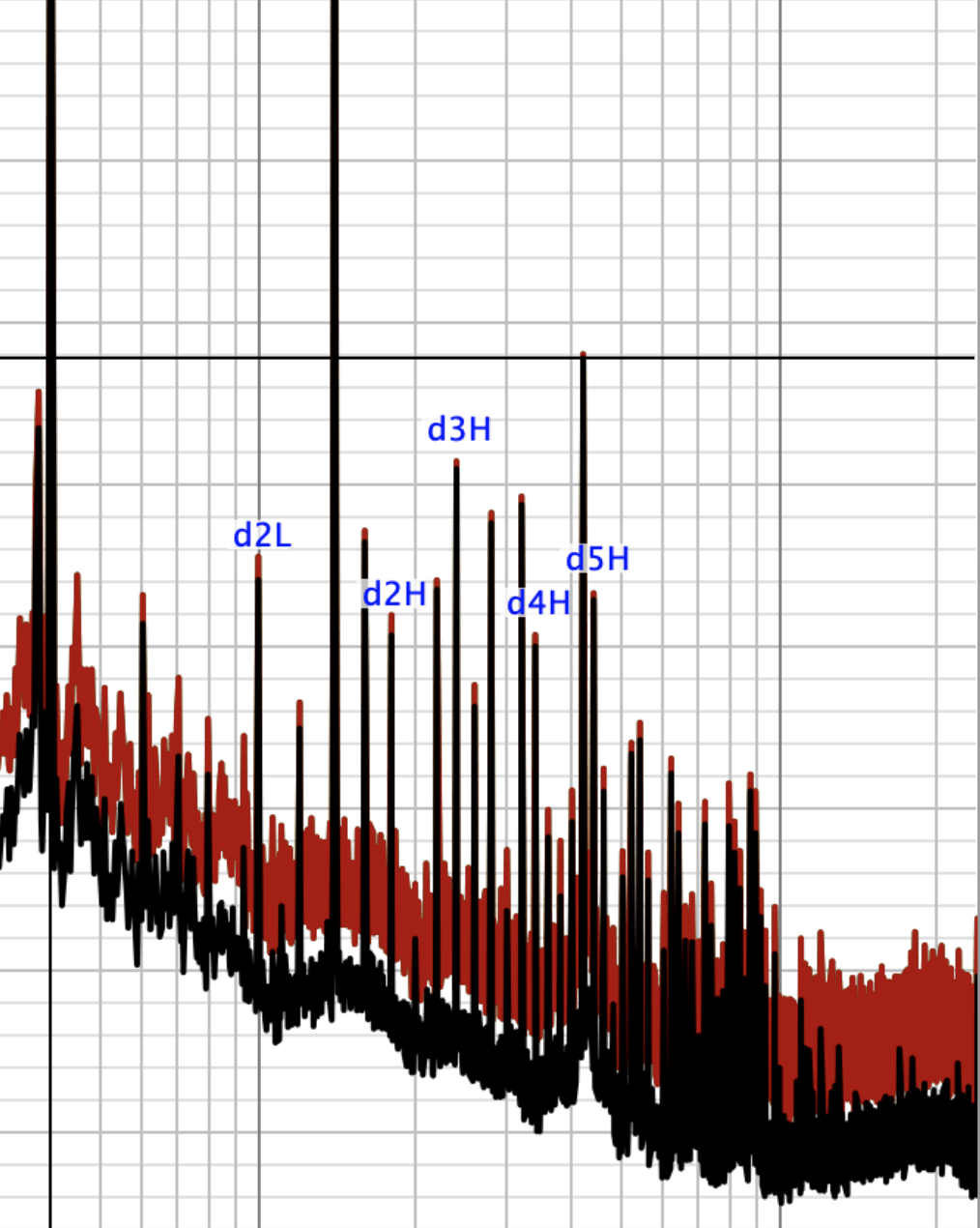

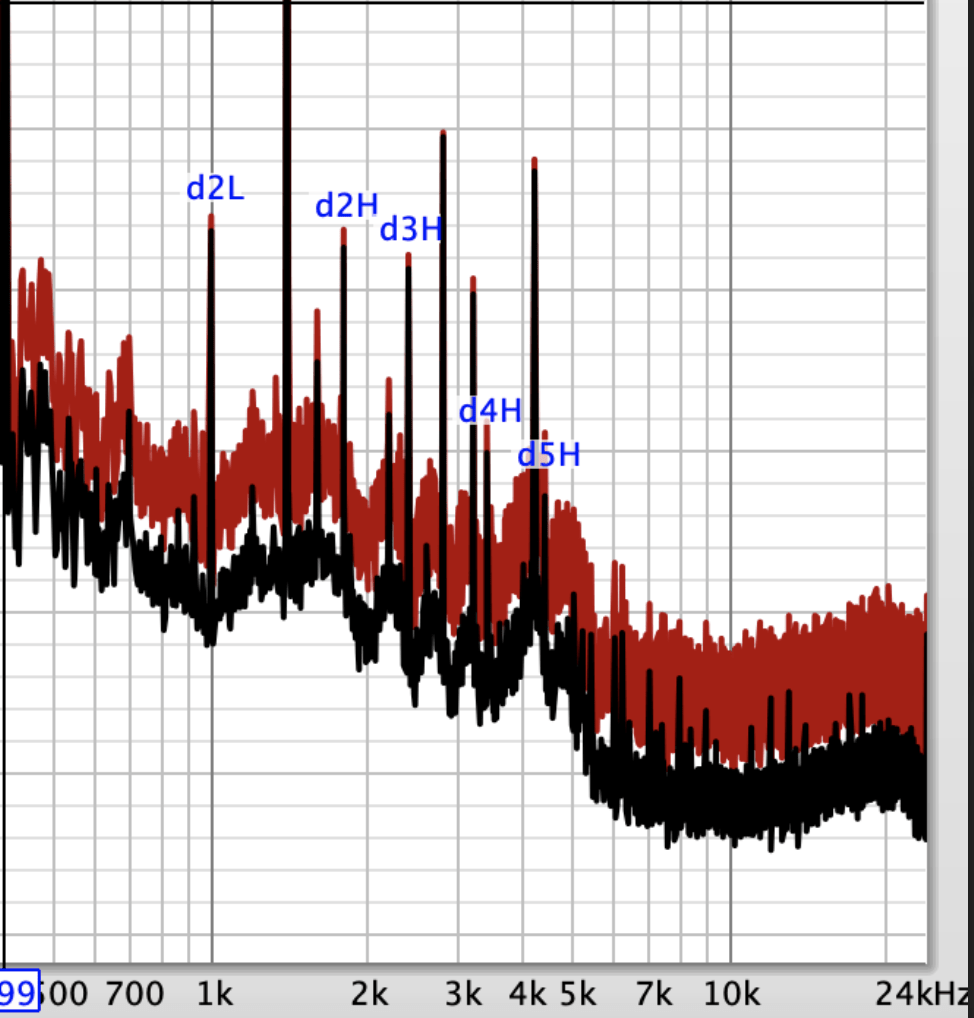

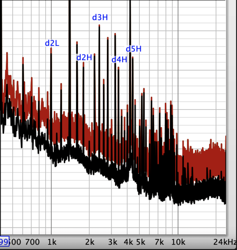

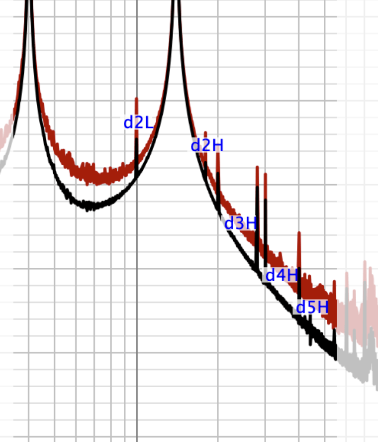

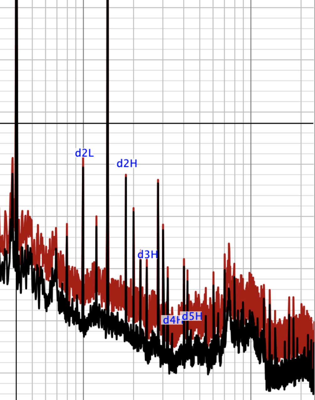

There is something, however, that does not make sense to me with REW's calculation of the IMD: look at image 1 regarding an enlargement of a part of the stage line graph and image 2 regarding the beyma: does it not seem to you that the stage line has a considerable amount more intermodulation bands than the beyma? Moreover, these bands are of significantly greater amplitude. This fact would not seem to emerge from the IMD % provided by REW. Do you have any suggestions?

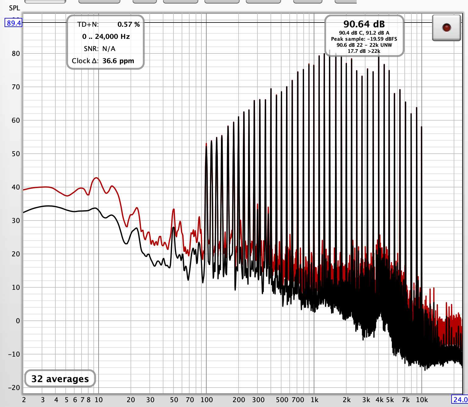

This phenomenon occurs in the same way in full-band measurements. It is very obvious. At a qualitative investigation of the full-band missures it would appear that the stage line is definitely more affected by intermodulation bands, followed by the PHL while the other three behave about equally well. This would be perfectly in line with my listening sensations. Any thoughts?

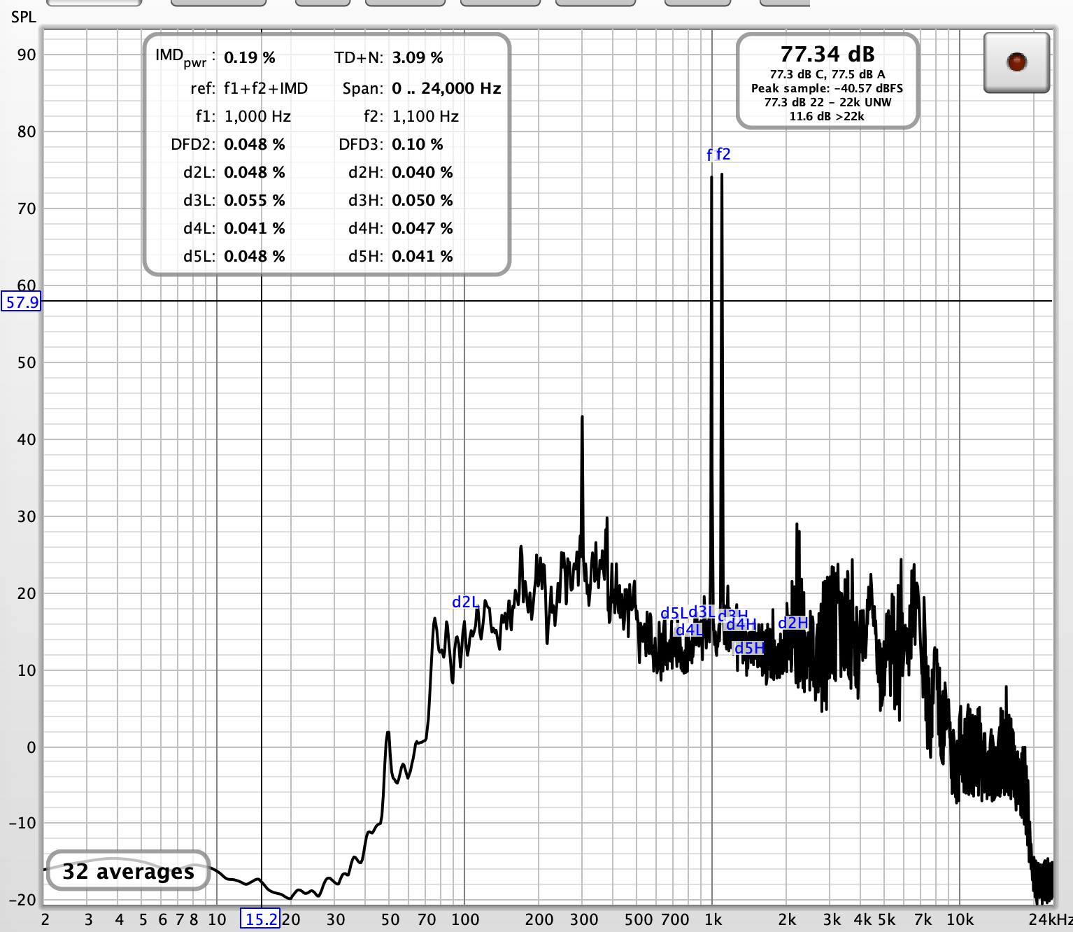

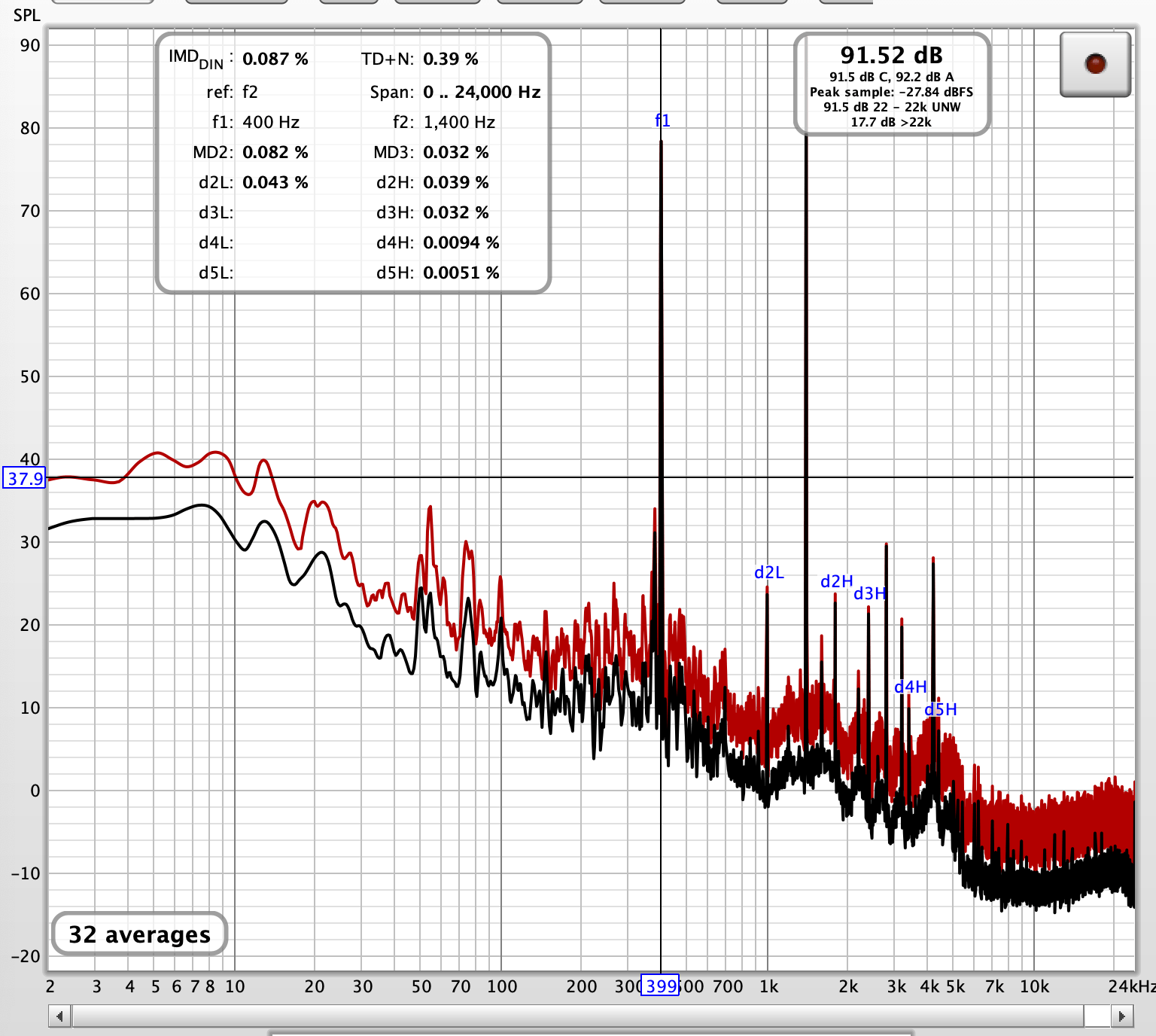

Here some dual tone 60+1000Hz IMD measurement of a two very good mid woofer for a comparison.
https://www-justdiyit-com.translate..._sl=fr&_x_tr_tl=en&_x_tr_hl=sv&_x_tr_pto=wapp
Keep in mind that different parameters and different software were used so the measurements are not really comparable, nevertheless the measured IMD is almost 10 times that of the best of these midranges.

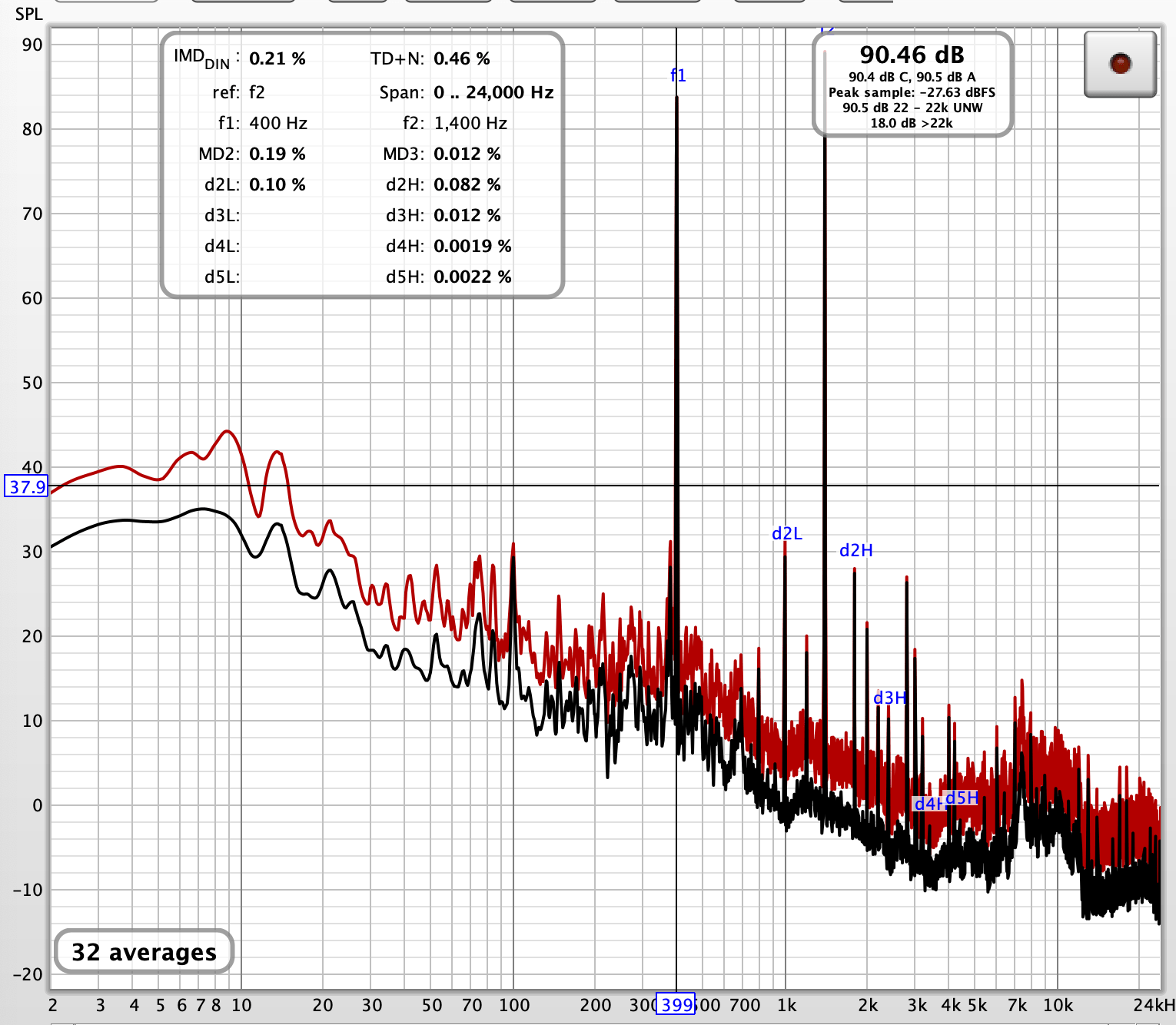

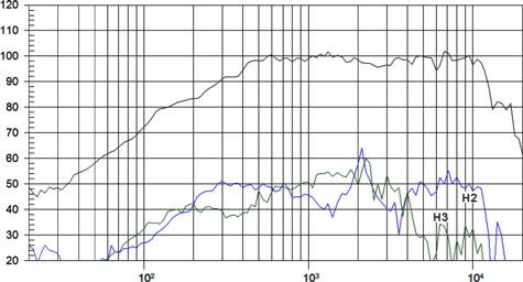

I don't see that 2k peak on your measurements :
Found on https://www.usspeaker.com/beyma 6mcf200nd-1.htm
Thank you for your measurements. Would love to read more opinions about some experts here about this driver 🙂
You are right!!! I was worried about that peak where the third harmonic overtook the second. I tried redoing the measurement several times but it doesn't show up in any of them. On closer inspection there is an increase in the second harmonic between 1000 and 2000Hz but no increase in the third harmonic. In addition, the peak I see barely exceeds 0.2 percent while the one you see on Beyma's site barely exceeds 1 percent. Conversely, the breakup in my measurements creates a much worse distortion peak than in the manufacturer's measurements. Also the frequency response is different but this is due to the lack of baffle in my measurement.
I do not have extensive experience in measurements, however I have read in some posts that often the measurements made with ARTA and with REW are quite different from each other, I guess the same thing happens with Kippel. I here used REW installed on a MacBook Pro, Minidsp umik1 with its calibration, class D amplifier based on IRS2092 (Wondom).
If any experts would like to give us an opinion it would be very interesting.

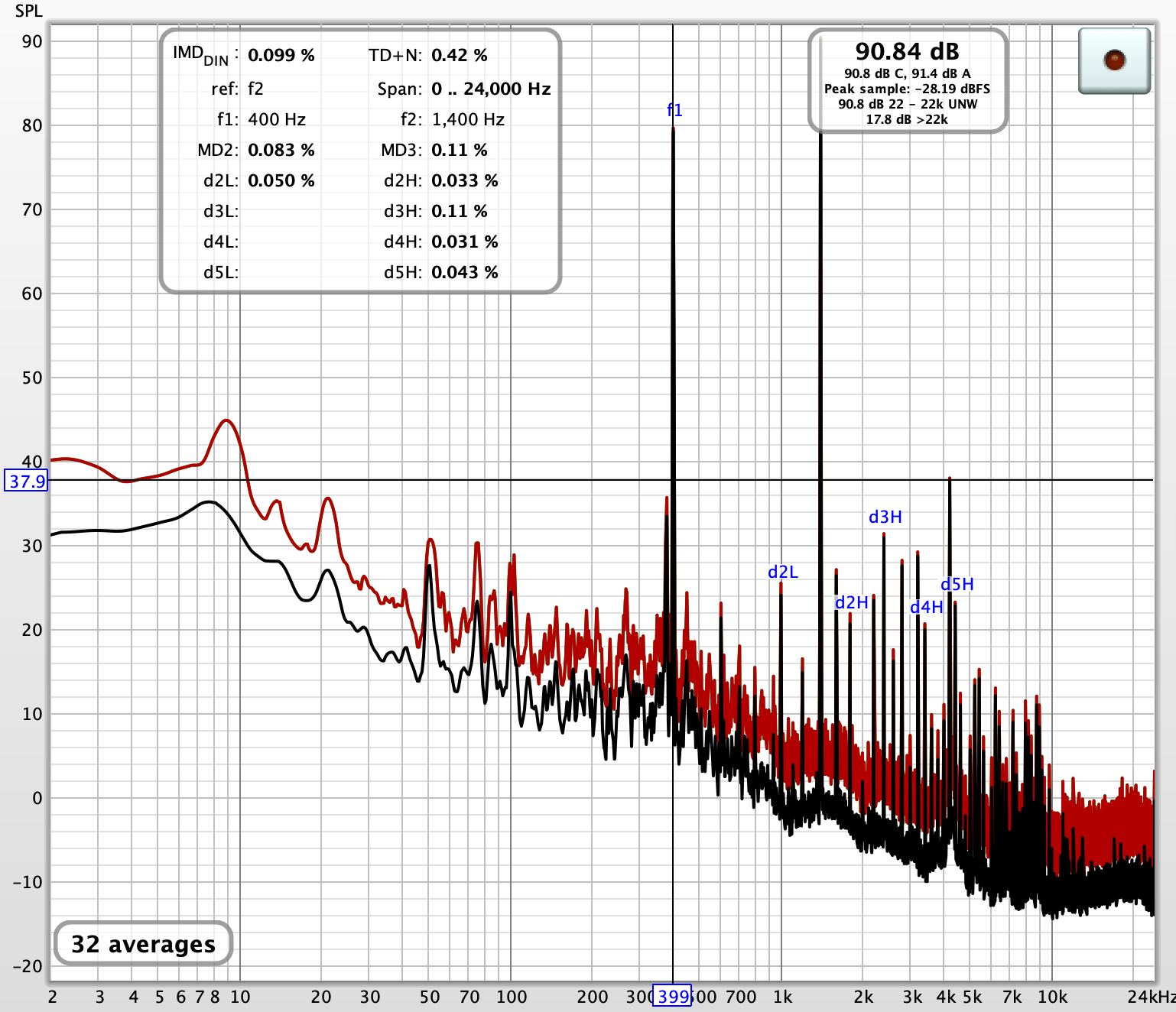

To have a comparison with measurements made by other experts I replied the dual tone IMD showed here
for a couple of well regarded mid woofer.
Here the results
Here the results

Hi Mark, I used averaging only in the IMD measures. The first measurements were done in a 6x7m room, REW, UMIK1 posited on axis 10cm from the driver. No average, 1M sweep lenght, 5ms window.
These measurements were made to compare some midranges with each other under the same conditions, not to obtain measurements whose frequency response is comparable with measurements made by others. Within this view they should be considered. The moment I can redo them with a baffle or a closed box I will do so but at the moment I am not atequipped to do so.
From what do you infer that my first measurements (which ones in particular?) are noisy? I didn't realize it but I am always interested in learning how to improve my measurements.
