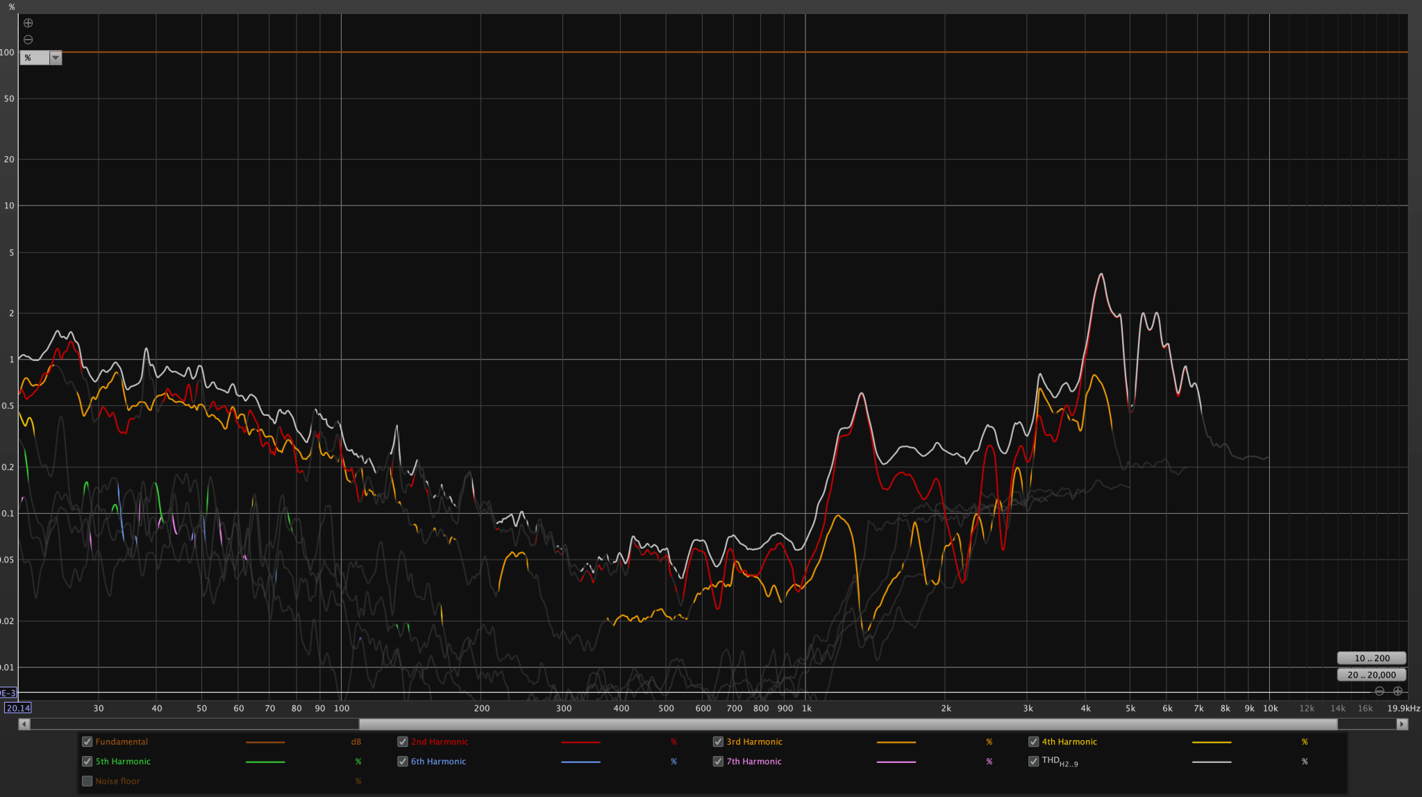

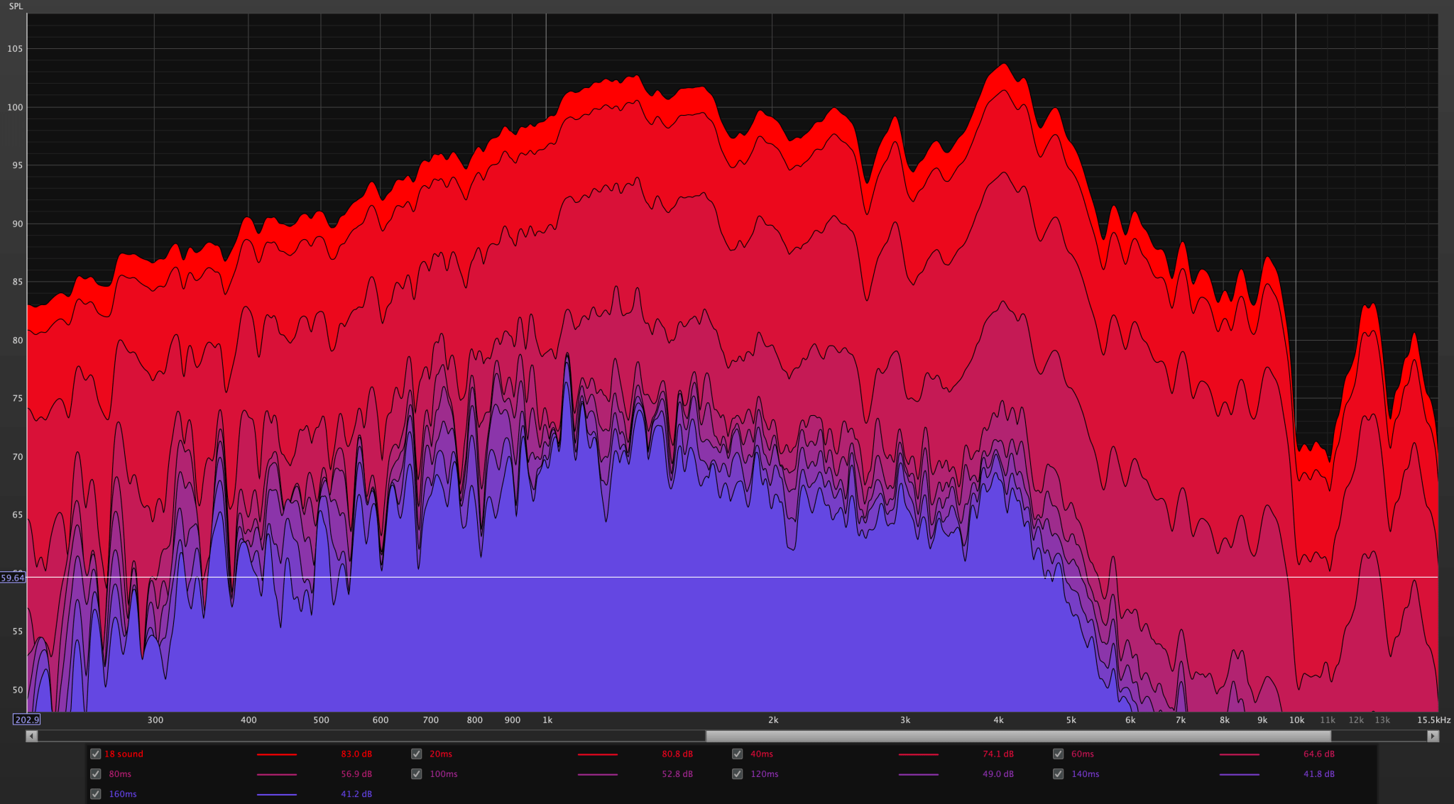

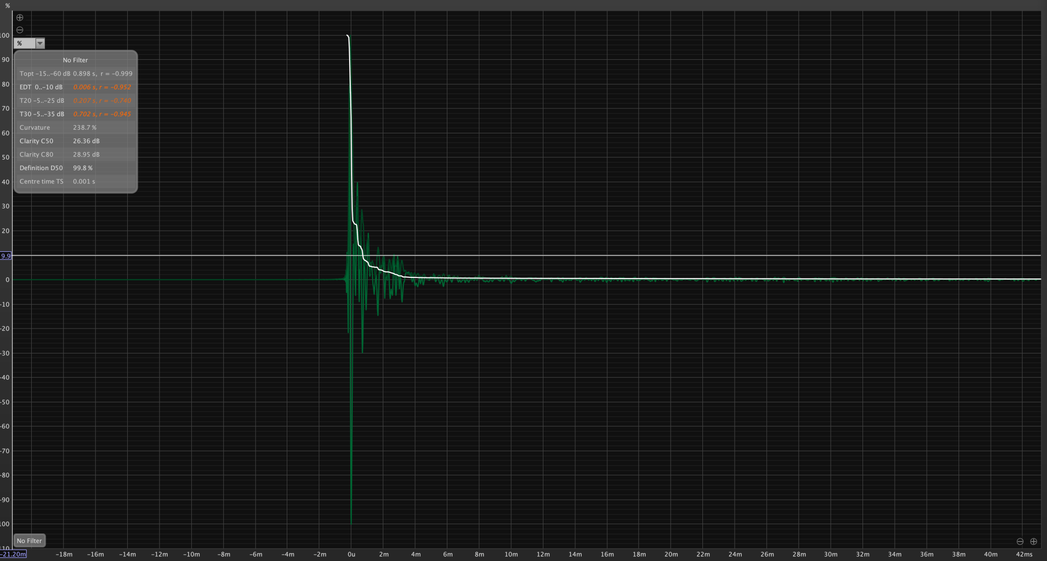

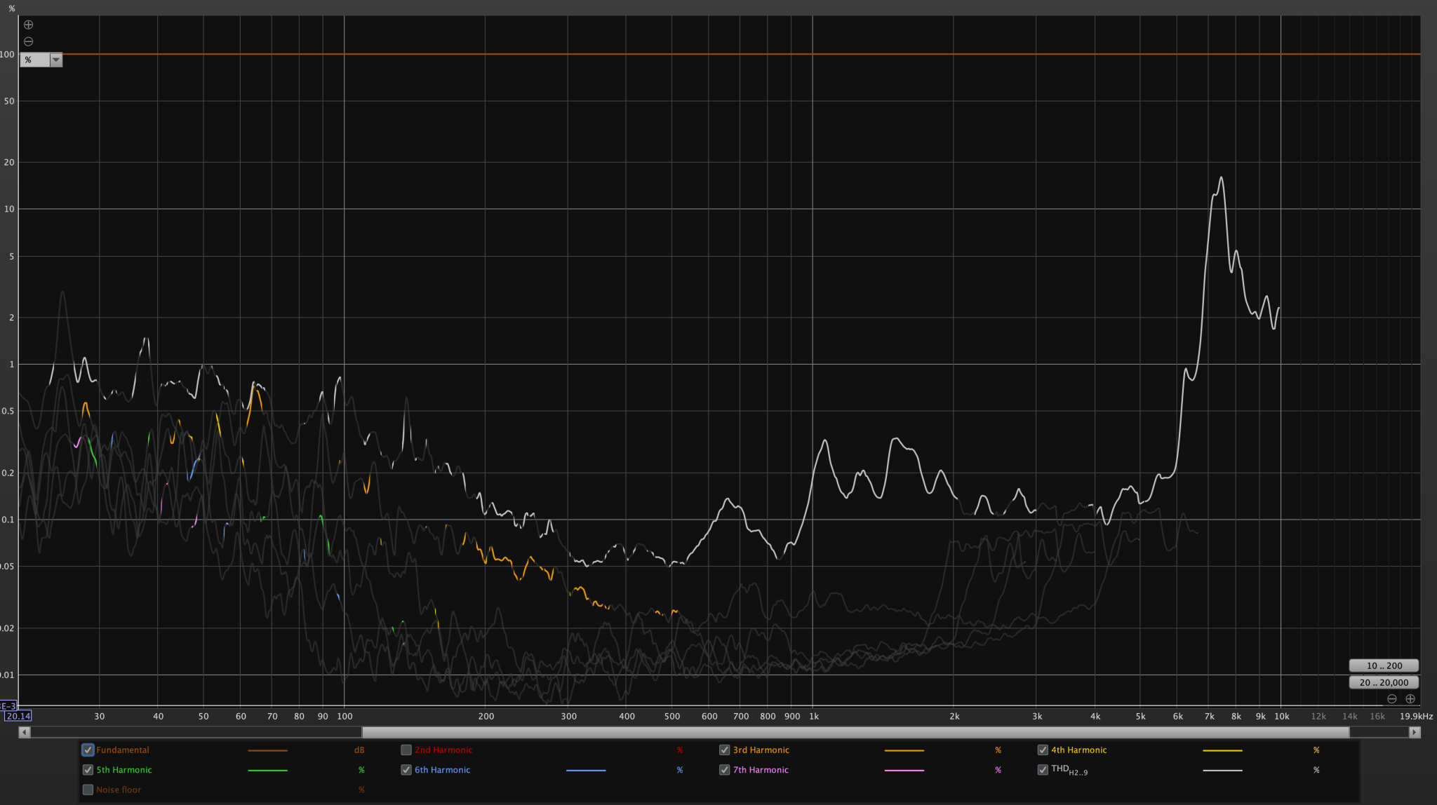

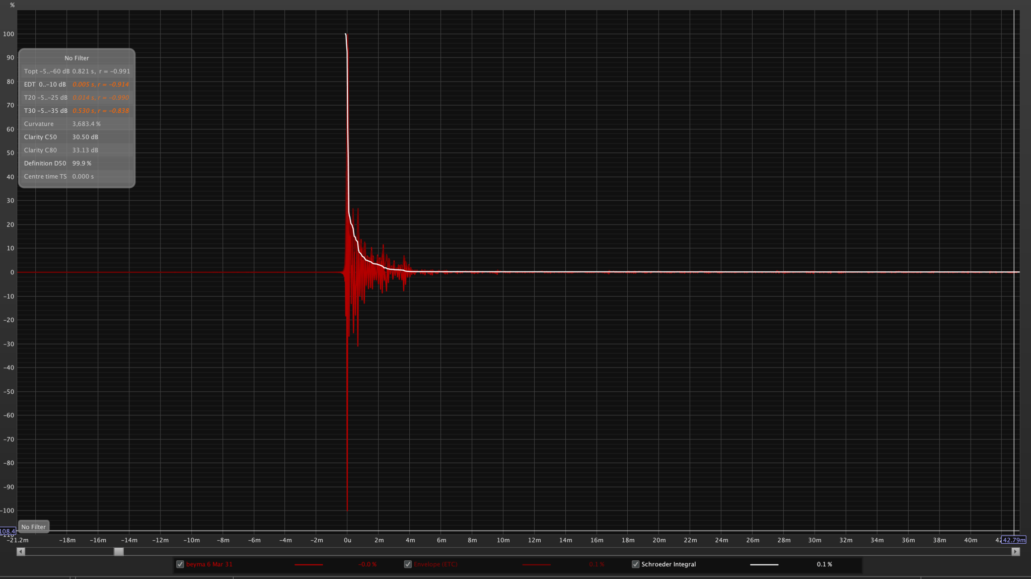

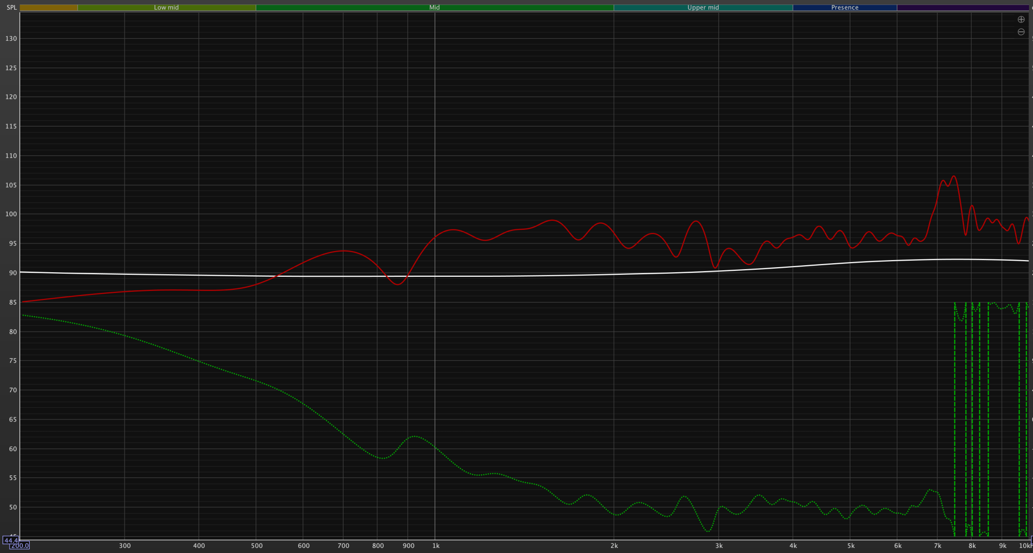

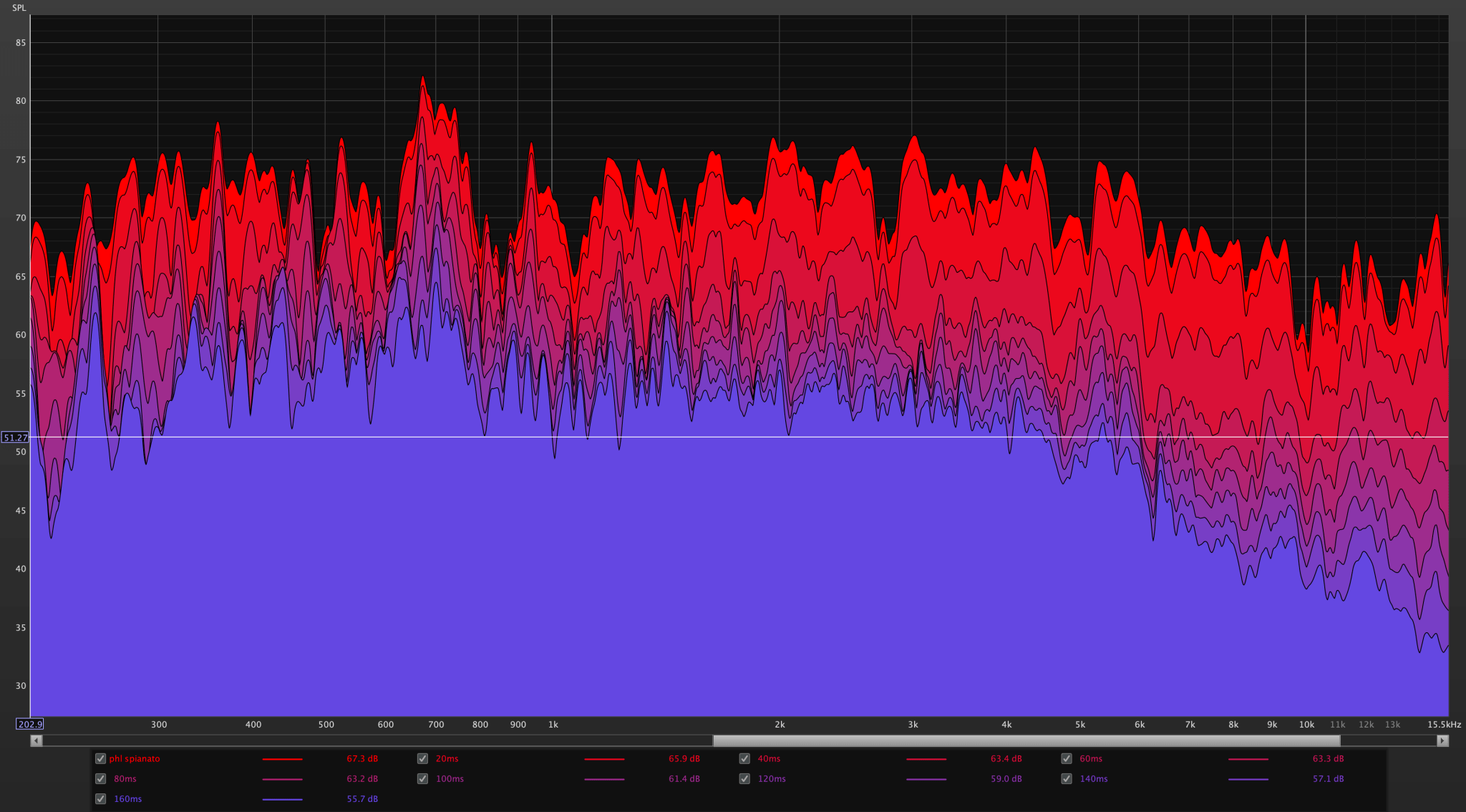

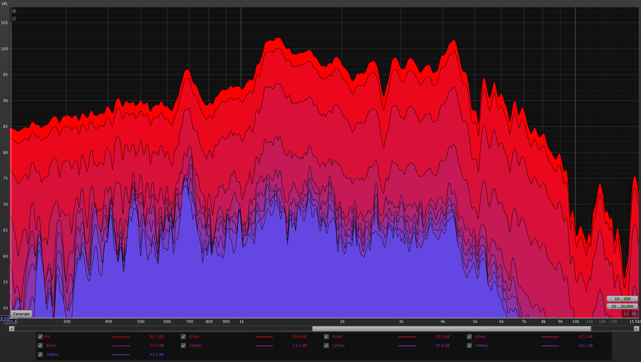

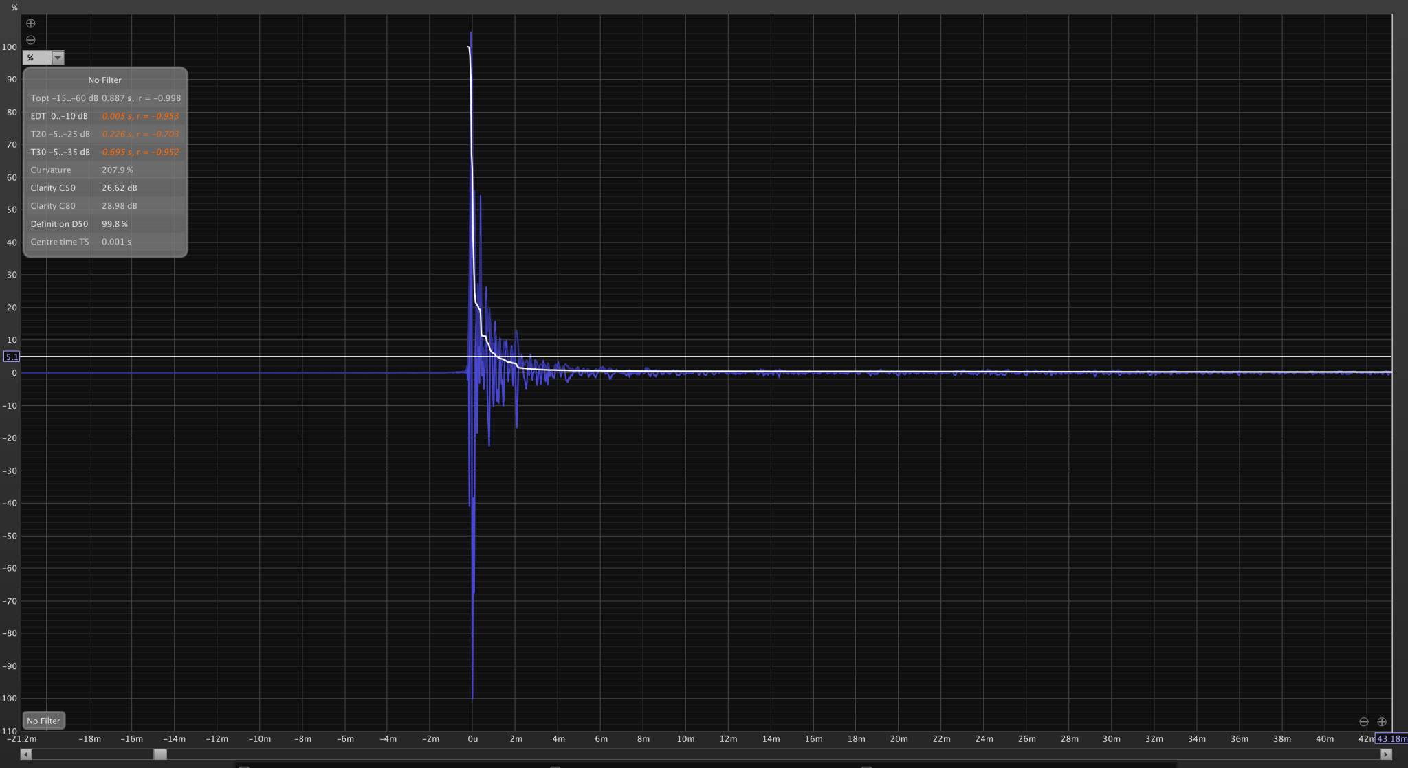

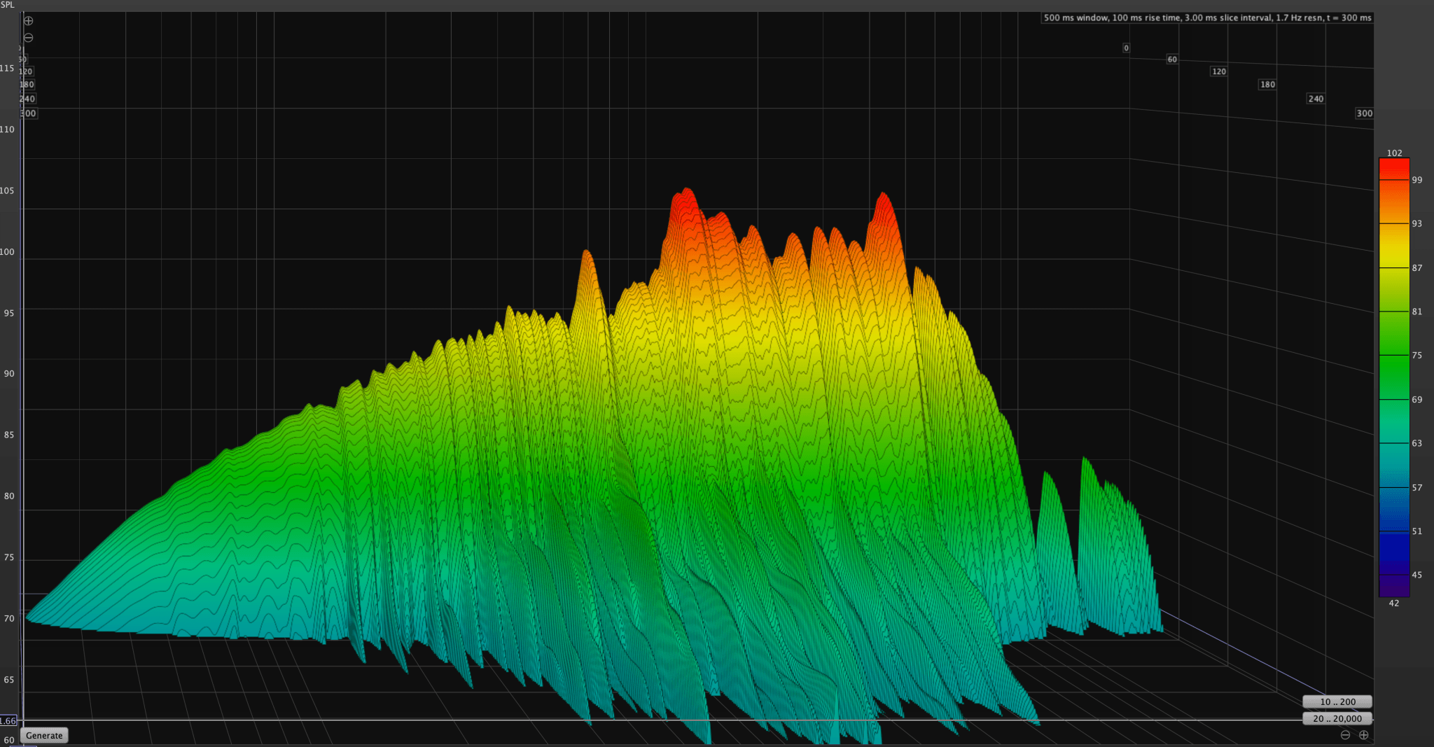

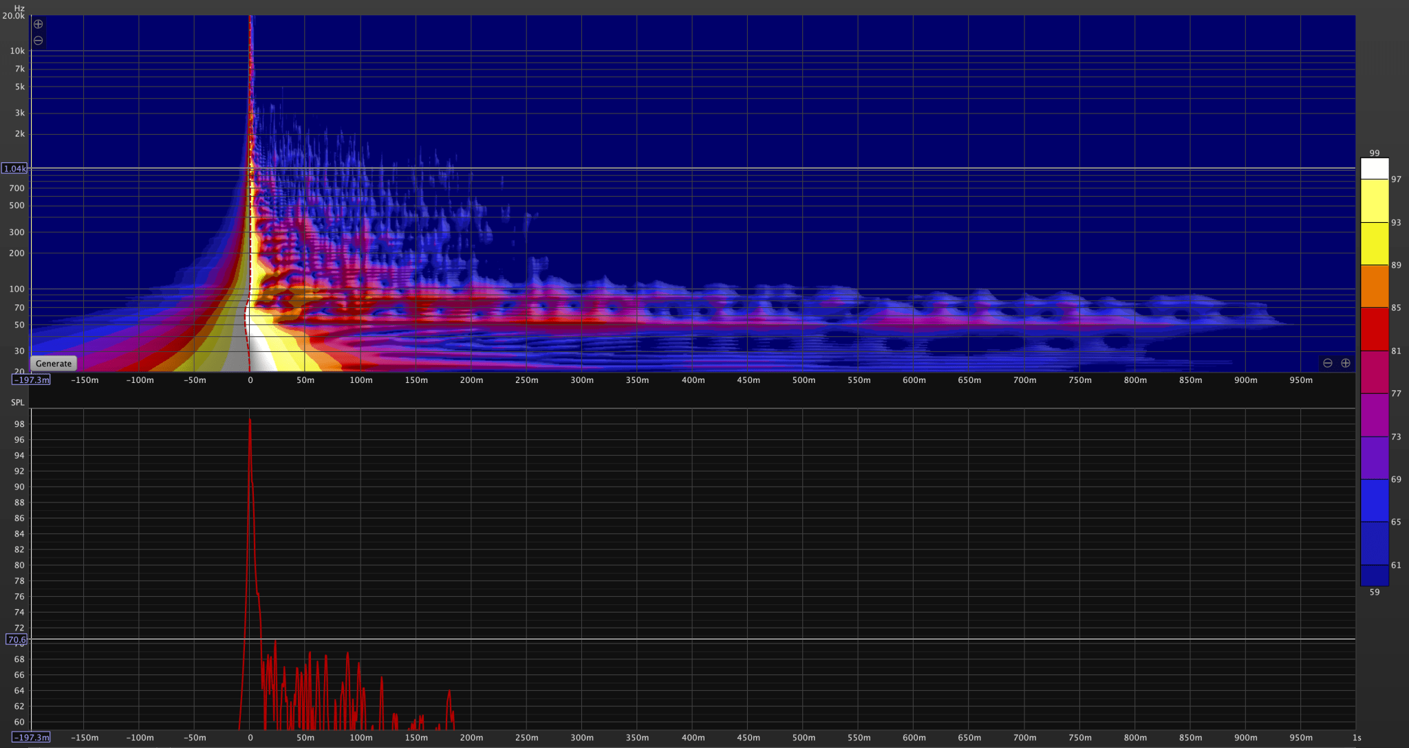

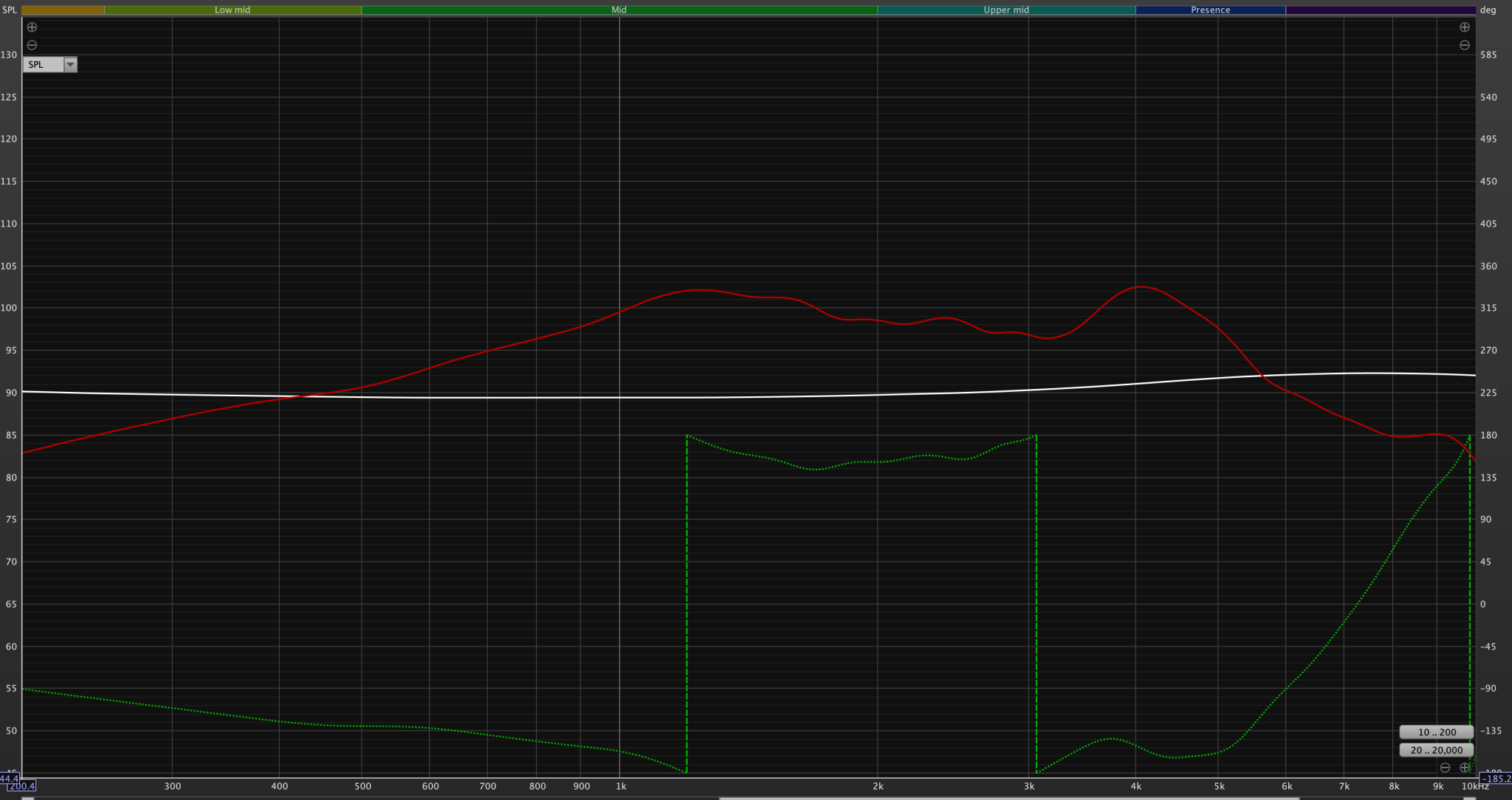

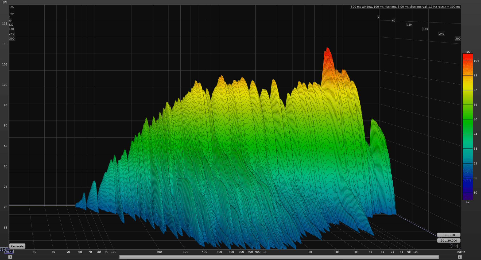

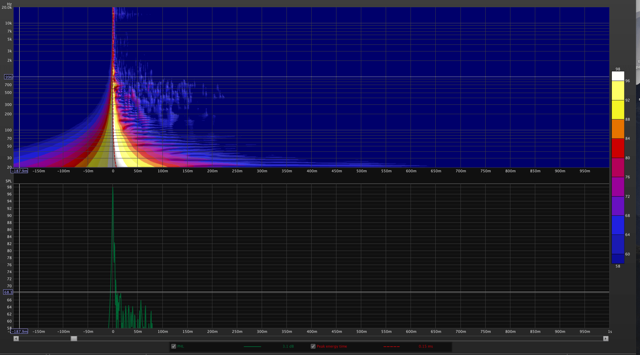

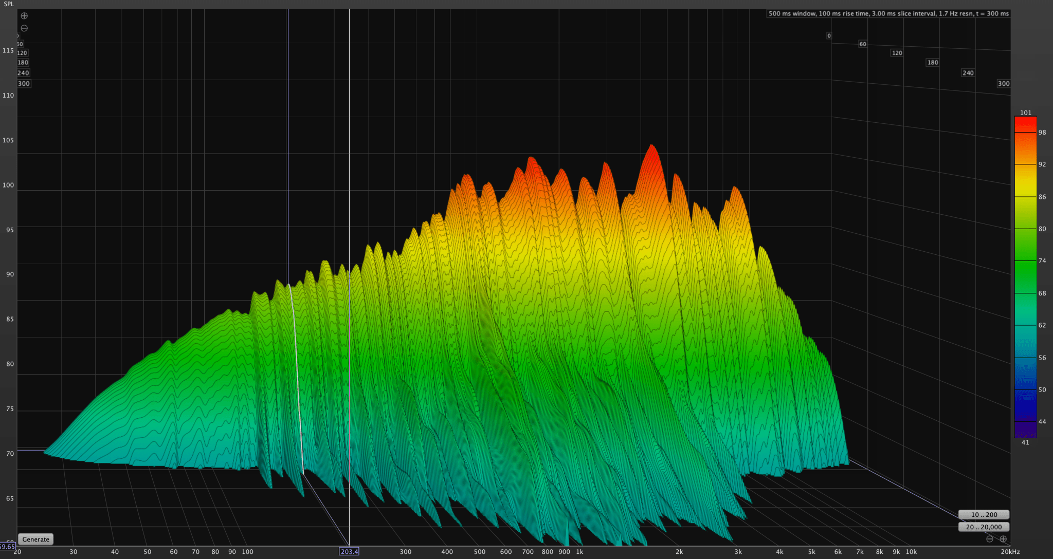

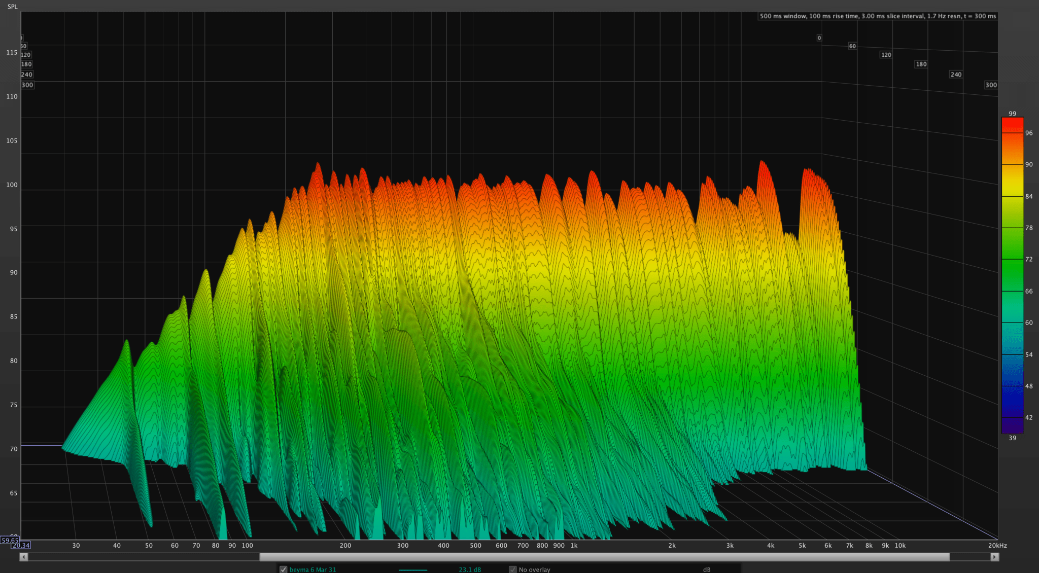

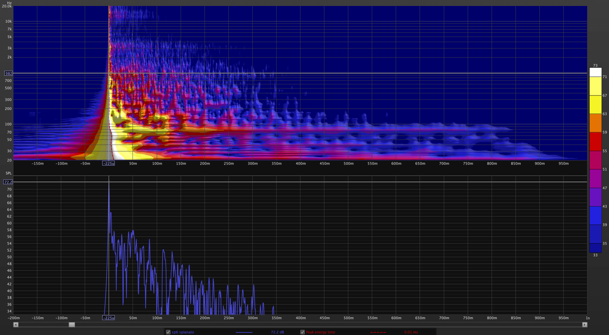

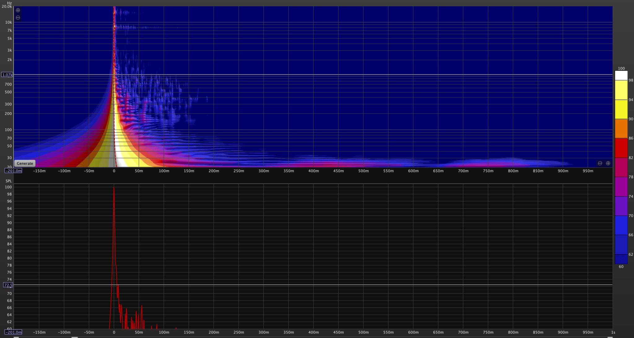

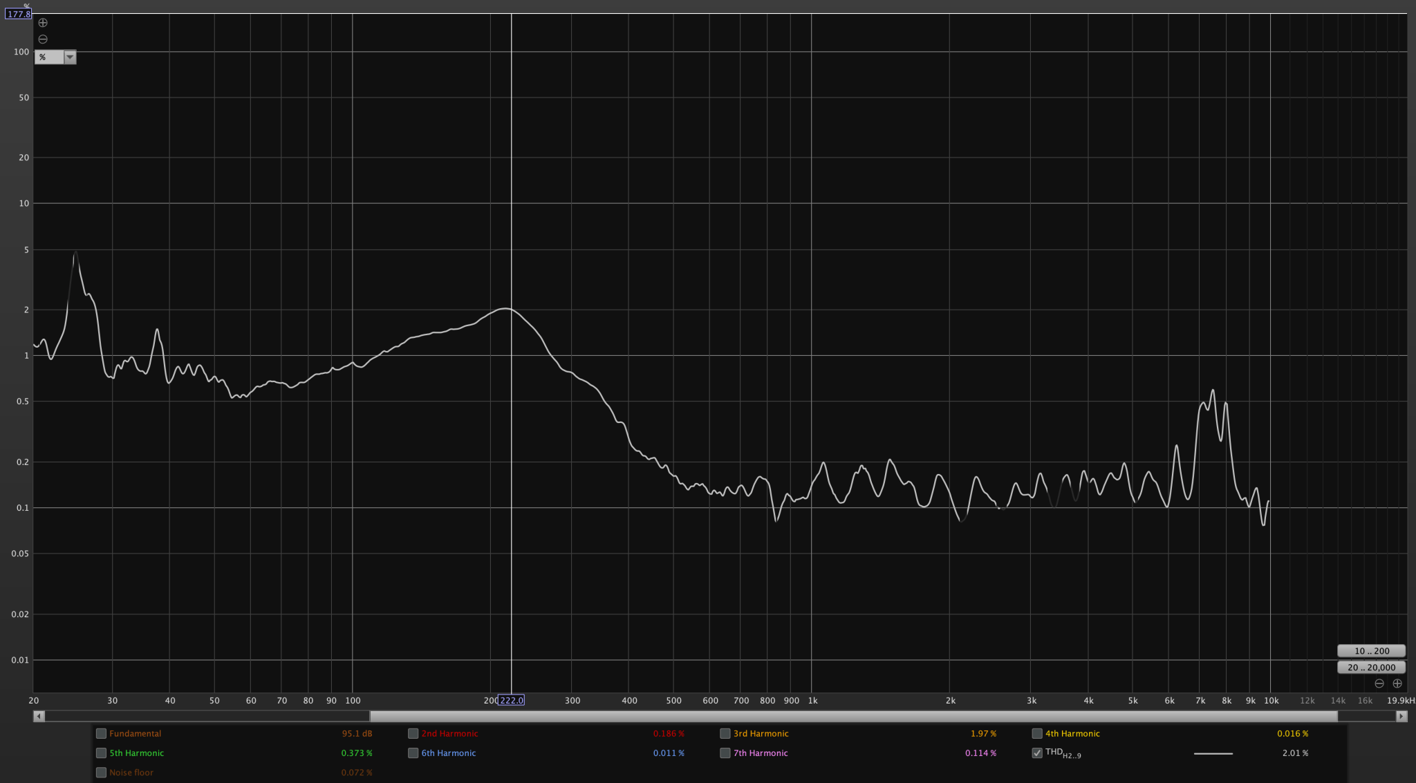

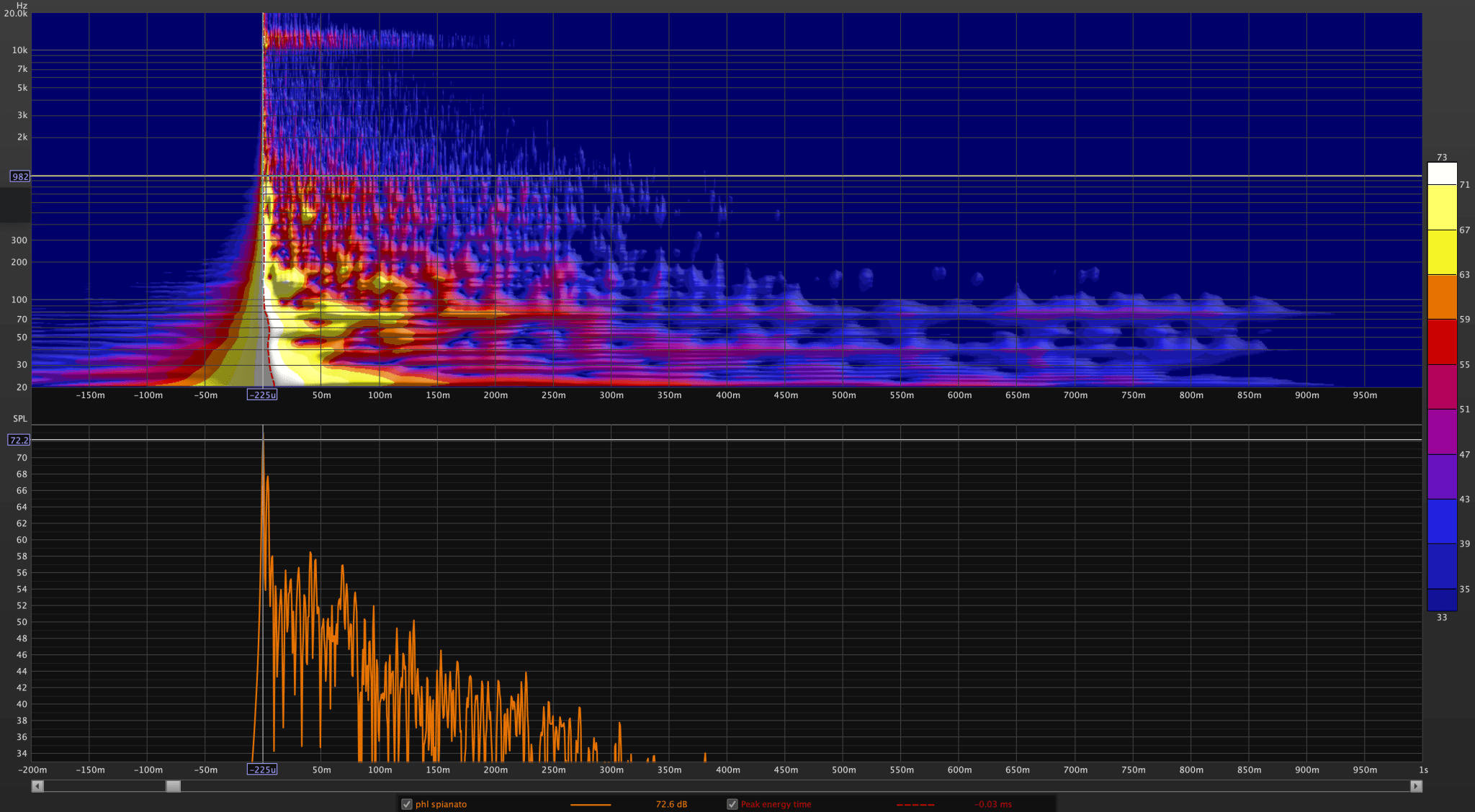

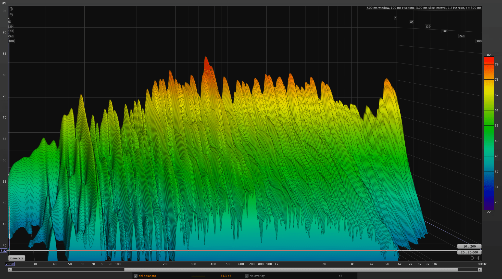

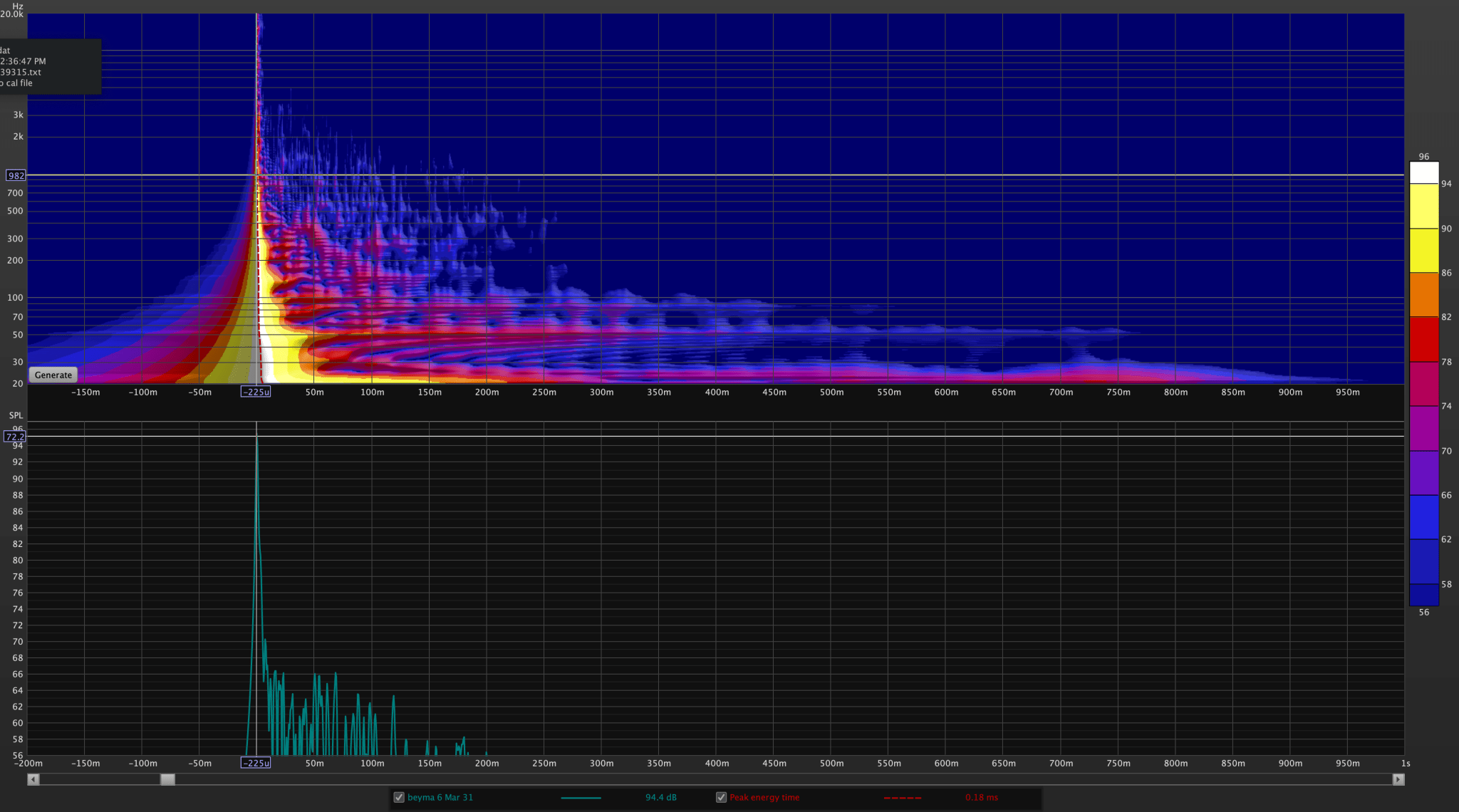

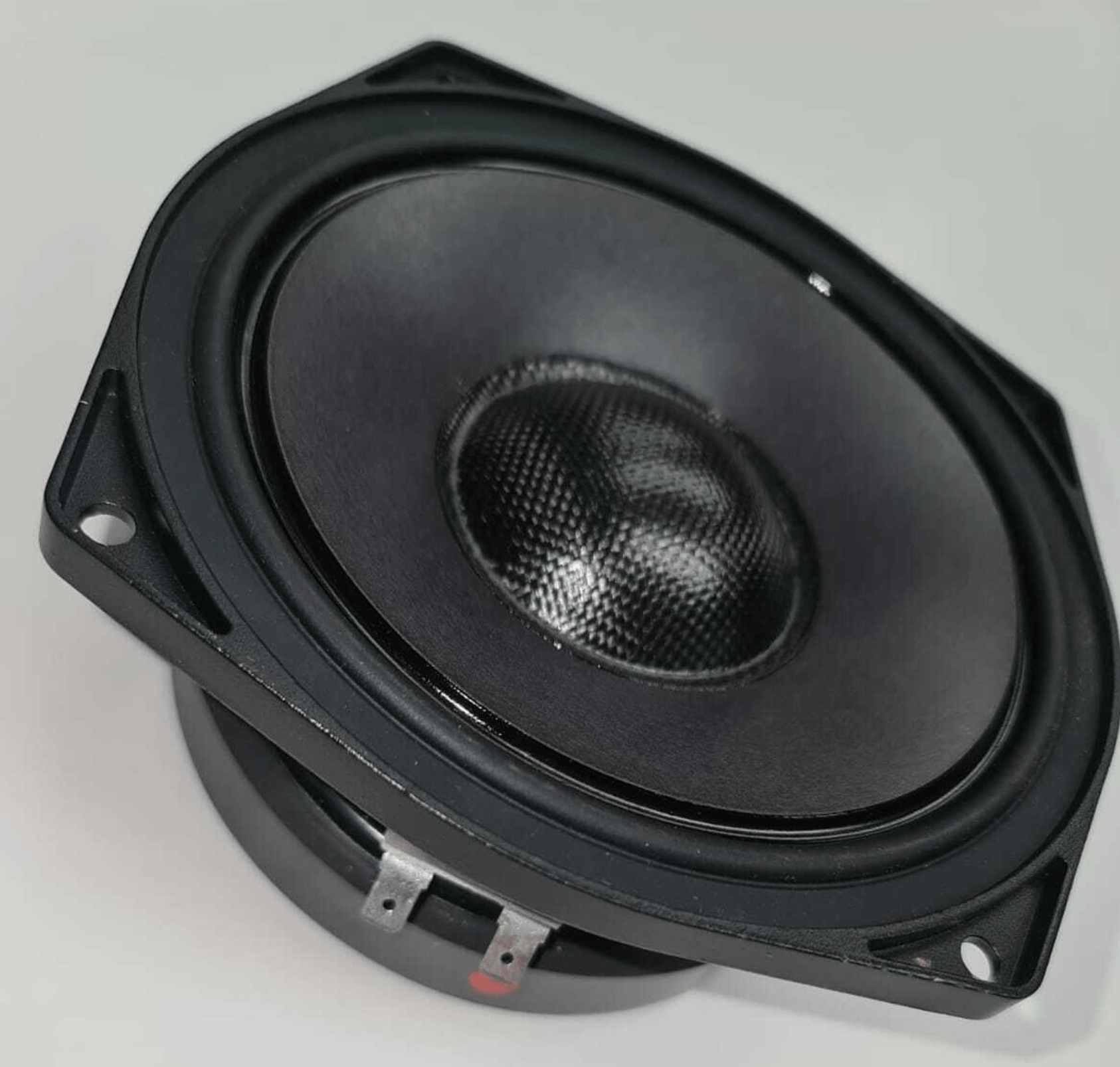

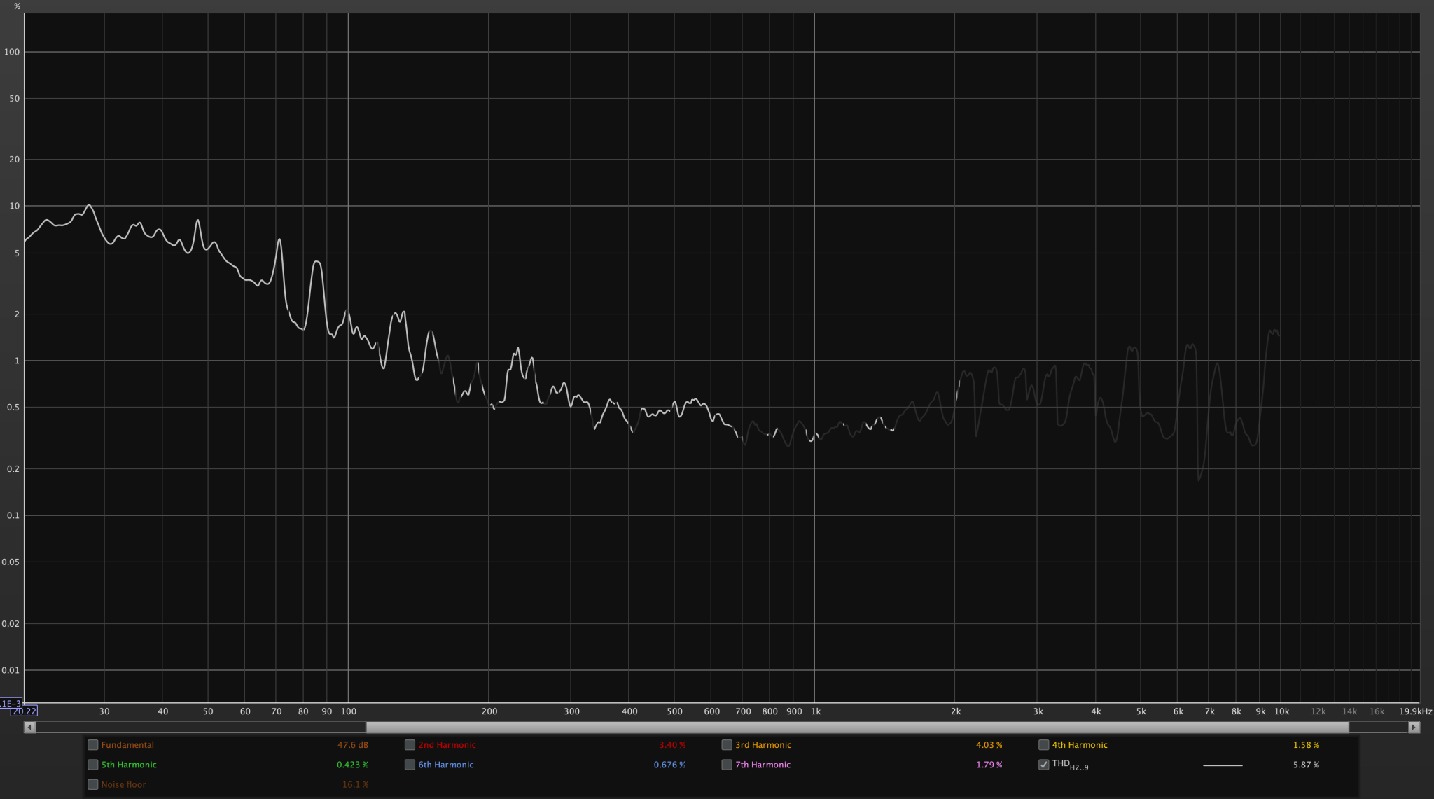

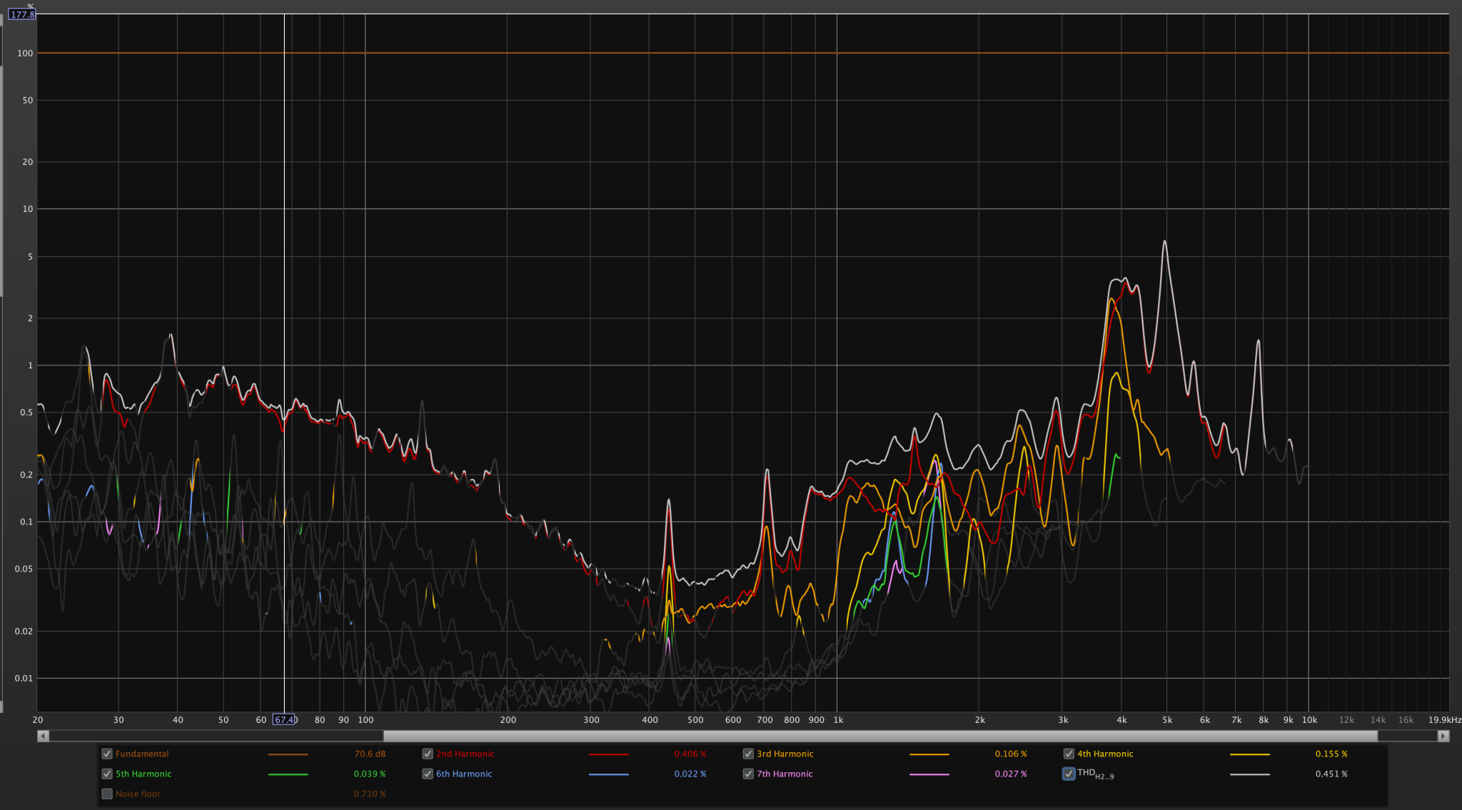

Hello everyone,

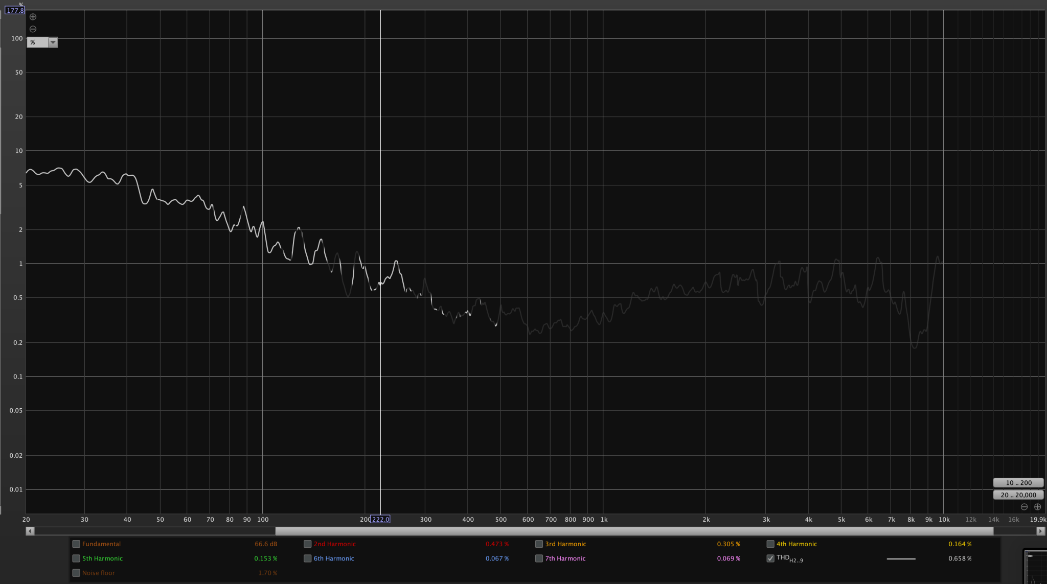

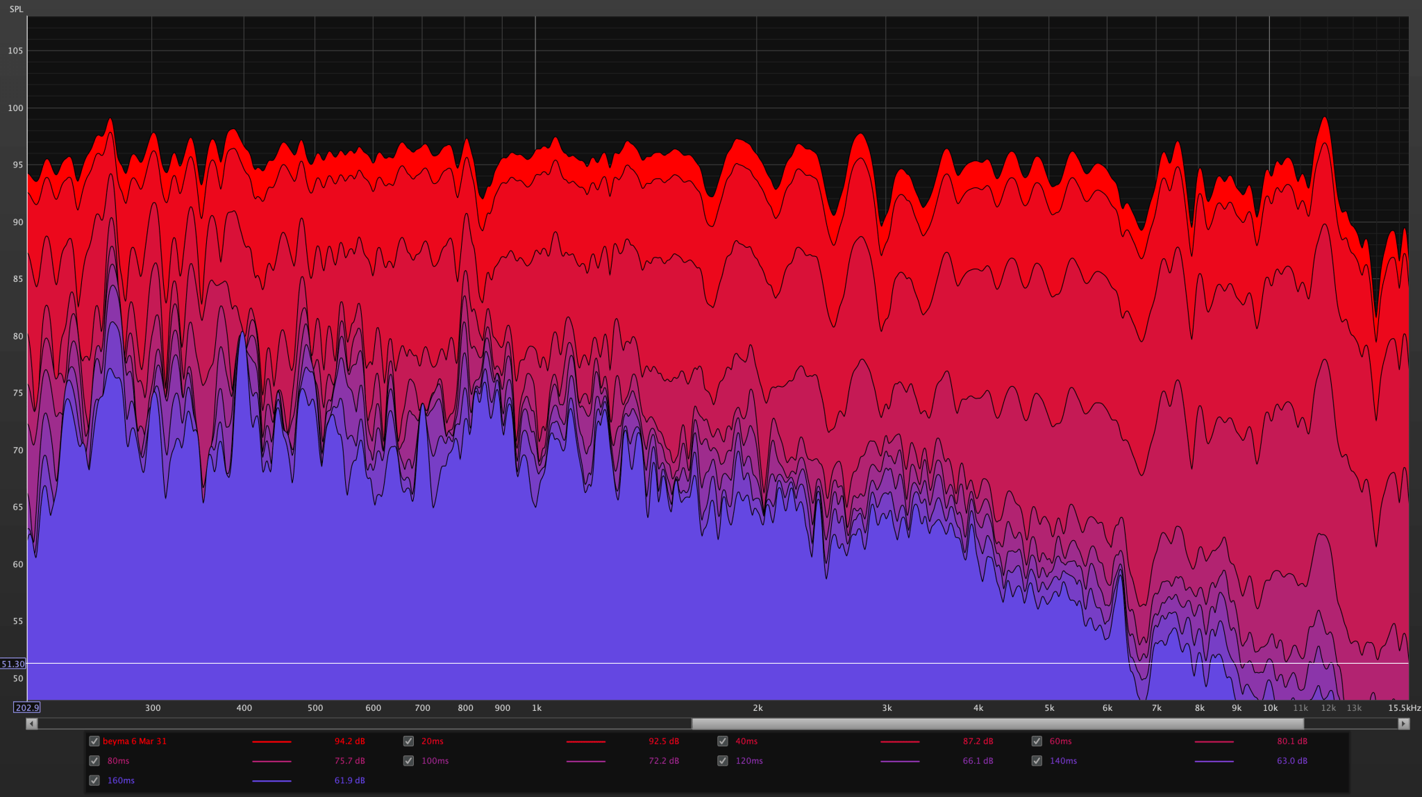

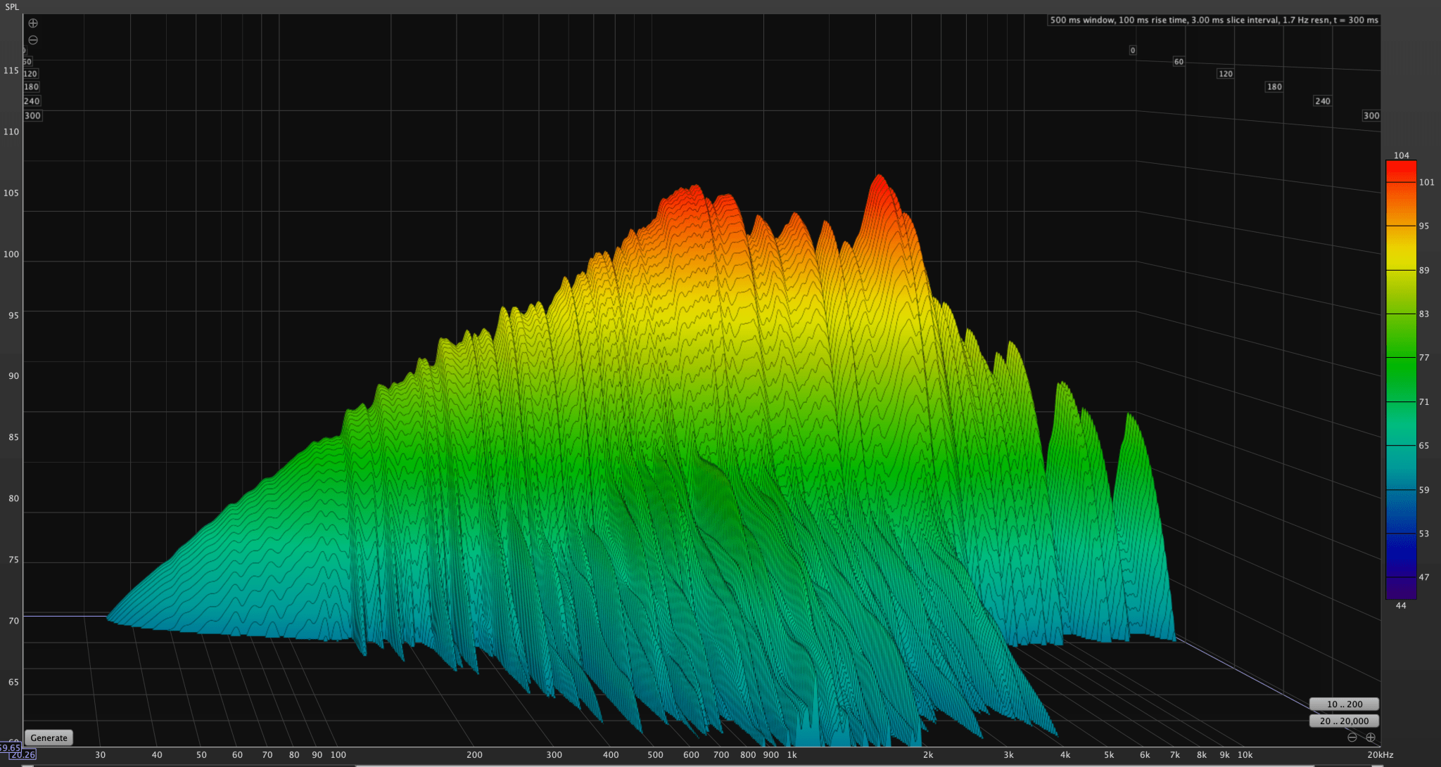

Since I think this is a midrange driver of absolute interest, I'll post some measurements I made on the same. Free air 10cm, 90db, 1/48 smoothing. As soon as I can, I'll post another speaker as well so I have a comparison term.
Listening, the Beyma is very detailed, open and, when cut before breaking up, despite its carbon diaphragm, it does not seem to show remnants of such breaking up with great clarity, as is often seen in speakers with diaphragms made of aluminum, for example.
Compared to other midrange speakers (both professional and hi-fi), this is currently the best sounding one I have heard.

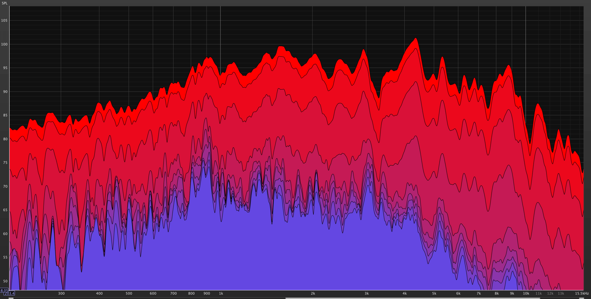

18 sound 6nd410, another well regarded and subjectively very well sounding midrange. Subjectively sounding almost on pair with the beyma, except for the different timbre given the different material of the cone.

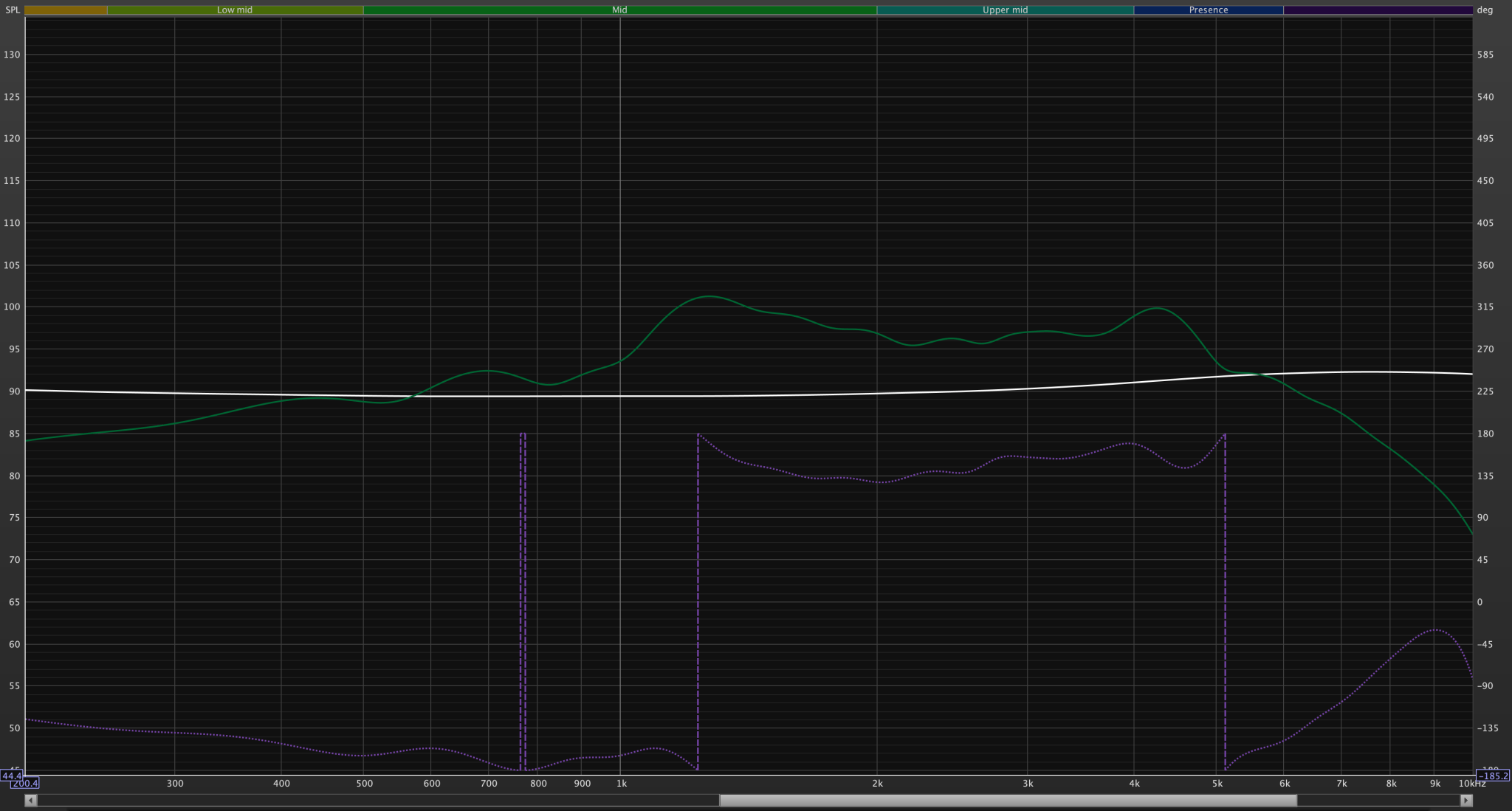

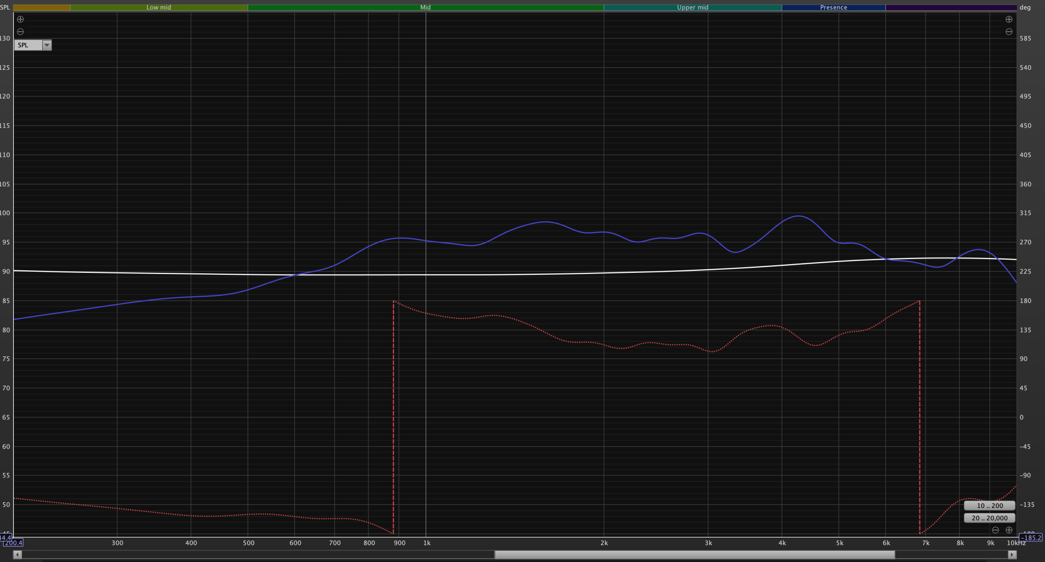

These measures are naked, without any EQ. Note that only all except the beyma (that has a closed back) are free air, baffle lessHi, are you evaluating them equalized for same response, or just naked without any equalization?

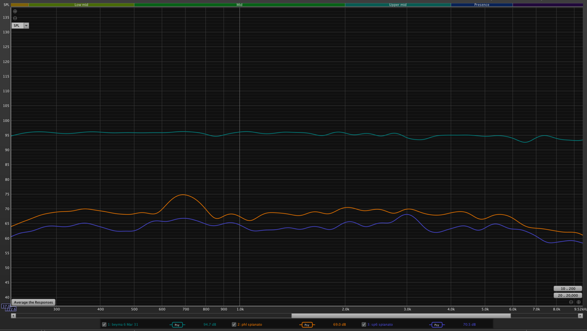

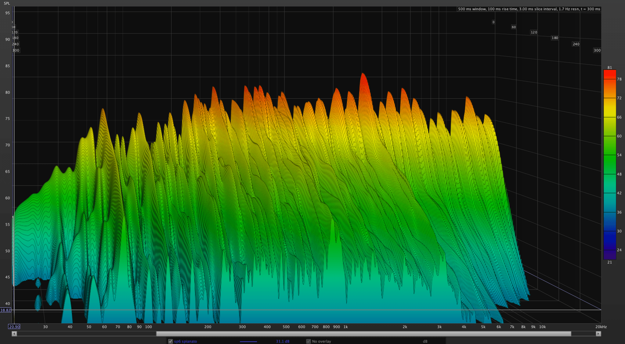

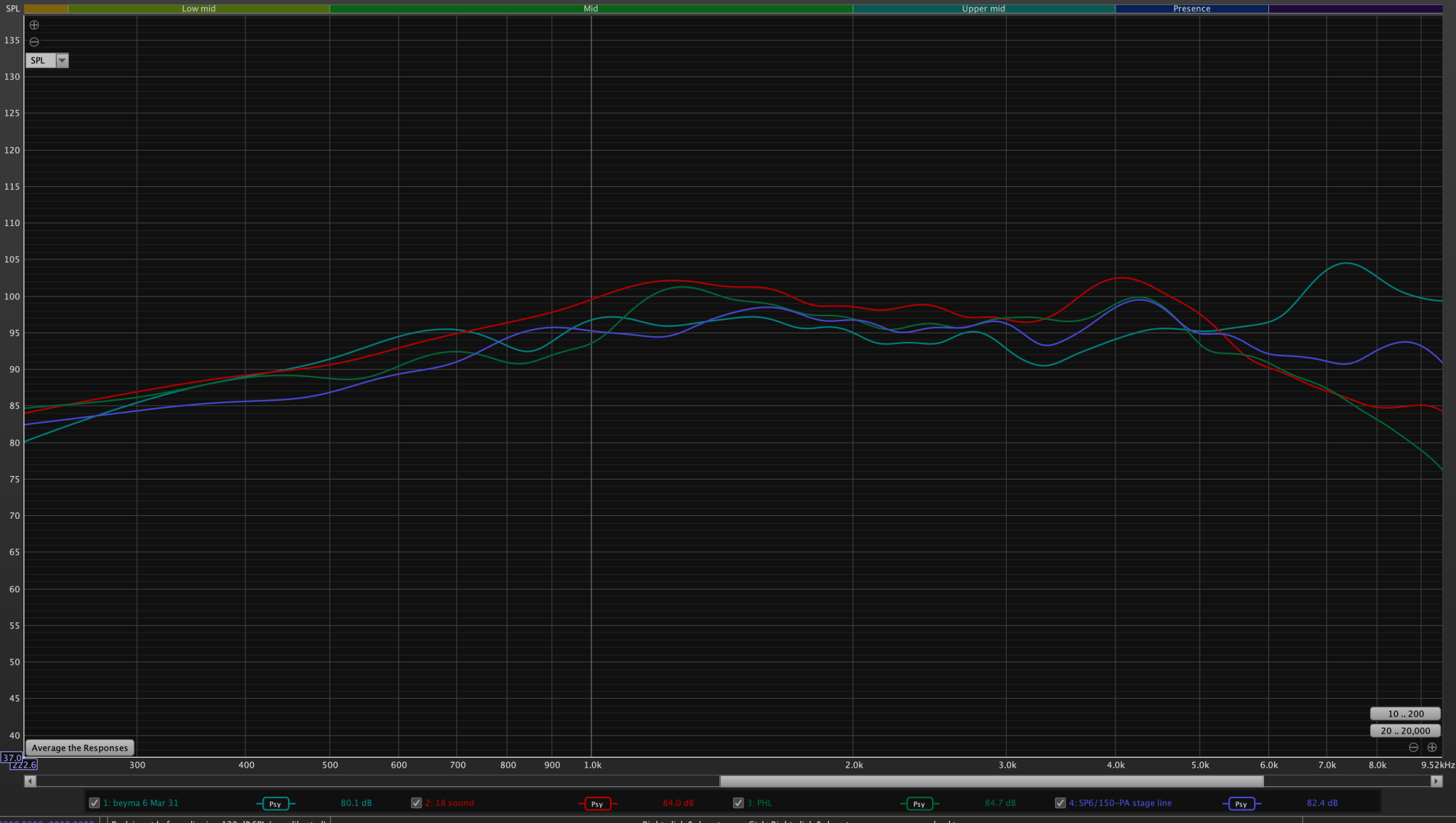

Some measures with reasonably equalized drivers. The figures are in this order: 1) beyma, 2) PHL, 3) stage line. No 18 sound unfortunately. All measured at 2m, 90db. Pseudoanecoical measures in a small room at 2m distance... so take these last measures "cum grano salis". The idea was to listen to the EQed drivers not to measure them. Nonetheless these measures can help reasoning about these mid. As you can see the beyma keep a much cleaner decay with much less stored energy.

Subjective listening to the equalized drivers (my subjective opinion only, mind you) revealed that the Beyma and the 18 sound the most pleasant, the Beyma more detailed and minimally more neutral and the 18 with the more typical paper cone sound (very pleasant, though in my opinion less pleasant than the Beyma, but that's a matter of taste). Detached from the first two, the PHL still sound very detailed, but with a less pleasant note that I still do not know what it is (it was the only one that was ever not broken in). Finally, the Stage Line was darker and less detailed.
I find it interesting that a midrange like the Beyma, born to sound loud, can be both pleasant and pleasantly HiFi (ie HiFi for those who like high efficiency and analytical sounds like those of the TPL 200, which I will use as a tweeter along with the Beyma, with which it harmonizes better than with any other midrange I have heard.

2) on axis
3) no space to do that
4) yes (approximately matched, no scientific comparison or such)
5) ab short switching time (minidsp flex 8 switch from a setting to another)
I know what you mean! The drivers were EQed 200-10000with rew auto eq with only subtracting filters (allowing only spl reduction not increases). The Corrected responses are published. For most of the listening test the drivers were bandpassed 300-3000 BW 48db but not for the measures published that were only EQed but not bandpassed. I have also tried to add a woofer (JBL 2226) and a tweeter (beyma tpl200b) to listen to an ensemble. Obviously in this configuration the differences are more subtle but still audible. The beyma give the best integration to the TPL200. It's a pity that cannot go lower, maybe can be worth the time to give a check to this (https://www.beyma.com/en/products/c/low-mid-frequency/110MCF40ND8/altavoz-10mcf400nd-8-oh/) but although it goes down a little more, it goes up less and has more beaming problems. Nonetheless, a friend told me that it is worth giving it a listen as to liveliness and body. Expensive though!I don't understand, Sorry

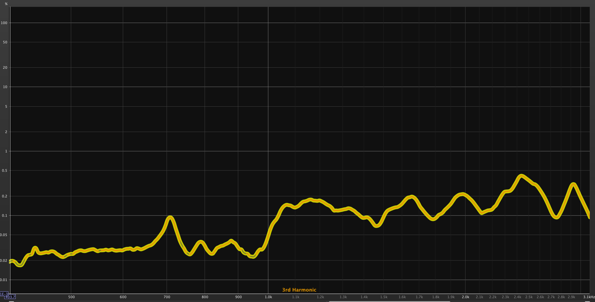

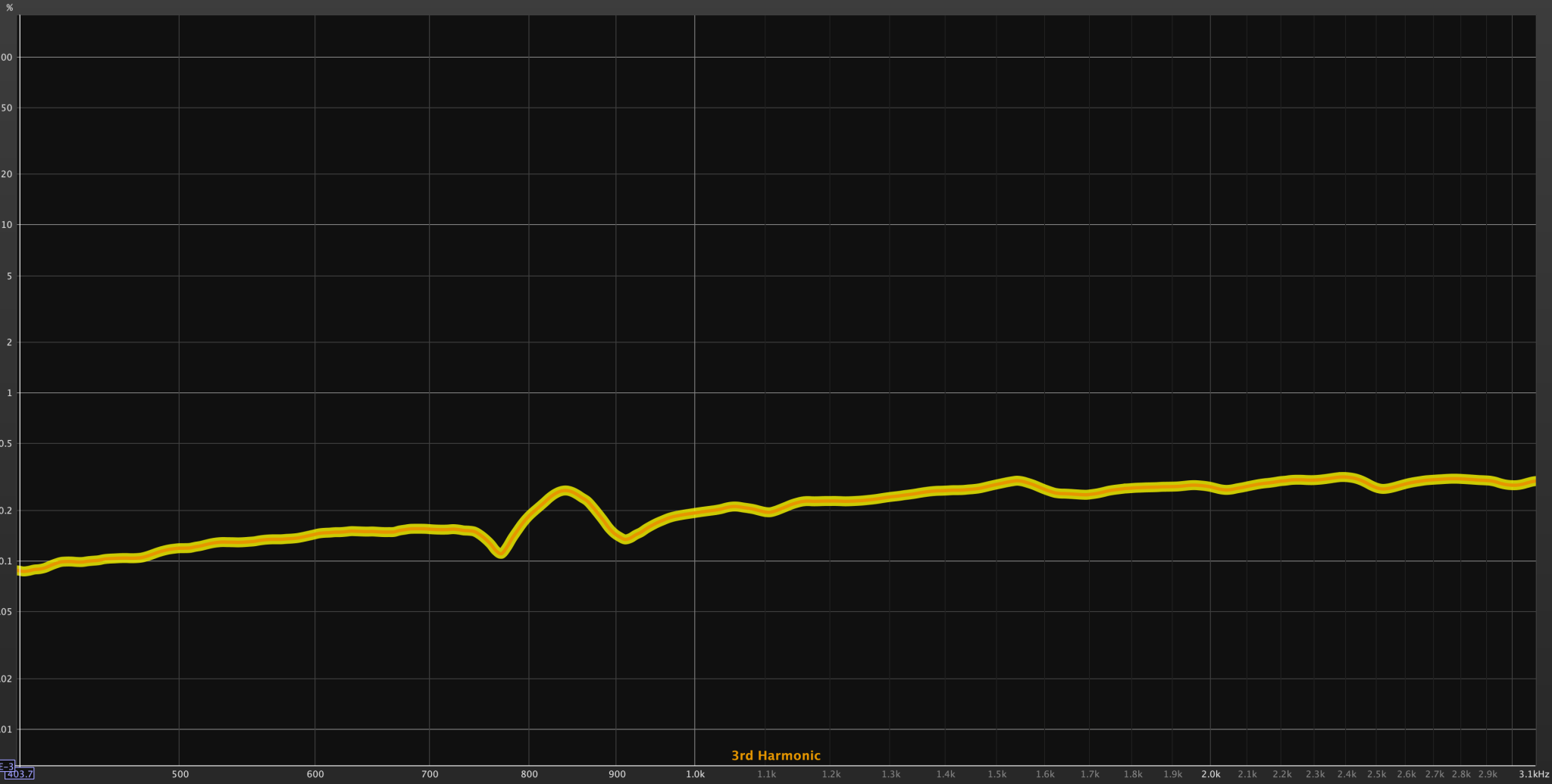

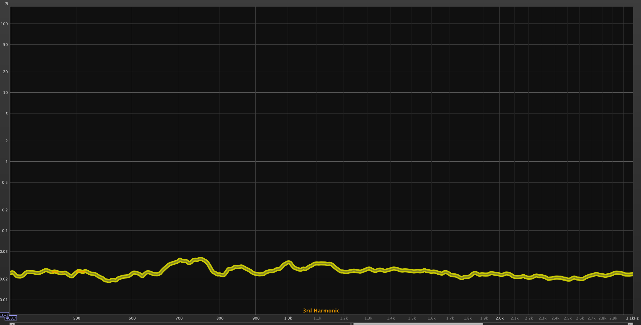

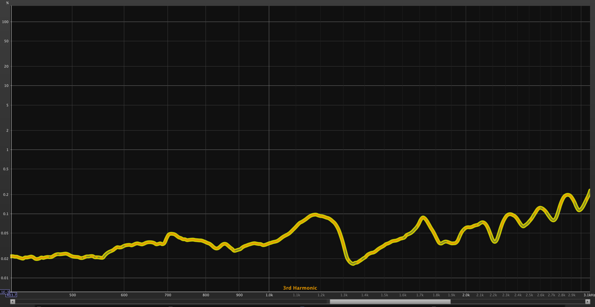

Midrange band (400-3000Hz), 3rd armonic distortion comparison (1: beyma, 2: PHL, 3: 18 sound, 4: stage line). Free air, no EQ, no baffle, 90Db.
