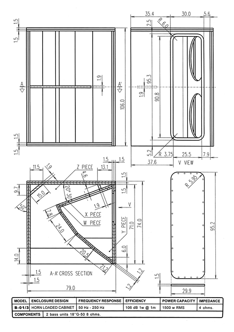

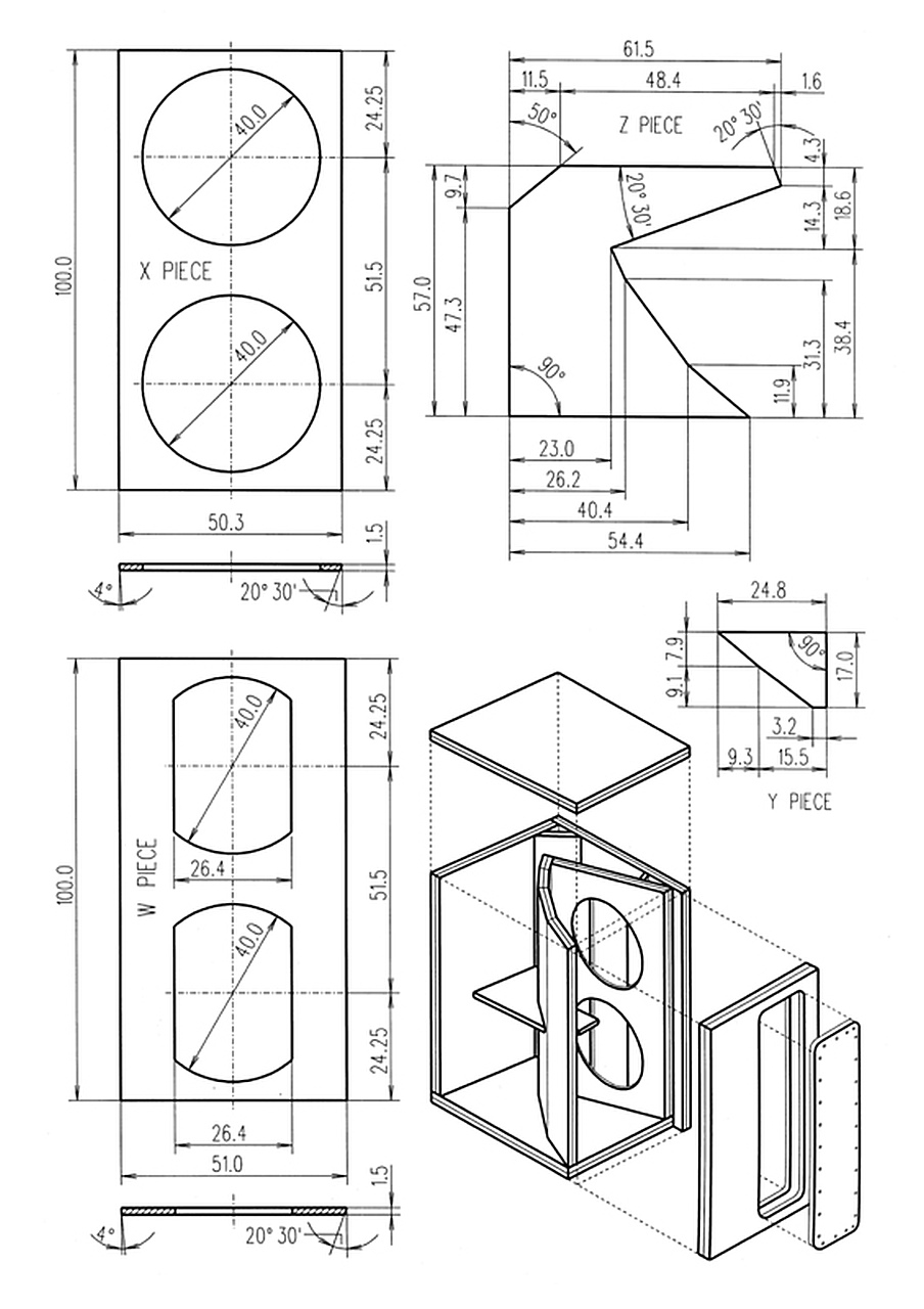

Here I do have an elder double 18" Horn for the 18G50, hope it helps you a bit!
Greets from Germany

Hi Bjorno
Your plan looks interesting. Any chance that you have a complete plan?:D

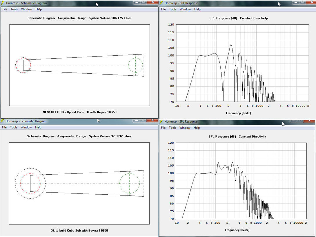

I have done various simms for different designs for 18G50. I have build 186 horns for stack systems that has been optimised for the 18G50 and SD18 p-audio.
Will play around with your simms.
Regards
Henk
