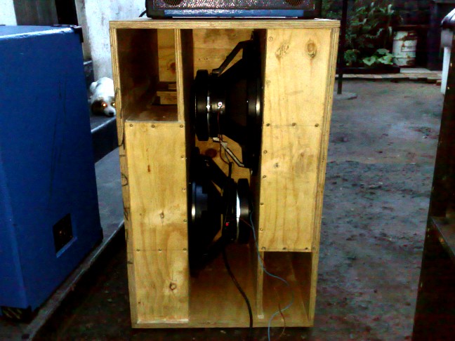

The Beyma 18 G50 can be used in Reflex or Folded Horns. I believe Beyma promoted the 18 G 50 for Folded Horns. It is a very versatile driver and efficient. However that design you made is not the best method to take full advantage of that driver.
Go to Beyma and download the TS Parameters. It will be in their discontinued section.
hzwart said:
"...I know they are not suited for TL or Manifold designs but would prefer to use them in these applications..."
Sorry,
forgot to say, you may very well be able to use the "18G50" for a "IB Manifold" application. The thing is that in an infinite baffle (home theater), you'll need to be aware of the "mechanical limitations" (mech lim) imposed regarding this particular alignment. Typically speaking, drivers operating in an enclosed environment, have a degree of support, as the air in the enclosure assists in keeping the cone/voicecoil assm from traveling too far in one direction or the other.
In an IB application (free air), you must exercise good judgement, as to how much power can "safely" be applied; perhaps through the implementation of an electronic "high pass" (ultrasonic) filter or a "signal compressor", limiting the spikes in the program material or music. As far as the TL alignment, someone else here (I'm sure) will be able to help you with that as this is a bit more complicated, to which I have no (zero) insight. Best to you!

The Manifold shown is inefficient for PA. Thats why EV stop making that design decades ago. He is better off using Folded Horns as the Beyma 18 G 50 meets the requirements to perform in a Folded Horn.

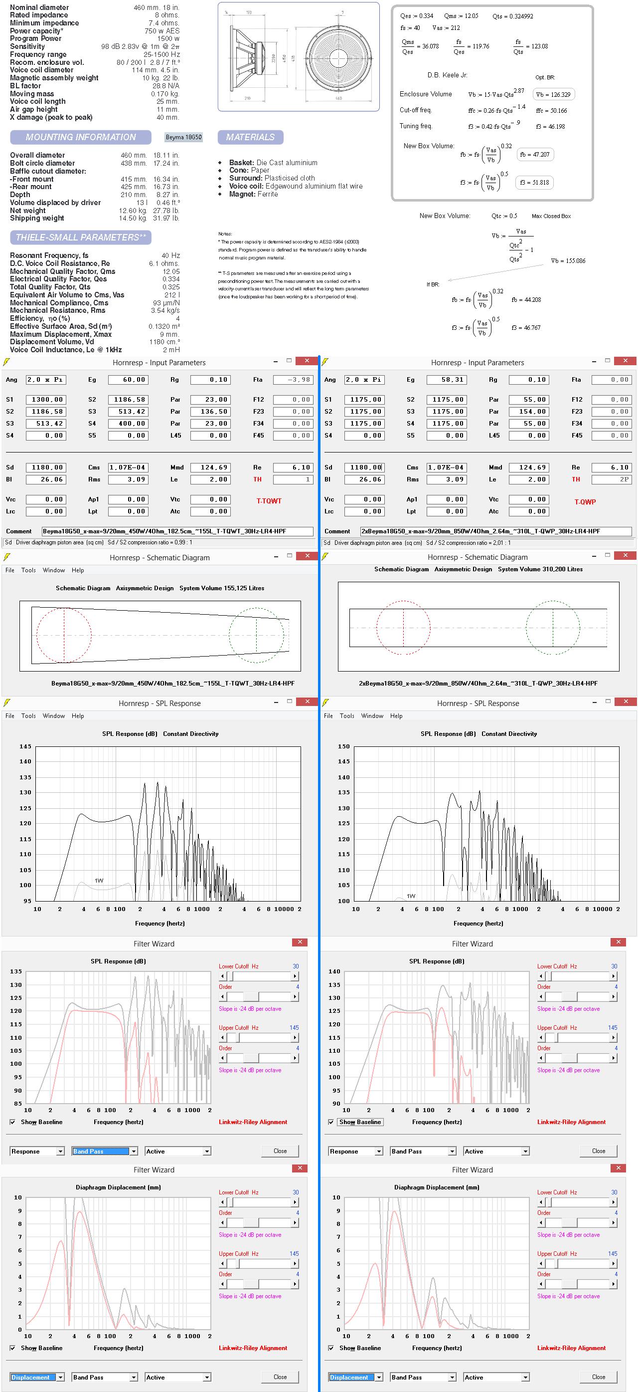

Thank you for the reply's. Unfortunately, I have these drivers and would like to use them in an optimum enclosure to get the best out of them. 😀
I have plotted them in TL's and Horns as per EPA's sim. But what is the optimum enclosure that I can still handle with the response I want?😕
Due to the 18G50 limited power capability, I have to use them in one stack to optimise the output and keep the drivers within the limited xmax. Hence my need to look for the optimum enclosure.
Well, this is maybe to much to ask for seeing that it is always a compromise between low, small and louder?
A reflex will not do it. So can it be a Horn, TL or manifold?
The reason why I require a response from 34Hz is that I can use one enclosure per side for small venues and still get a decent sound of high quality.
Four horns arrayed in a "Block" configuration will give the highest levels per watt. Stacking the horns increases mouth size, raising the efficiency, and lowering the f3. The bass reflex alignment is next, as far as output per watt, and will likely far exceed in low frequency extension, especially when "corner loading" is implemented.
Four of these drivers will permit 3,000w RMS/6,000w program! With 9mm xmax each, you should never have a problem, as long as you use your head and watch that your amp's "clip indicator" lights don't stay on; occasional blinking should be okay.
"...So can it be a Horn, TL or manifold?"
The TL's and the manifolds are too inefficient to consider for professional, high output (130db+) use, but may do very well in a much more "personal" environment" e.g., backyard bar-B-Q, Tailgate parties, small banquet's...
Hope that helps... "I'm trying to stay out of trouble" 😀

I hate to give you the bad news but, using one horn per side is not going to give no where near 34 Hz. I think it is time for you to punch in the TS Parameters of the Beyma 18 G50 in Horn Response and face the harsh reality.
