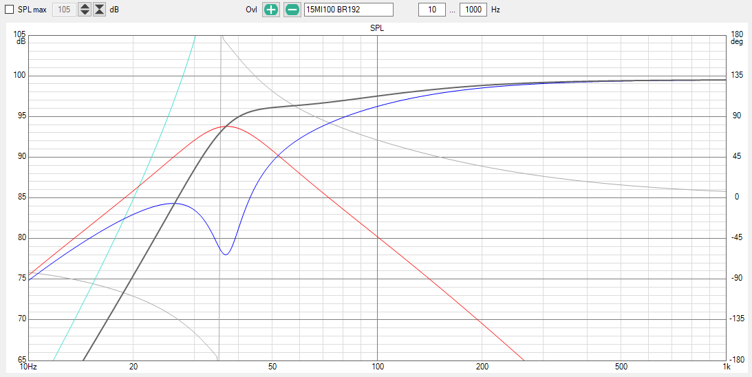

I am building a system using Beyma 15MI100 (and some other components).
The pdf datasheet is showing VAS = 166liters and fs = 48Hz.
Loudspeakerdatabase.com is showing 264 litres / 37Hz.
Who is right? Can we trust loudspeakerdatabase.com in any way? What about their built-in "simulate this driver in a closed box" online feature (as I am going to use it in a closed box ~93liters)? Is loudspeakerdatabase any good site?
Also, in what way do the stock TSP parameters change, if the 15" has been used already ~200h at medium to high power in a BR cabinet?

I'd trust the spec directly from the manufacturer but have you run simulations with both sets of specs? They may or may not produce much different results, if they are a lot different then one of them is probably wrong. But that said for a sealed midbass where you don't really care about the sub 100hz response there will be a wide range of enclosure sizes that essentially deliver the same results so go with the smallest cab you can get away with.

Not true: The enclosure is done. 93 liters. Built in the 90s. I care about the sub 100Hz since I want a VERY gentle filter (6dB) and almost no group delay. Goal is to have the 18 and 15s overlapping IN PHASE over some range. I am not going for highest SPL, so that is why I can use the 15 below 100Hz in closed box. Anyway - that is system discussion for later on, not what datasheet is right....

the parameter that varies over time is the suspension stiffness. fs is resulting together with the moving mass, Vas is resulting together with cone area. so try to vary the stiffness,let the system calculate the resulting fs and Vas and other parameters that are linked. the end result may not be so catastrophic.

I said 2 x 18NLW9400 CB 152l plus 2 x 15MI100 CB 91l (acoustical crossover target is around 80 - 100Hz, still not decided, currently calculating the transfer functions with MathCAD.
2 x 15MI100 CB 91l
91 liter will be too much even for both of them, not saying for each.
This is a high-performance midband driver, like 15MB650, doesn't spent it's midband potential for providing bass notes.
Say, i'ld try it in something order of 20-25 liters vented box tuned to 85 Hz and with active Xover 12 db/oct at same 85 Hz.
Doing so will allow you to pick mostly all of the power at the 200 Hz range, mighty and very fast kick, order of 103-105 dB/wt at the axis. Well-matched with something like 3"-4" coil compression driver. See for example RCF ART 735 or 745 models.
Again, both or each?
My suggestion ~80 liter per speaker, box tuned to ~40 Hz, active XO at 40 Hz 2nd order.
Build both, measure response and then align phase, doesn't think about frequency it will be choosed by phase matching procedure.
BesPav, I know the usual design rules. But here I am not shooting for SPL, but for 20Hz and as low group delay / phase distortion as possible. That is a completely different design approach, especially since the system IS already a ported PA system and I am now designing the "plugged ports" mode. I am now sitting in front of a MAthCAD sheet that tells me I will not even reach 110dB, if going for a 3dB rolloff of 20Hz undistorted, using both 18"s. As you can see in the opening post, I put this under PA, since the components are PA, not the application. It is more like home listening / home cinema. If you are really serious going for 20Hz, plus avoiding phase distortion, you must use shallow soft filters (or: in my case a MAthCAD trick of pure magic that will be presented soon in another thread, latest next week), you must not follow ANY established PA rule. And you are going to sacrifice MANY dB on the way to get there.
