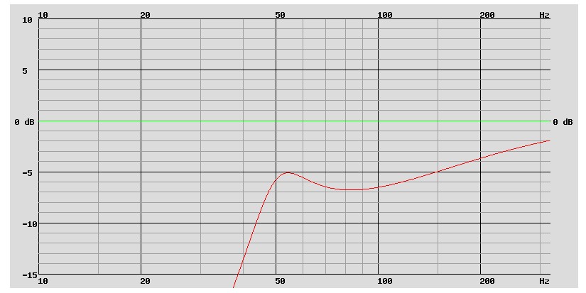

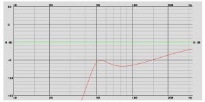

...Maibe a 60l bass reflex, with the ports on the backside, would be a good solution ?
For all that was said, that's not a good solution. (look @graph below)

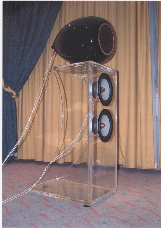

Use the Beyma horn (or the Autotech Polish horn) for the TPL, crossover at 1.8KHz or there abouts, any lower and it sounds a bit stressed.
This sadly eliminates a 12 inch mid bass as it will beam too much up high.
You could use an 8 inch (PHL are great) or at the most a 10 inch (Volt or PHL) and then crossover to one or two Beyma bass driver(s)?
As an off the wall ( !) suggestion.... If you really want to stick to a two way with the Beyma 12 inch, how about using four 12 inch drivers Beyma's per speaker, wired for 8 Ohms will give you a 6dB gain in sensitivity, this will be a great match with the horn loaded TPL.
You could have a two piece cabinet, three twelve incher's in the lower section, approx 1 meter high. Then another cabinet with the TPL horn and the last 12 incher above it.
To load the bass / mid...I love open baffle,( see attached pic) if you have the space behind the speakers.
