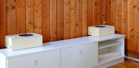

Might be that my googling fingers are out of tune, but I didn't manage to find anything recommended for the 12CX.
Interesting they recommend aiming the drivers towards the ceiling up to 20 degrees.
The flooder approach is also very nice:
Another Ikea killin' woodworker joke? Flood me to the moon...😱
